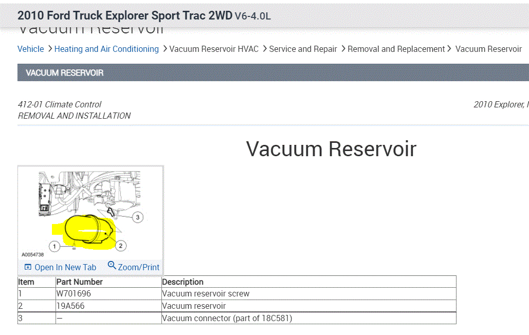

The idea that you can't change airflow directions is likely related to the mode door actuator. It is controlled by the engine vacuum which is provided via a vacuum hose between the engine to the vacuum reservoir under the right side of the dash and then through the controller. There are three different actuators, floor, defrost, and panel.
Since you can't change anything, I suspect it is a vacuum issue. It's unlikely that all three went bad at once.
Locate the reservoir and check for engine vacuum at the hoses with the engine running. If there is no engine vacuum, trace the hose to where it goes through the firewall to the engine.
Let me know what you find.
See pic below.

The reservoir should be in the vehicle, under the right side of the dash. Also, I feel confident they will have the vacuum hose needed. It is a very common item.
