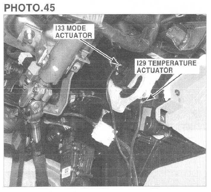

Here are directions specific to your vehicle for replacement:
REPLACEMENT
1. Disconnect the negative (-) battery terminal.
2. Remove the lower crush panel and the side cover.
3. Disconnect the connector of mode actuator after removing the air duct.

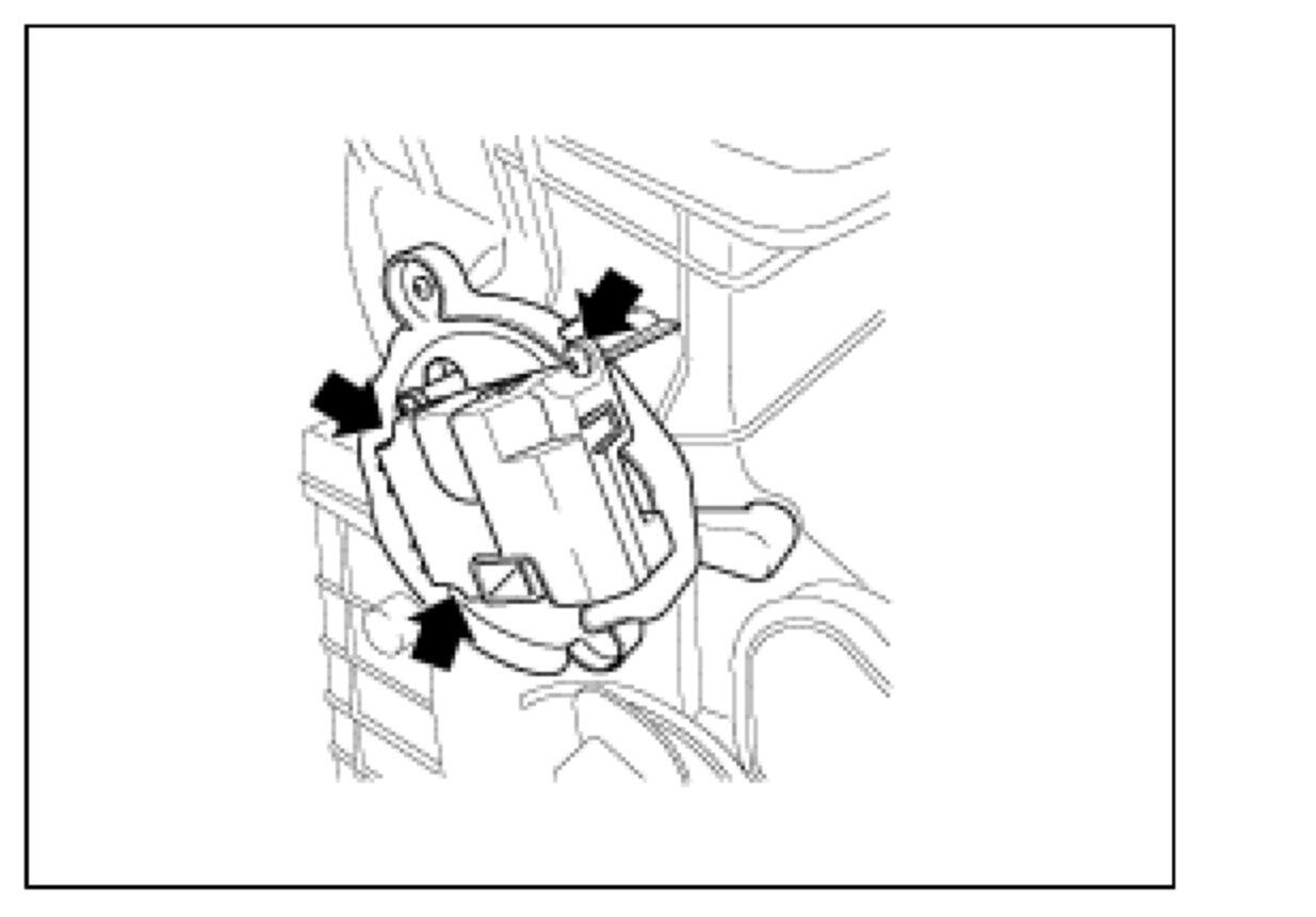

4. Loosen the mounting screw and then remove the mode actuator.
5. Install in the reverse order of removal.
The first picture correlates with these directions. The second picture is of the mode actuator.

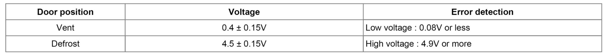

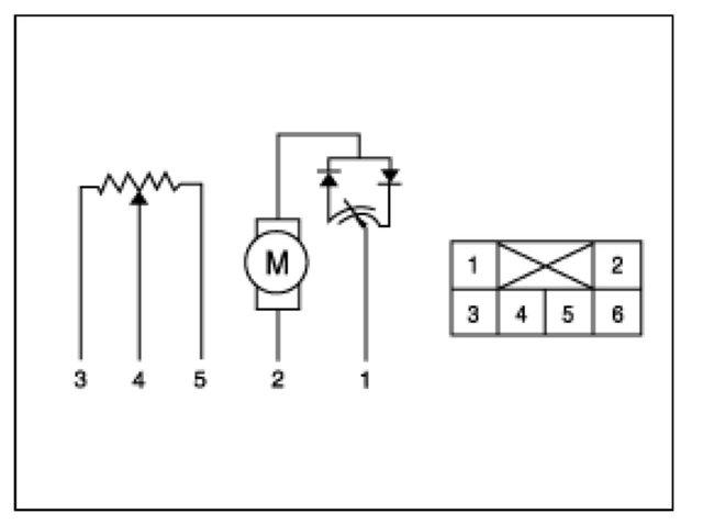

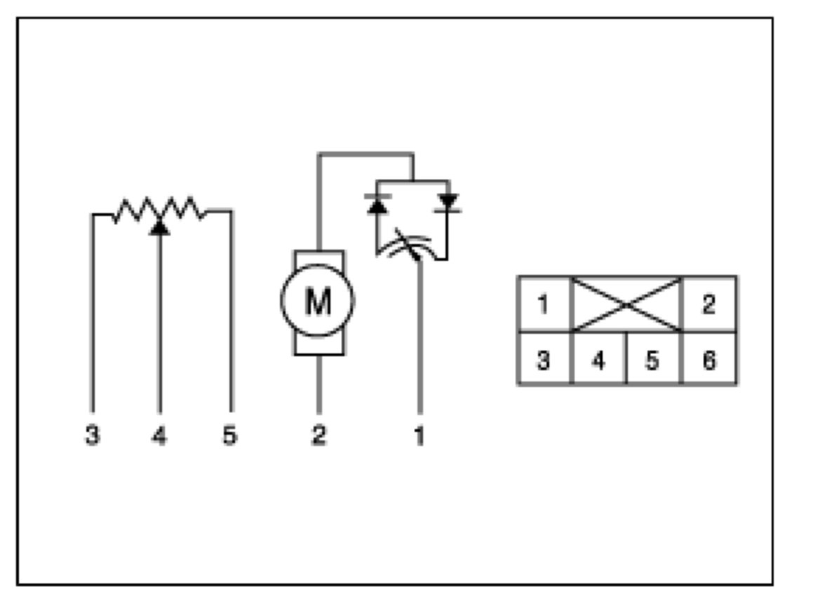

If you are good with electronics, here is the test procedure for checking it. Pictures 3 and 4 correlate with testing.
___________________________________________
MODE CONTROL ACTUATOR
INSPECTION
1. Verify that the mode actuator operates to the vent position when connecting 12 V to the terminal I and grounding terminal 2.
2. Verify that the mode actuator operates to the defrost position when connecting in the reverse.
3. Check the voltage between terminals 3 and 4.
It will feed back current position of actuator to controls.
