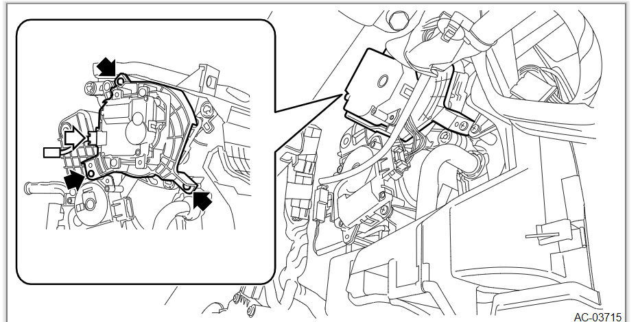

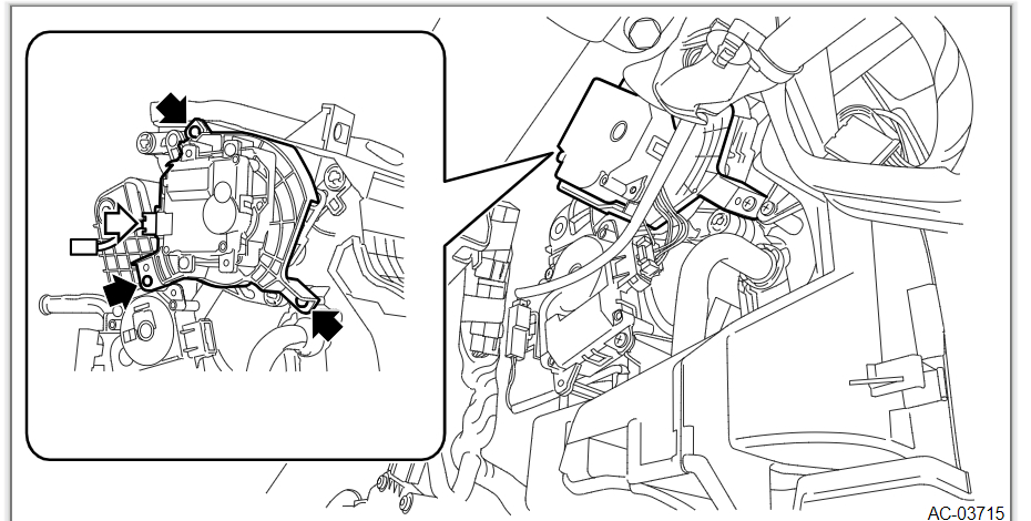

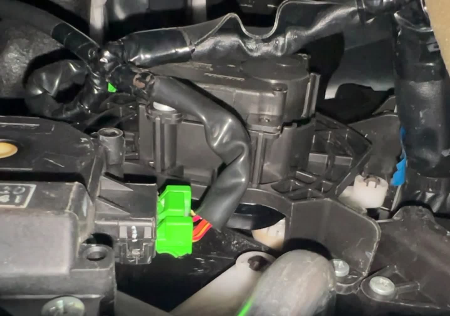

The BCM isn't causing this to happen. Interestingly, the blend air door actuator is responsible for the air temperature entering the vehicle. In this case, air flow changing direction, it sounds like the mode door actuator is failing.
I attached a picture of the mode door actuator. What we need to do is determine if that is where the clicking is coming from. Usually, the small plastic gear in the actuators strip and you hear the noise, and the component fails to operate properly.
See pic below.
Jun 26, 2024 at 2:25 PM

Thank you for the reply. We may have a mix-up in terms. The mode door actuator was replaced. I have seen the part being referred to as blend door actuator so my apologies for any confusion.
Is it possible the mode door actuator is bad, even though I replaced it less than a year ago?

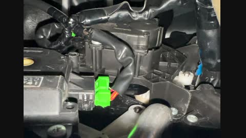

I am attaching a video. You can see the mode motor moving back and forth.
Jun 27, 2024 at 11:11 AM
  • 110,248 POSTS
Unless you are changing the airflow direction very quickly, it shouldn't be doing that. And yes, the actuator may have simply failed again.
No problem with the actuator terms. In general, there are too many terms to remember. LOL My favorite is trying to keep up with all the different acronyms. LOL
Let me know if the actuator was doing that without you requesting change.

It does that without any input change from the panel. As we drive, we can hear the motor moving back and forth under the dash.
The motor is supposed to be covered by a warranty. I’m wondering now, if I replace the motor again and it fails, what is happening to shut off the motor.

I would replace it. Unless there is excessive strain on the motor, it is the part itself that is failing. They are making things cheaper and cheaper.
Actually, remove it, get one under warranty, plug it into the wiring, and see if it does the same thing. If it does, then we need to start tracing the wiring to the controller or scanning to see if there are any faults related to the HVAC system. If it doesn't, it's the part and the new one will likely fail as well.
Let me know.,

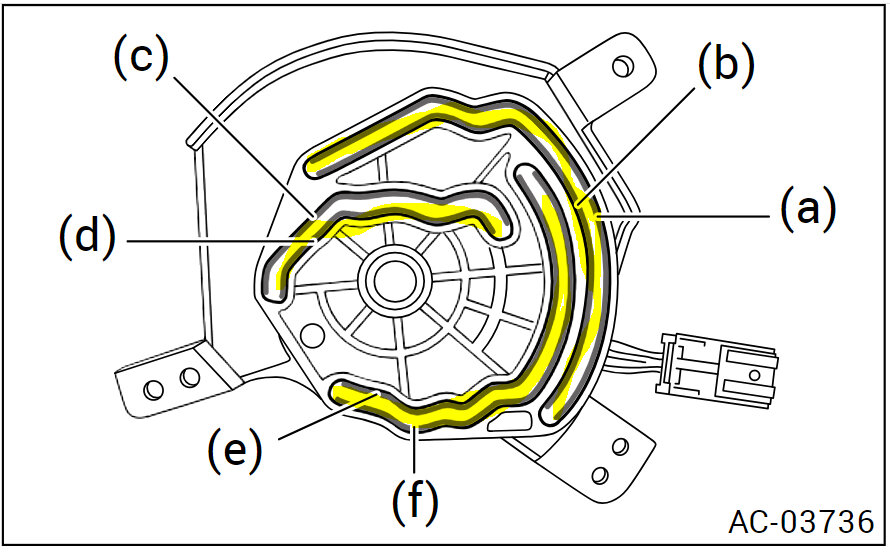

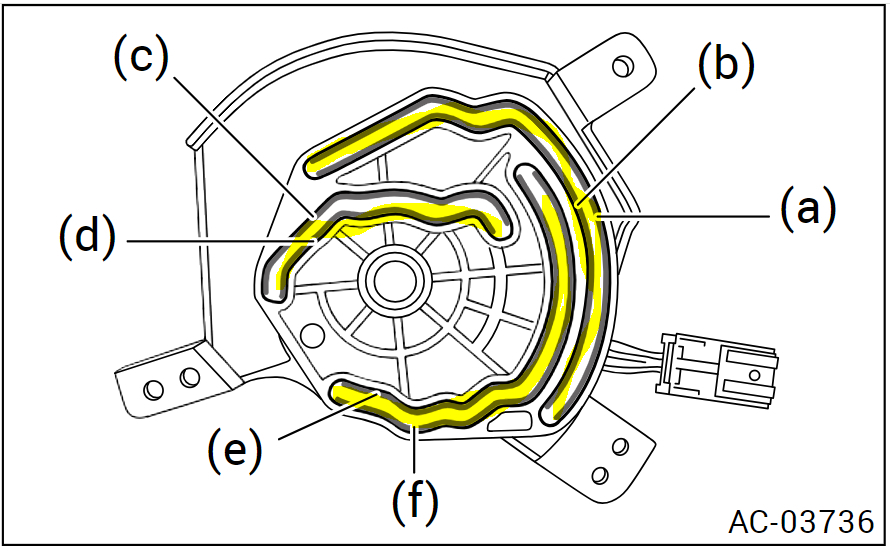

I can only think that some grease may have been needed on the rail plate. It could be hanging up a bit if you didn't do this. Although I do this, it isn't always required.
I attached a pic below and highlighted the areas I'm referring to.
See pic below.
Aug 29, 2024 at 12:15 PM

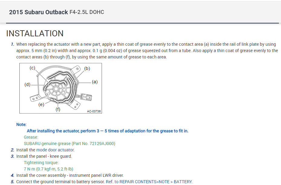

I added a dab or two or grease when it was reinstalled. It was such a pain to get in place are there any reference marks I could use. Any recommendations which position the doors should be in when I install the wheel?
Aug 29, 2024 at 1:25 PM
  • 110,248 POSTS
The positioning shouldn't matter. I attached the installation directions below for you to review. There is nothing indicated for alignment or relearn. However, they do stress the grease. Actually, it indicates adding the grease and operating the actuator several times prior to installation to evenly spread the grease.
Take a look.
See pic below.
