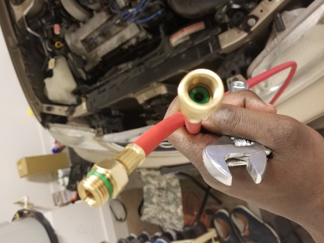

Hi thank you for the sound advice and prompt response. I went and got a pressure gauge manifold from AutoZone and attempted to pull vacuum. When I turned the vacuum pump on and opened the low pressure gauge valve, it only sat at 5 in Hg after forty five minutes. I tried to check, adjust, and tighten the yellow hose and still got nothing more than the 5 in Hg. I noticed the yellow valve o-rings were not in good condition; one had some tears. Even with securing the hose tight, would this be a contributor to a leak in the system when the pump is turned on? I checked the hi and low pressures without the pump and verified both are at zero.

Hi again. Are you referring to the o-rings under the caps? If that is the case, they are there to help prevent leakage. The actual valve should not leak, but yes it is possible. If you are getting 0 psi readings on both the high and low sides, the system is empty and needs recharged.
If it is possible, could you send me a picture of the o-rings you are referring to so I can confirm what I am telling you?

I went and got another pressure manifold and was able to vacuum out the ac and it held at 26 in Hg for over an hour. When I charged the refrigerant I made it up to 55 psi lol and about 350 hi. I am in Phoenix and it was about 108 degrees today. The compressor finally kicked in and it took in the refrigerant. But the car still does not blow cold air. It blows cool but not cold and the air coming out of the vent is weak. I have tried replacing the blower motor resistor before and that did not work. I am at a loss. It is properly charged but still no cold air .
