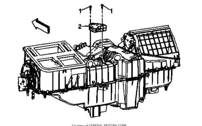

I have a dual climate control system. The drivers side is extremely hot all the time even when switched to cold. the passenger side works properly. I was told maybe a actuator behind the heater box. Any help or advice with this?
Oct 28, 2017 at 2:01 PM (Merged)
HMAC300
  • 48,601 POSTS
try removing HVAC fuse inside truck with key on for sixty seconds then reinstall it may reset the actuator otherwise it is probably bad. in order to remove it if you have to you have to remove air bag on pass side which this should be left to a mechanic. See picture.
