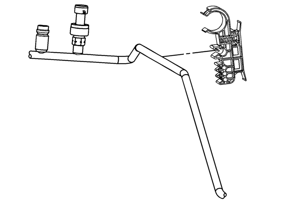

Okay, is the accumulator part of the suction hose and cannot be replaced separately? Also, I don't see a receiver/dryer or is it inside the new condenser? Lastly, the A/C compressor hose has a screen; do I need to replace that screen as well before I flush the hose?
Mar 17, 2021 at 12:27 AM
That is correct.
Mar 17, 2021 at 12:32 AM
That is correct.
JIMB2020
  • 106 POSTS

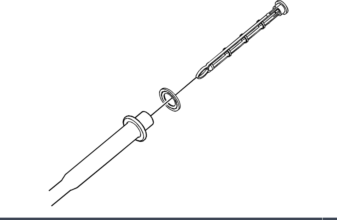

I ordered a new suction line, but I can't seem to find the A/C compressor suction screen. I know I saw a procedure to remove it and reinstall it.
Mar 17, 2021 at 12:42 AM
I attached the procedure for you for the replacement below.
AIR CONDITIONING (A/C) REFRIGERANT FILTER REPLACEMENT
TOOLS REQUIRED
J 39400-A Halogen Leak Detector
REMOVAL PROCEDURE
1. Recover the refrigerant. Refer to Refrigerant Recovery and Recharging.
2. Remove the surge tank from the surge tank bracket.
3. Remove the suction hose and liquid line nut from the thermal expansion valve (TXV).
4. Remove the suction hose and liquid line from the TXV.
5. Remove the line clip from the dash.
6. Remove the refrigerant filter from the line.
7. Remove and discard the sealing washers.
IMPORTANT: Cap all A/C components immediately to prevent system contamination.
Mar 17, 2021 at 5:26 AM

I did find the procedure for replacing the suction screen (but I cannot find a new screen to buy unless it can be cleaned and reinstalled. can you find out?). It confused me at first because the suction hose connects to the compressor hose (half-way en-route to the compressor), GM calls it suction screen (even though it is located at the compressor entrance inside the compressor line part of the whole line) while the one you outline in the procedure (above in your last message) is for the liquid line refrigerant filter (also known as TXV screen). This suction screen on the other hand (which requires a threading tool) was the one I could not find. I could not even pull up anything that talks about it. If I cannot find a seller for it, I am wondering if it can be removed and cleaned and replaced after flushing the compressor line. I know it may not be a big deal but this screen seems to have an important function in that it stops solid particles form entering the compressor.
Thanks again Roy for your help.
James
Mar 17, 2021 at 8:11 AM
Yes, I clean it with brake kleen. It is a screen that collects debris and it can be cleaned.

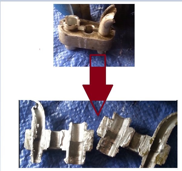

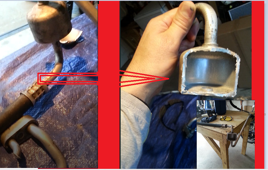

Hi Roy,
I had two sets of G6 GTP Refrigerant lines (they are both from a 2006 3.9L). I attached images below. After our last messages, I did some reading on how the accumulator does its work. To make the story short, I decided to find out for myself. I found nothing inside! nothing inside the accumulator (no desiccant bags, no tubes and no oil separation mechanism) and nothing inside the compressor tube (no screen to protect the compressor). That means, liquid could over flow and damage the compressor and the compressor could also be damaged because there is no suction screen. Is this an original GM design or an aftermarket line and accumulator? I looked at three GM 2006 G6 GTP lines; they are all the same. Should I be looking into adding an in-line accumulator instead of this empty container that is not even vertically deep? I really don't know much about the behavior of the refrigerant, but many articles state that the refrigerant goes into the accumulator with liquid in the vapor. What do you think?
Mar 18, 2021 at 8:24 AM
That is not the accumulator at all. That is for the pulses of the pressure when the system is working.
Your system does not have a accumulator as the other systems. It has that filter and that is all. I would not install anything that is not factory at all.
