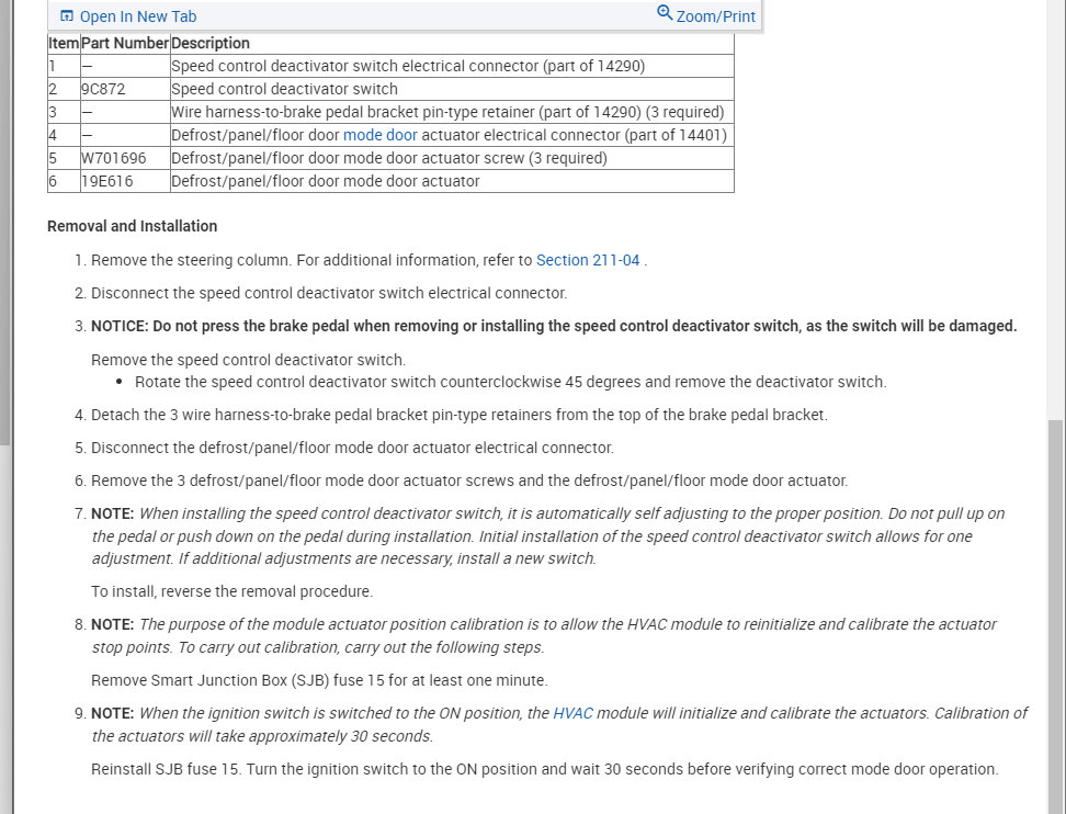

A/C working, getting hot and cold just air flow coming out of defrost vents or floor vents not front vents.
May 17, 2022 at 6:57 AM
If the A/C and heat both work, then this is most likely just an issue with the mode door.
Here is a guide that will help with talking about this:
https://www.2carpros.com/articles/air-vents-stay-in-the-defrost-position

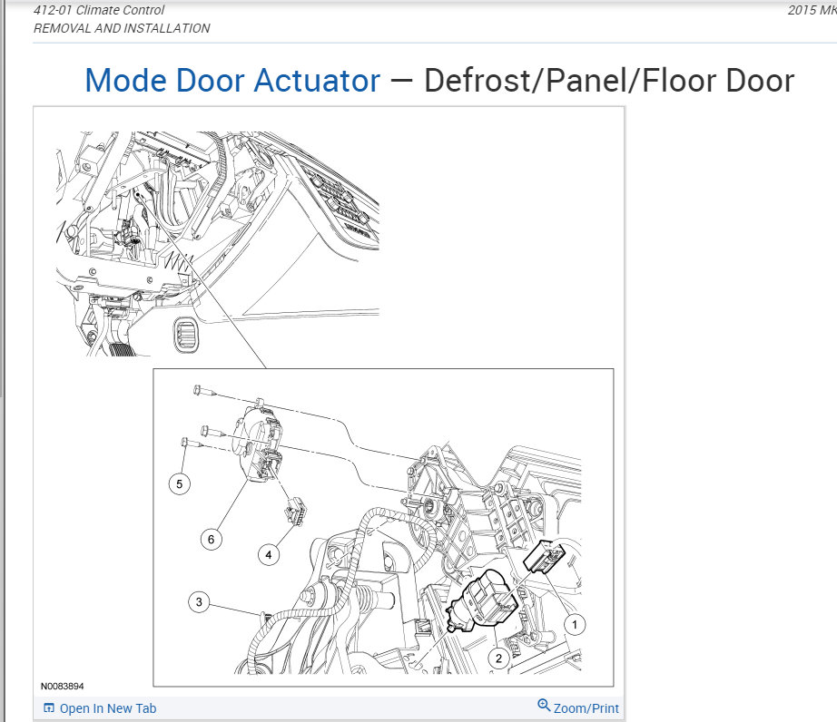

While there could be a couple things causing this, I am pretty confident to think that this is the actuator. So, let's change that out and I am attaching the instructions below on how to do this.
Please let me know what questions you have with this.
Thanks
