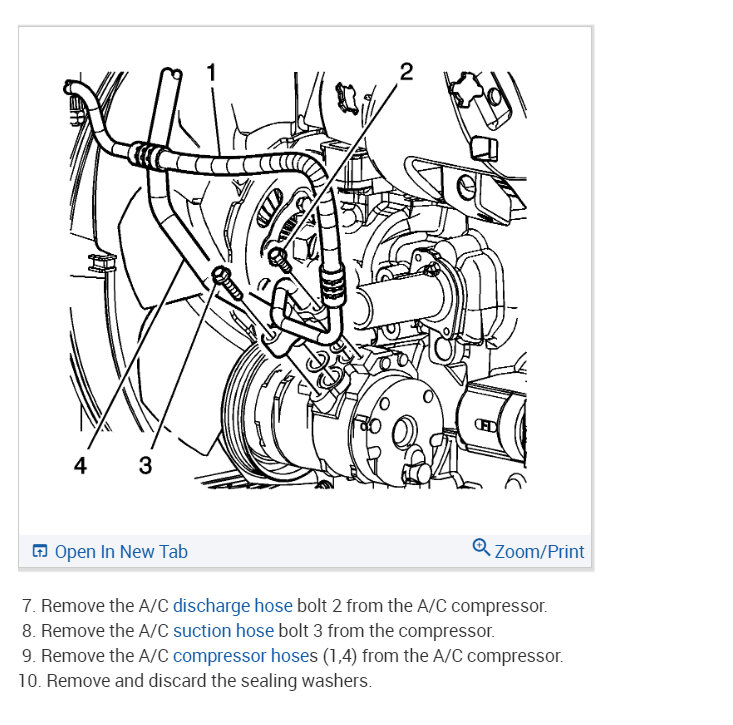

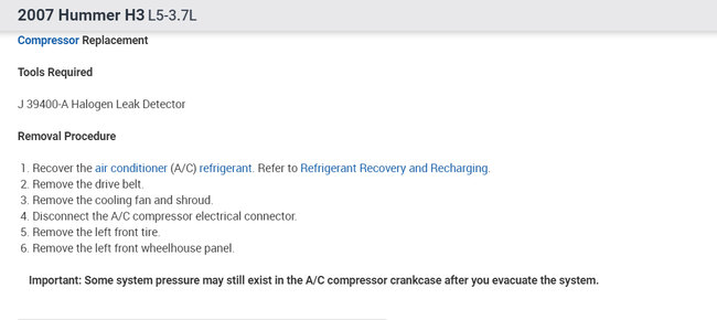

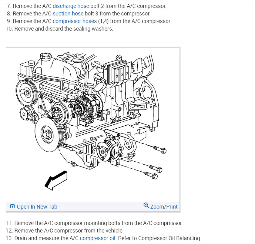

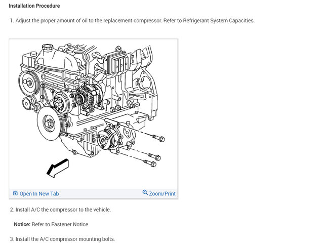

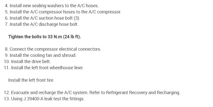

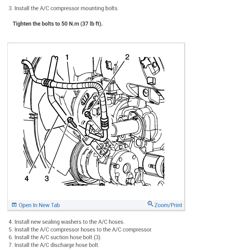

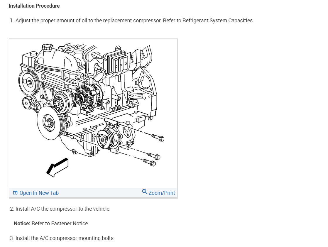

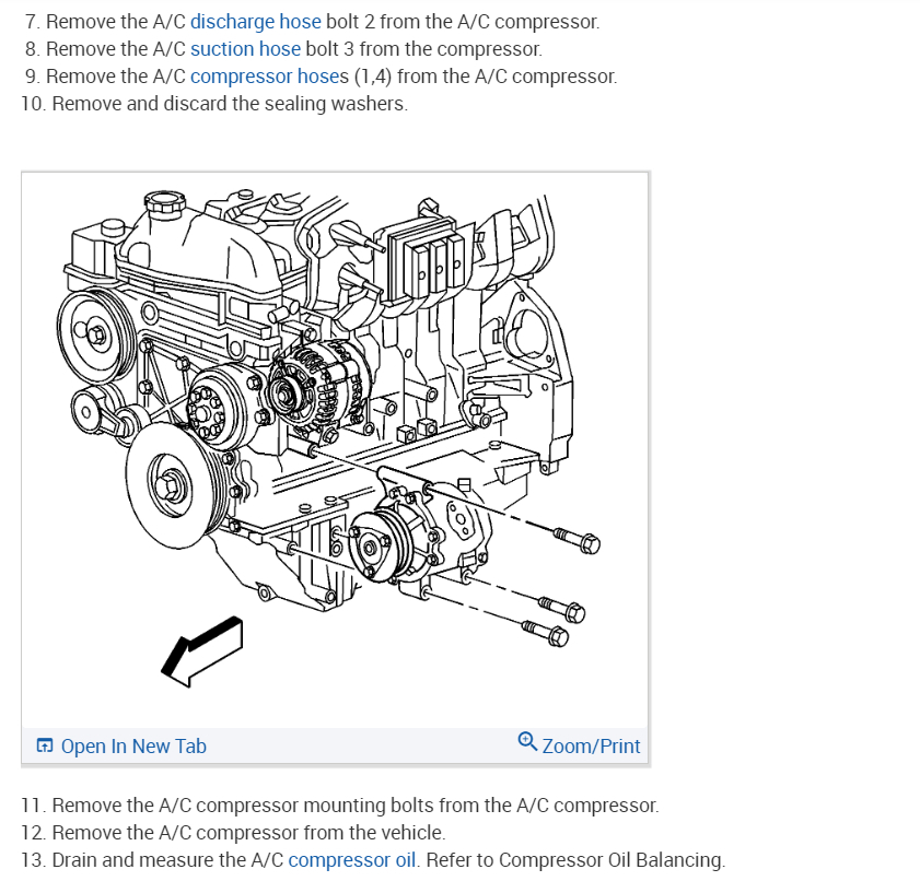

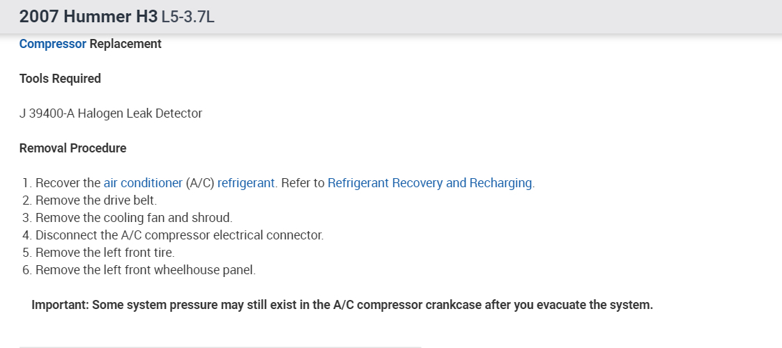

This could be a defective temperature blend door actuator, or the A/C compressor is going out. To be sure we can check the A/C compressor by observing the high and low side pressures.
This guide may help as well:
Here is how to replace the A/C compressor step by step with instructions in the images below for your car:
https://www.2carpros.com/articles/replace-air-conditioner-compressor
