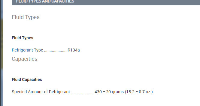

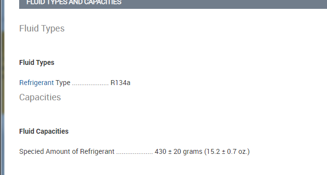

I just want to know which air conditioner gas is good?
Wednesday, June 29th, 2016 AT 3:41 AM

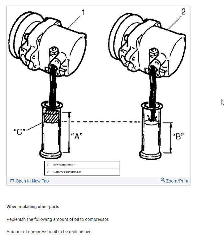

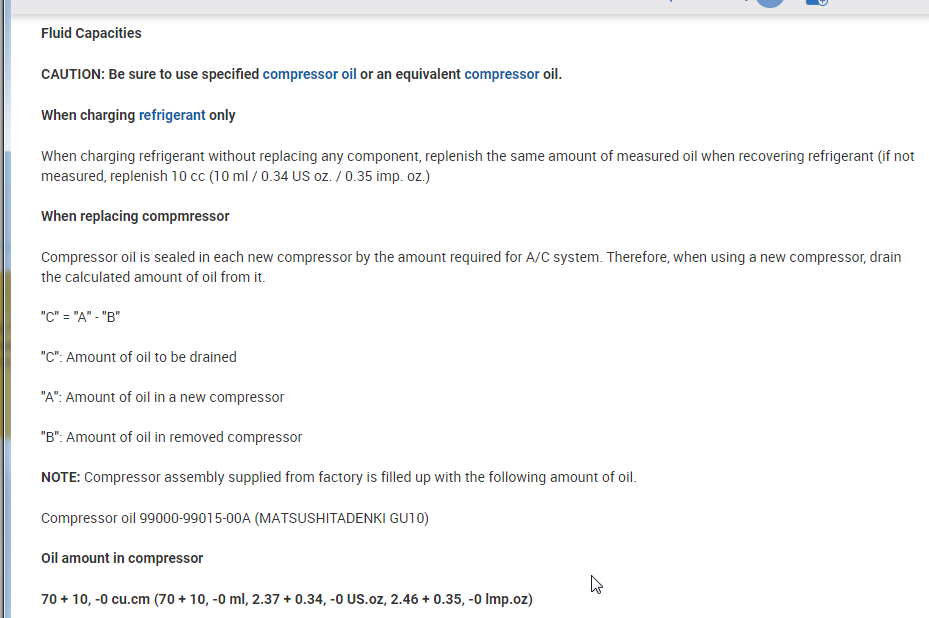

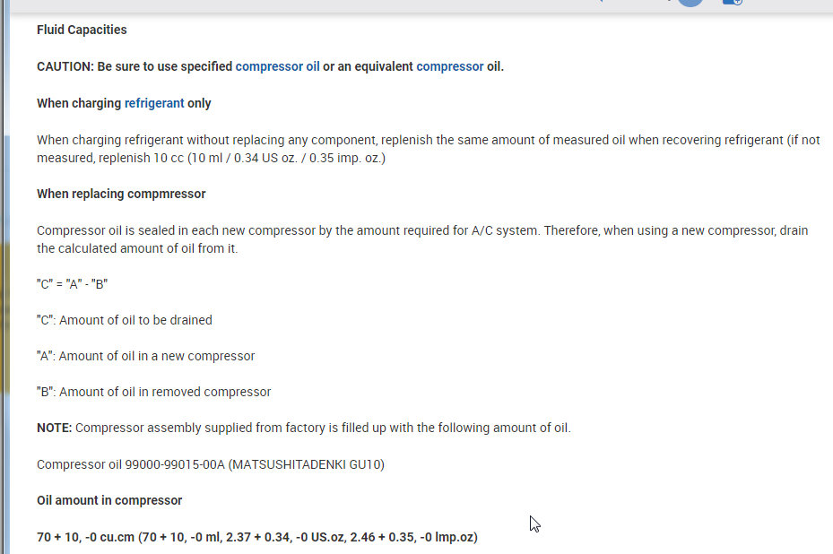

Unfortunately, we don't have a manual on your vehicle so we don't have all the specs but you are going to most likely need to use R134A Freon which is an industry standard for this model year.
Here are some guides that will help in general with A/C issues and how to recharge the system if you need that:
I am attaching below the spec of the USA version of your vehicle.
Let us know what questions you have. Thanks
