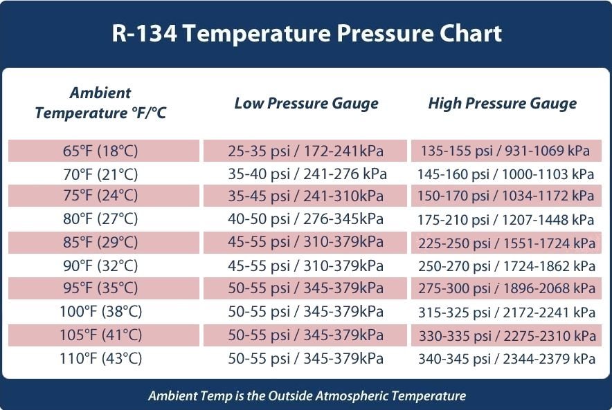

First start vehicle A/C fine as engine warms up A/C less cold. Checked pressure low side jumps to 140 should be 45. High side drops to 100, Should be 175 What could the problem be?
Aug 25, 2017 at 3:24 AM
STEVE W.
  • 15,390 POSTS
That is a sign of a bad compressor. The compressor is trying to work but it is leaking internally so you get increased pressure out the low side.
If the compressor has not ruined itself to the point it has pushed debris into the system just changing it out should fix the issue. If it has pushed debris into the system you will be changing a few parts and flushing everything to get the stuff out.
Keep us informed.
Aug 25, 2017 at 4:02 PM
H SPALDING
I thought it was bad compressor. Today changed compressor, accumulator and line with orifice. First time using vacuum pump and manifold gauges. pulled vacuum, it held, sticker calls for 22 oz. I believe I may have over charged based on the chart you provided. When i was done low pressure was 40-45 high pressure was 170 air temperature around 78-83. cabin temperature cool but not as cold as it should be. Compressor is now cycling as it should. Confirm low pressure is to high for the temperature. Thanks for you help!

Low of 40-45 should be close for 80 degrees. Make sure the radiator fan is on when you check the interior temperatures.
