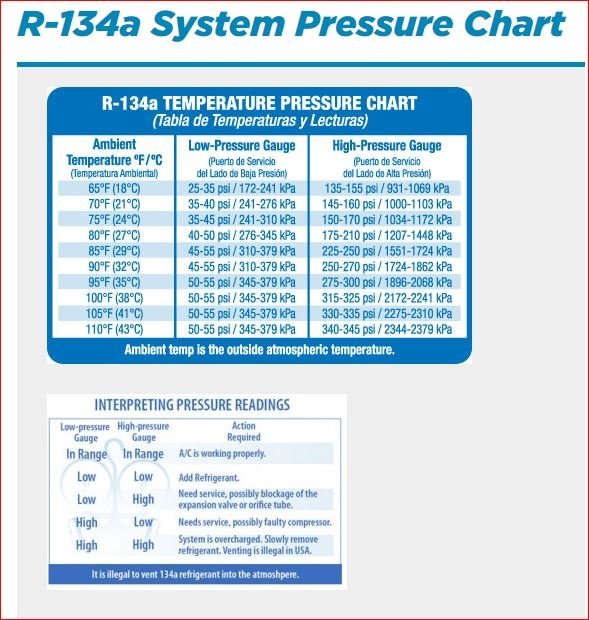

Most all Robinair machines have both gauges on them so they will definitely work. When you evacuated it, did it hold a vacuum for at least an hour? If not, you should be able to just check pressures as it sits, then evac it and hold a vacuum then recharge it again with the proper amount of refrigerant which appears to be 26 oz +/- 1.8 oz.
If you under charge this it will cause these types of issues. Here is a guide that will help with this:

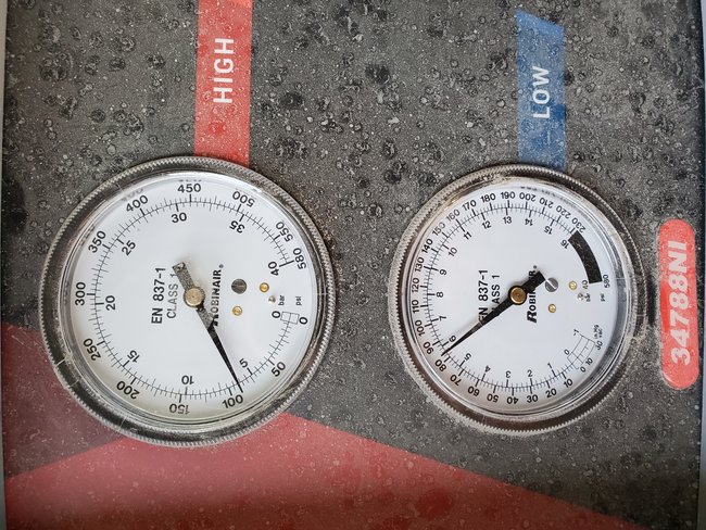

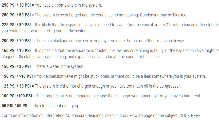

Finally got the pressure test done. I'm guessing I need a compressor.
Aug 19, 2020 at 6:25 PM
It sounds like it, but what were the actual pressures with the A/C turned on?
Aug 19, 2020 at 6:27 PM
RICKY76
  • 5 POSTS
The pic was taken with the A/C turned on full blast.
Aug 20, 2020 at 12:03 AM

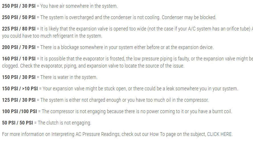

Okay. Yeah. Even pressure on both sides shows the compressor is not engaging. Take a look at the attachment. Basically you are looking at the 100/100 line.
Clearly if the compress "engages" it has power so at that point it needs to be replaced. Here is guide to help in case you need it but it looks pretty clear that would be the issue:
