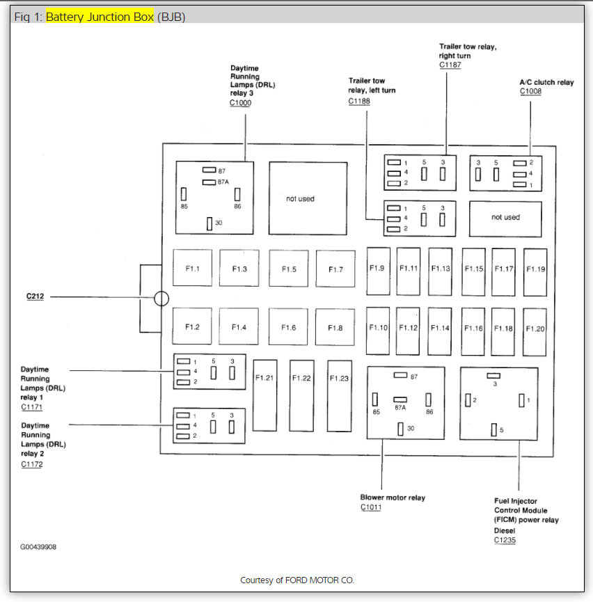

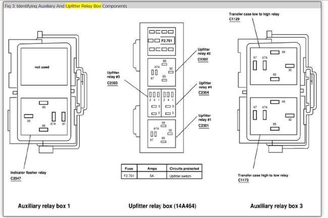

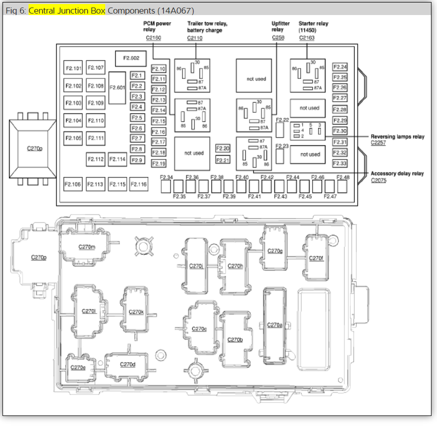

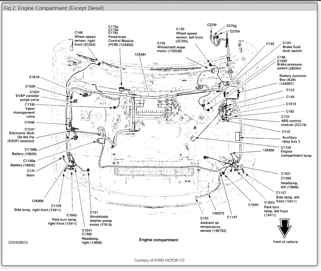

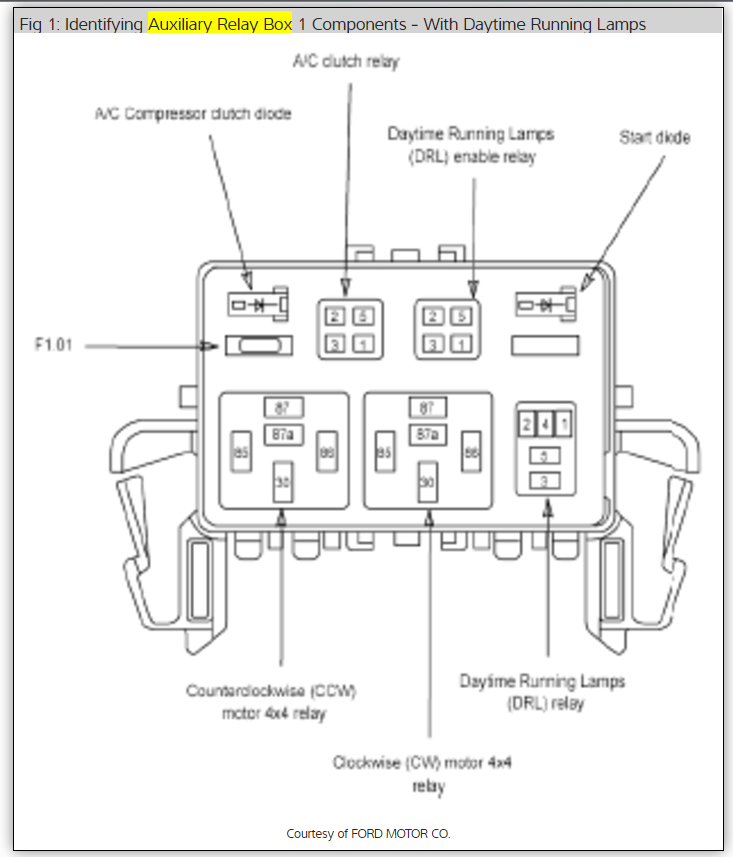

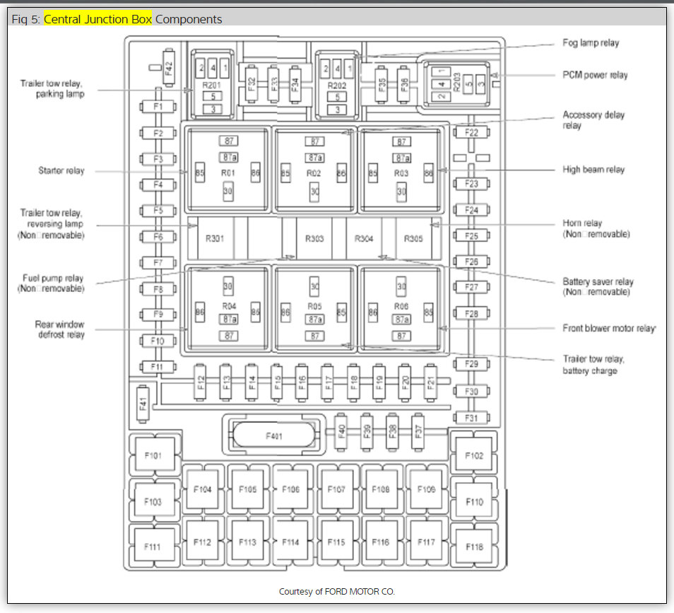

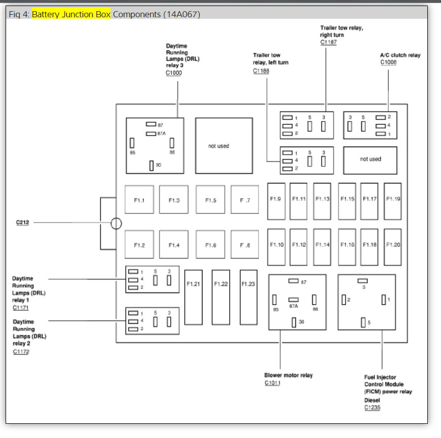

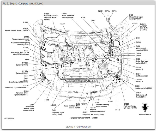

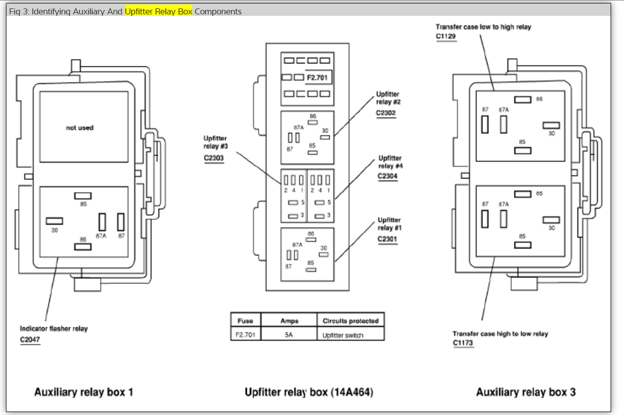

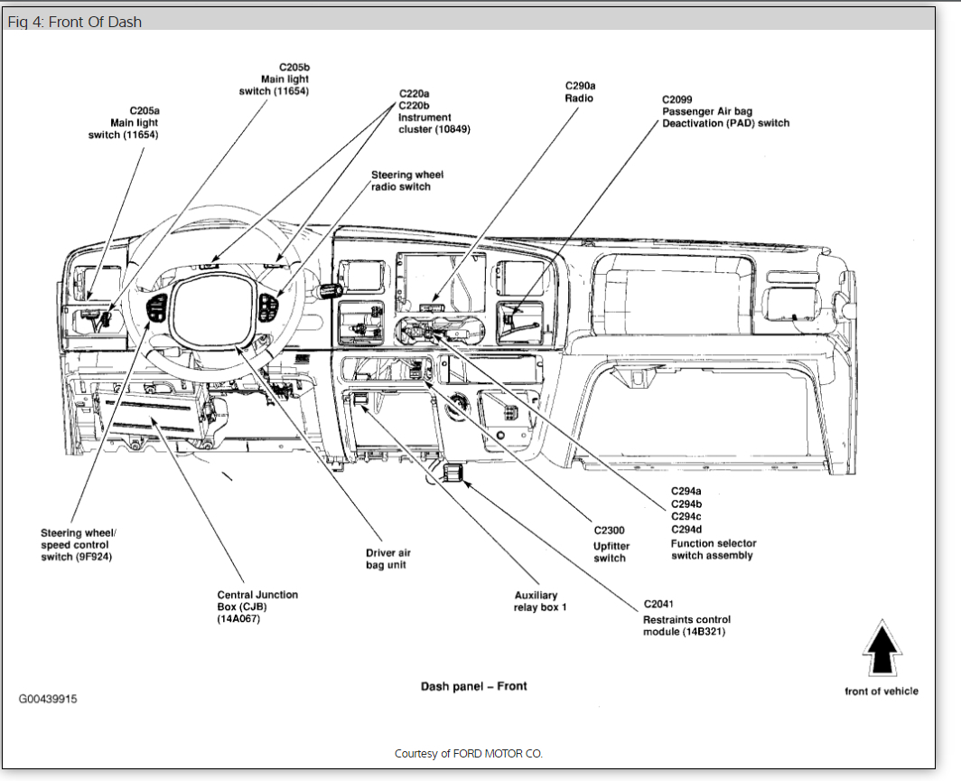

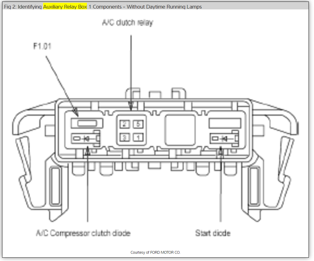

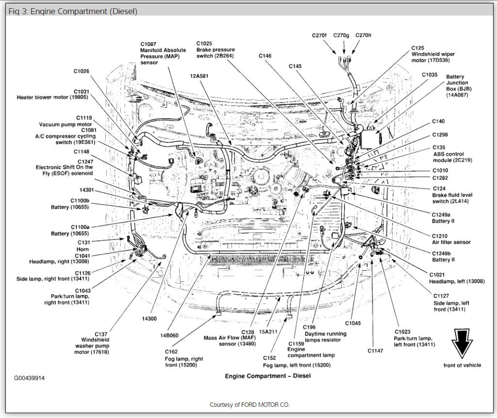

It sounds like you have enough pressure to turn the system on. I would start by checking the fuses and see if the compressor clutch is get power when the system is on also check the ac compressor relay.
Here are some guides and diagrams to help you get started:
https://www.2carpros.com/articles/how-to-use-a-test-light-circuit-tester';
and
and
and
Please run some tests and get back to us we are interested to see what it is.
