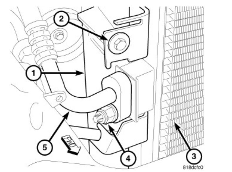

4. Remove the secondary retaining clip and using the proper A/C line disconnect tool (Special Tool Kit or equivalent), disconnect the A/C liquid line (1) from the condenser tube (2) See: Coupler HVAC > Removal and Replacement > Refrigerant Line Coupler - Removal.
imageZoom/Print
NOTE: Upper condenser retaining bracket and bolt shown. Lower retaining bracket and bolt similar.
5. Remove the grille See: Grille > Removal and Replacement > Grille - Removal.
6. If equipped with an automatic transmission, disconnect the transmission cooler lines from the transmission cooler portion of the A/C condenserSee: Transmission Cooler, A/T > Removal and Replacement > Removal.
7. Position the right side condenser air seal out of the way to gain access to the discharge line fitting and the lower condenser retaining bolt.
NOTE: Rotate and tilt the A/C discharge line as necessary to disconnect it from the A/C condenser.
8. Remove the nut (4) that secures the A/C discharge line (5) to the A/C condenser (3) and disconnect the discharge line.
9. Remove the two bolts (2) that secure the A/C condenser to the right side of the radiator (1).
10. Carefully lift the A/C condenser straight up to disengage the condenser mounting brackets from the radiator and remove the condenser from the vehicle.

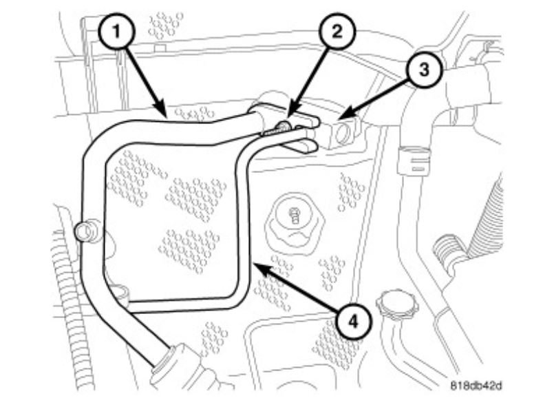

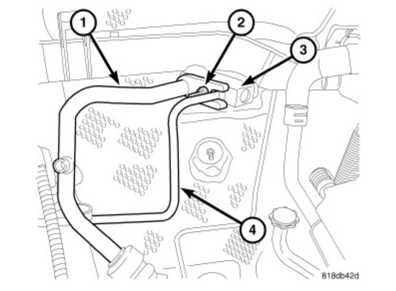

expansion valve
REMOVAL
WARNING: Refer to the applicable warnings and cautions for this system before performing the following operation See: Heating and Air Conditioning > Vehicle Damage Warnings > Warning and See: Heating and Air Conditioning > Vehicle Damage Warnings > Caution . Failure to follow these instructions may result in possible serious or fatal injury.
NOTE: LHD model shown in illustrations. RHD model similar.
imageZoom/Print
1. Recover the refrigerant from the refrigerant systemSee: Heating and Air Conditioning > Procedures > Refrigerant System Recovery.
2. Disconnect and isolate the negative battery cable.
3. Remove the nut (2) that secures the A/C suction line (1) and the A/C liquid line (4) to the A/C expansion valve (3).
4. Disconnect the A/C suction and liquid lines from the A/C expansion valve, remove and discard the O-ring seals and position the refrigerant lines out of the way.
imageZoom/Print

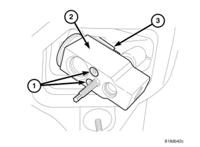

5. Remove the two bolts (1) that secure the A/C expansion valve (2) to the evaporator tube tapping block (3).
6. Remove the A/C expansion valve from the evaporator tube tapping block and remove and discard the O-ring seals.
7. Install plugs in, or tape over the opened refrigerant line and evaporator tube fittings and all expansion valve ports.
