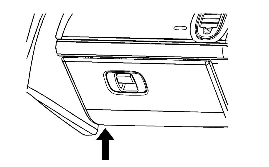

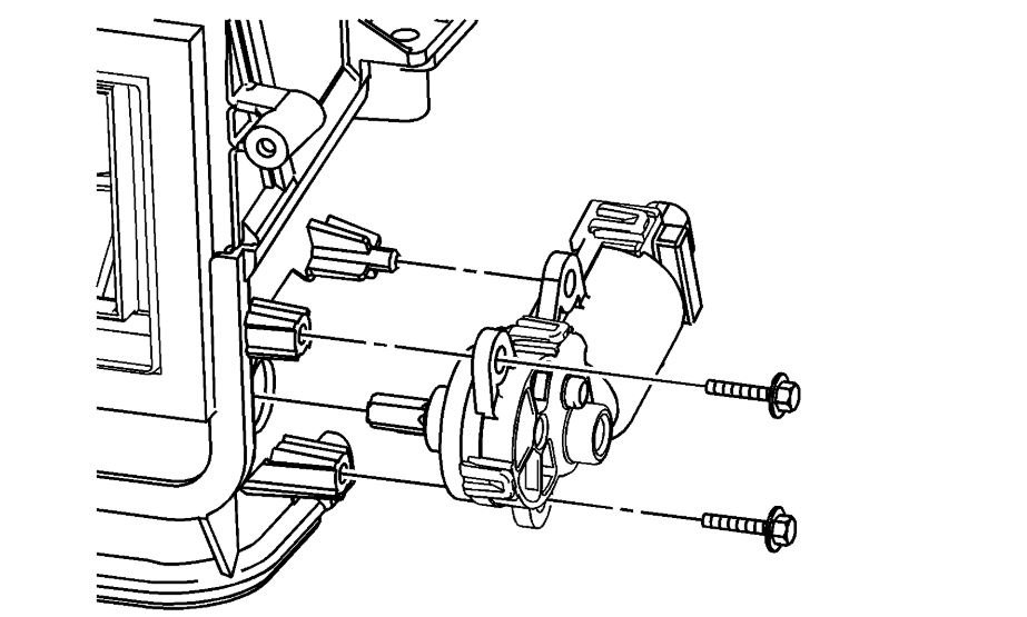

There is a mode door motor that controls the mode operations.
Attached is the procedure and some pictures as well.
REMOVAL PROCEDURE
1. Remove the fuse labeled HVAC CTRL (BATT).
2. Completely open instrument panel (I/P) compartment door by pressing both tabs that support the stop bumpers. Refer to Compartment Replacement - Instrument Panel (I/P) in Instrument Panel, Gages and Console.
3. Remove the mode actuator wire harness connector.
4. Remove the mode actuator screws.
5. Remove the mode actuator.

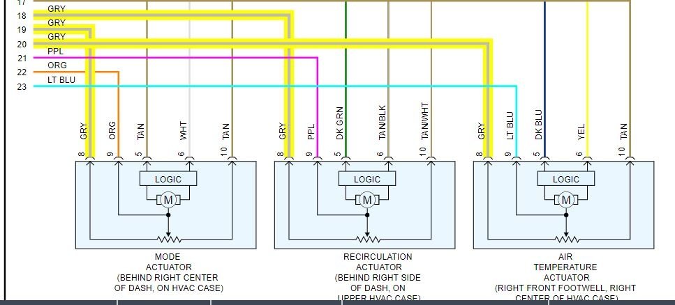

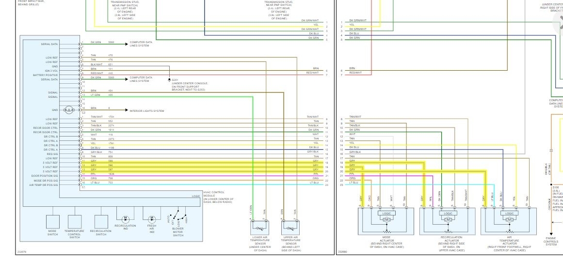

I highlighted the wires that need 5 volts. Test for power to the actuators.
What code did you clear? What repairs were done?
As far as calibration, you need to remove the HVAC fuse for 2 minutes, then install and turn the key on for 2 minutes for the control unit to calibrate the actuators. Did you hear the actuators move?

You need to do the tests on the actuators.
Jul 30, 2019 at 4:41 PM
TVKRUPICA17
  • 10 POSTS
How do I test them per your idea?
Jul 31, 2019 at 11:22 AM
You need a voltmeter and test the wires I have highlighted for the 5 volt reference on all the actuators.
Let me know the results.
