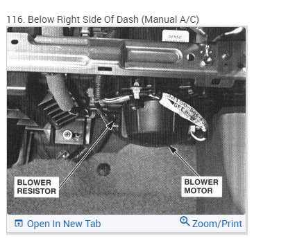

So, the A/C and heater only blow air on the 3rd or 4th fan setting. I thought maybe it was the cabin air filter, but I’ve changed those, and it didn’t help. The compressor does seem to be kicking on though. Not sure where else to go from here w that issue.

The fan issue is likely due to a faulty blower motor resistor. The resistor located on the blower motor controls the air speed as you turn the fan speed knob. Faulty resistors can make only certain speed work or make it stop working all together.
Here is a helpful guide:
https://www.2carpros.com/articles/blower-fan-motor-works-on-high-speed-only

I have attached blower motor resistor diagram for your reference.
