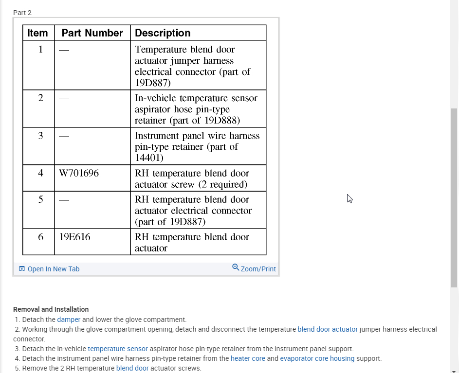

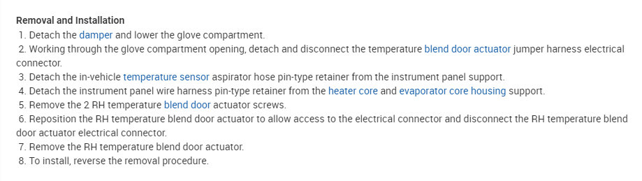

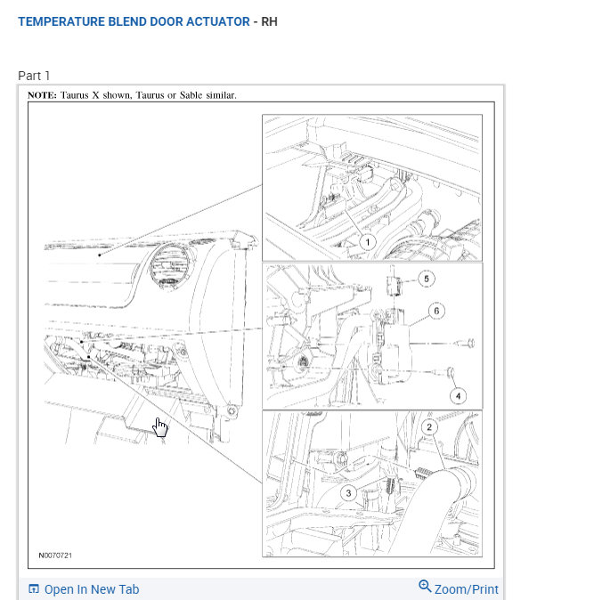

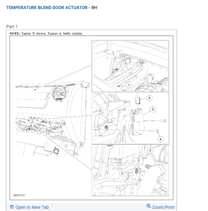

Okay. You have two blend doors. One for each side. So when you say you replaced the actuator, was it the one on the passenger side? I attached the process just to confirm.
Let me know and we can go from there. Thanks

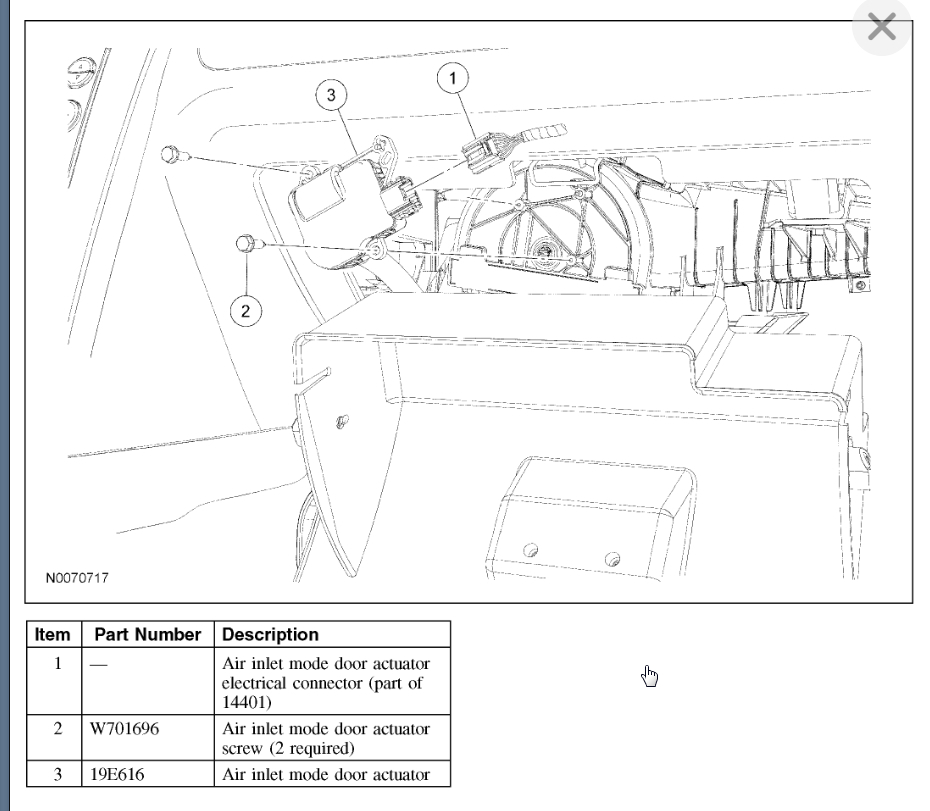

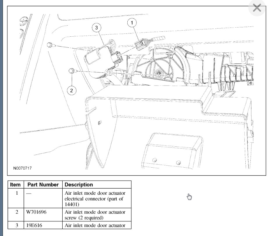

Okay. So the blend door actuator is what controls the temperature of the air. The mode door actuator is what controls where it blows out (defrost/floor/vents) and the air inlet mode actuator controls if it is fresh air or recirculate. So you have separate actuators for each function. So when you say it moves positions okay but only blows hot, I am just concerned you are confusing door operation.
Also, can you take a look at the instructions I attached earlier and then this picture as well? The air inlet door actuator is behind the glove box as well as the passenger side blend door. Is it possible that you changed the wrong actuator?
If not, then remove the passenger side blend door actuator and plug it back in then change the temp on that side and see if the actuator moves. If it moves then either the door wasn't in the correct position when you installed it or the door is the issue. At that point, you can move the door with your fingers and see if the air temp changes.
Clearly with the actuator plugged in, set the temp to MAX cold or hot and which will move the actuator to that position, and then manually set the door to that position with your fingers and install the actuator. That will make sure they are synced up.
Let me know if you have questions about this. Thanks.
