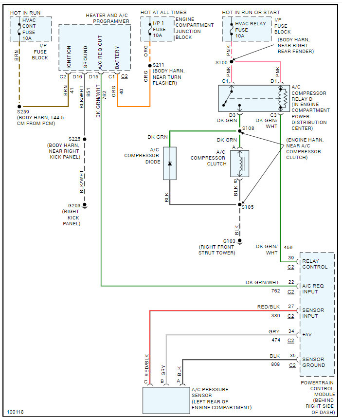

Cluth still wouldn't engage and no cold air inside the cabin. I swapped out the AC Compressor and Horn Relays and the Horn worked fine with both, but the Compressor wouldn't run with neither.
I used a paper clip to bridge the correct pins in the relay box, and the compressor finally engaged.
I left it running for a while with the AC turned on but still no cold air.
I removed the paper clip and started the car and the AC with the relay inserted again, but the AC clutch won't engage.

When the compressor was running what were the high and low side pressures? Also, I would remove the low side pressure sensor and use a jumper wire to see if the compressor engages. Most of the time when the compressor comes apart internally like this you should replace the condenser because this is where the compressor seal material ends up and clogs it up. Please go over this guide which can help and get back to me with the pressures.
Check out the images (below). Let us know how it goes.
