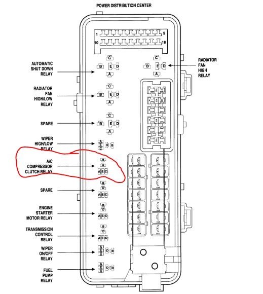

A/C quit working. Changed compressor, air drier and expansion valve. While charging A/C the compressor wouldn't turn on so I jumped it so I could still charge the system, but still no cold air and the compressor won't kick on without jumping it.

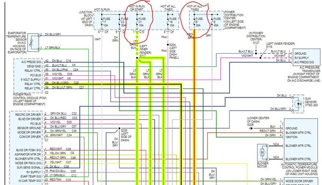

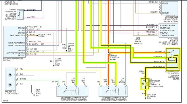

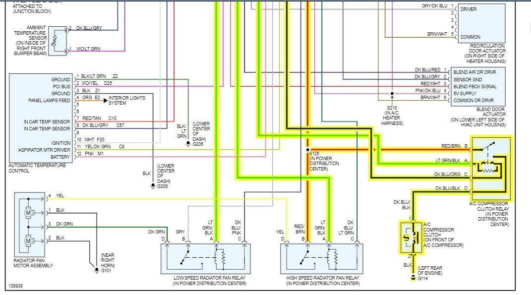

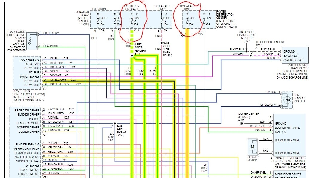

I attached a wiring diagram of the compressor for you. If you have a voltmeter, we can do some testing to determine the failure.
