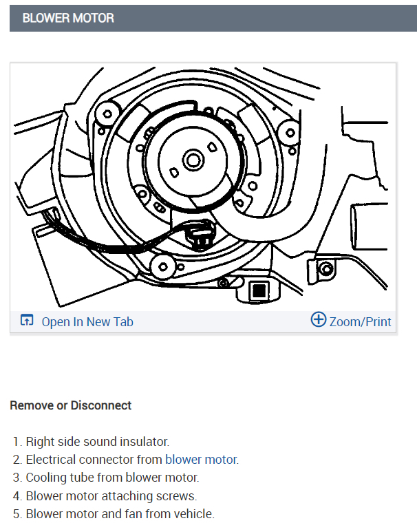

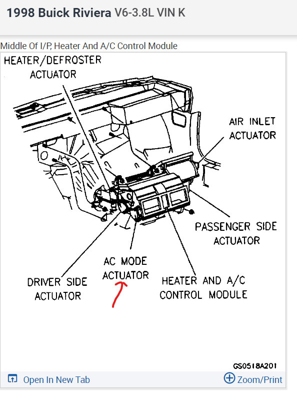

Can you hear the blower motor running when the system is on? If not, you could have a bad blower motor and if so, it sounds like the mode actuator is not working?
This guide can help:
https://www.2carpros.com/articles/low-or-no-air-flow-from-vents

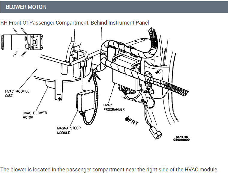

Here is how to test the blower motor wiring and I have included the blower motor and mode actuator location so you can check it out.
https://www.2carpros.com/articles/how-to-test-an-automotive-hvac-system-blower-fan-motor-a-detailed

No, I can't hear the fan at all. I put in a new blower motor about 5 years ago. I was reading it could be the blower resistor. Do you think that could be the issue?
Aug 24, 2024 at 12:17 PM
  • 55,433 POSTS
The blower resistor only comes into play on the lower speeds. Does the fan motor work at high speed? If not, I would use the guide above and if you have power and ground replace the blower motor again.

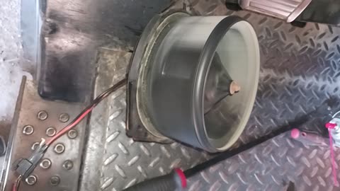

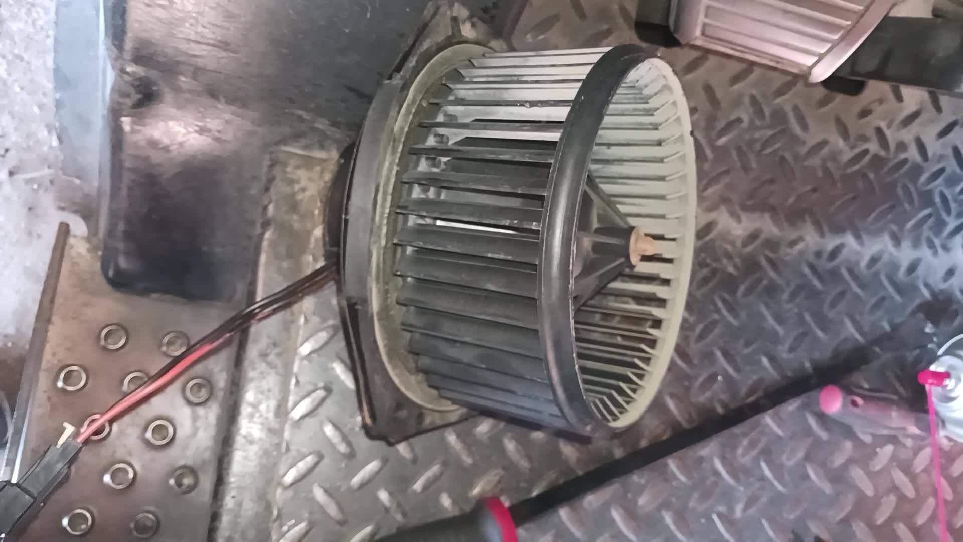

Okay, so, I removed the blower and i hooked it to a battery and it turned on. I attached the video.
Also, I forgot to mention that the A/C doesn't turn on at any speed, high or low.
I tried putting a test light on the blower connector and turning on the A/C but I didn't get any power. However, I'm not 100% sure if it's because I wasn't getting a good ground. But it seems like there might be a short somewhere, correct?

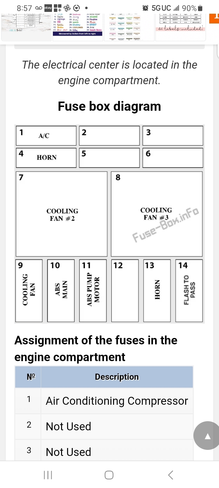

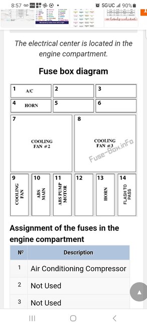

Another thing I was curious about is this fuse box located under the hood in my 1998 Riviera. There's 2 relays labeled Cooling Fan #2 and Cooling Fan #3. Below those there's one labeled just Cooling Fan.
I assume Fans #2 and #3 mean the radiator fans, but what about the one just labeled Cooling Fan, could that be for the A/C blower?

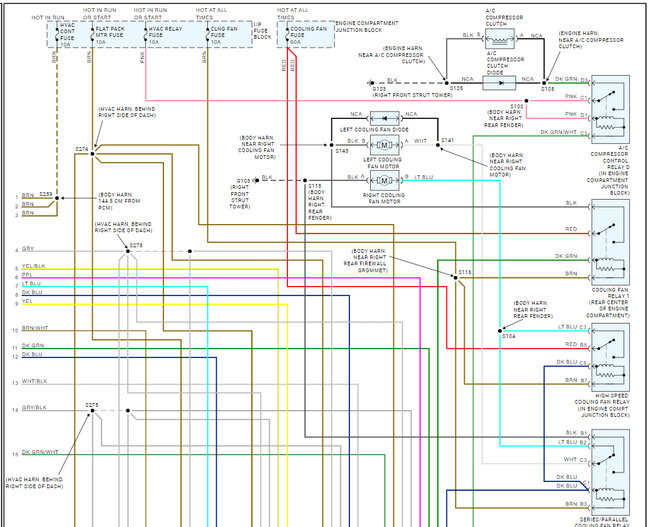

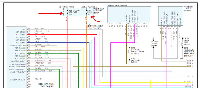

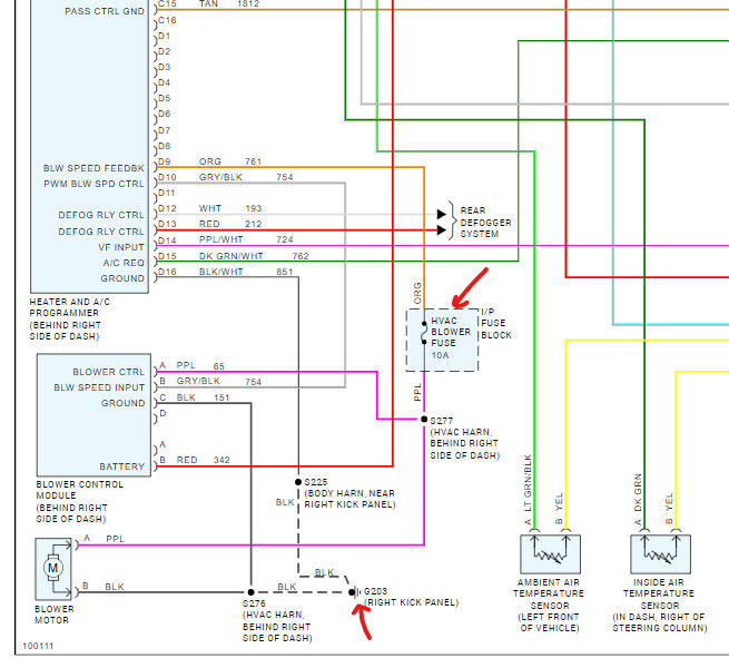

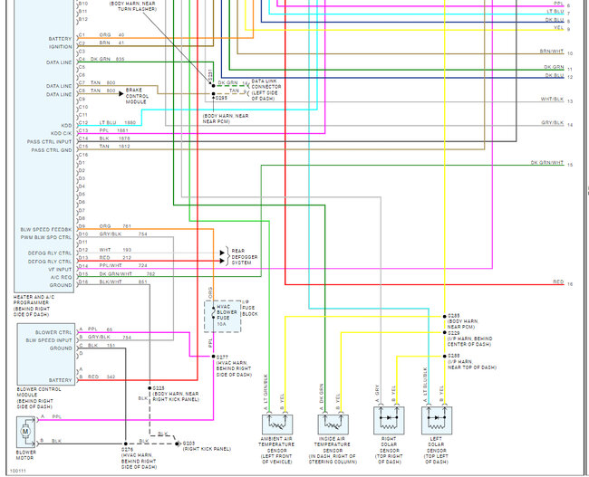

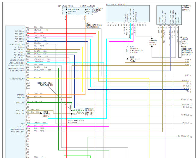

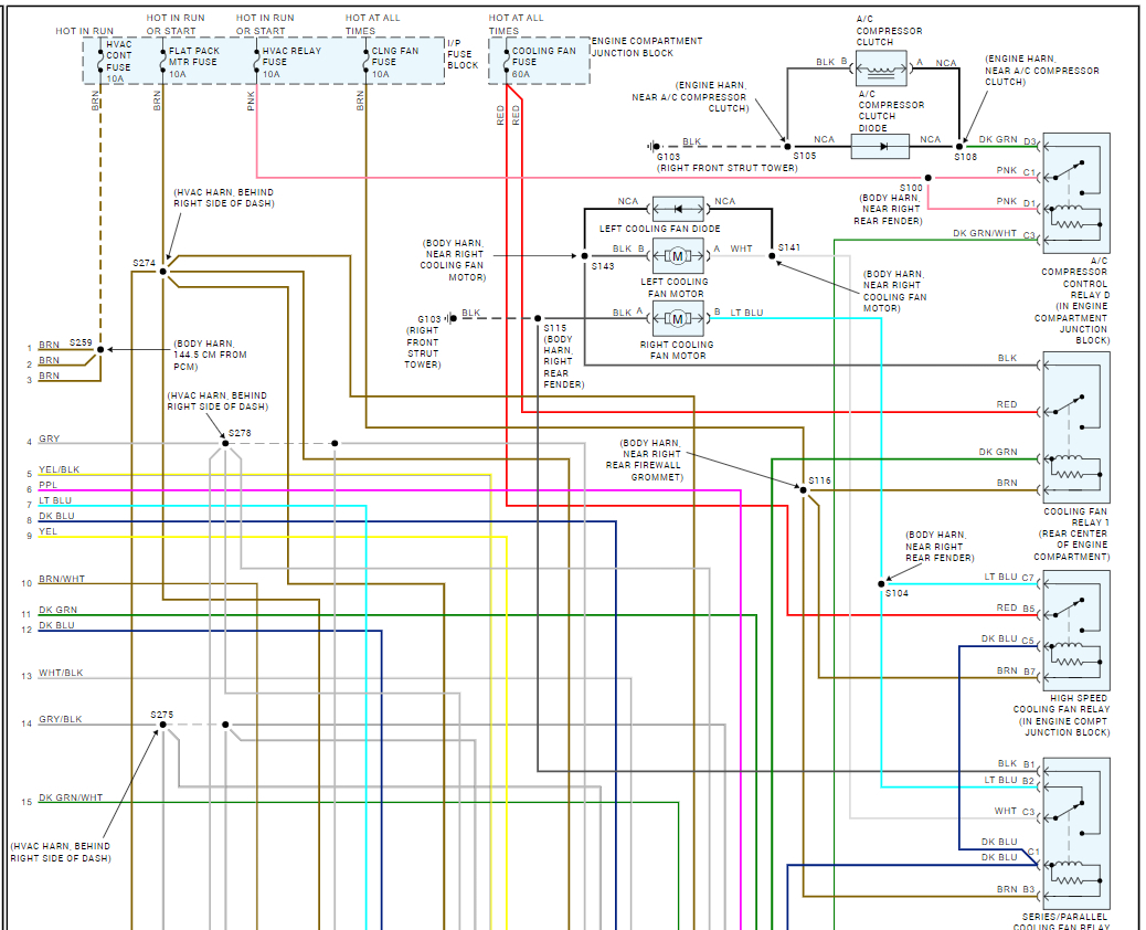

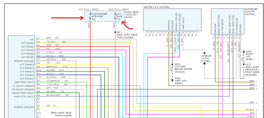

You can check the ground by using this guide with the test light connected to power.

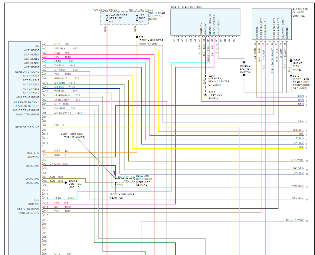

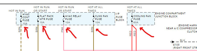

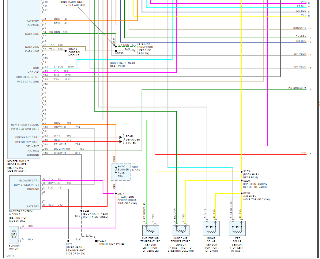

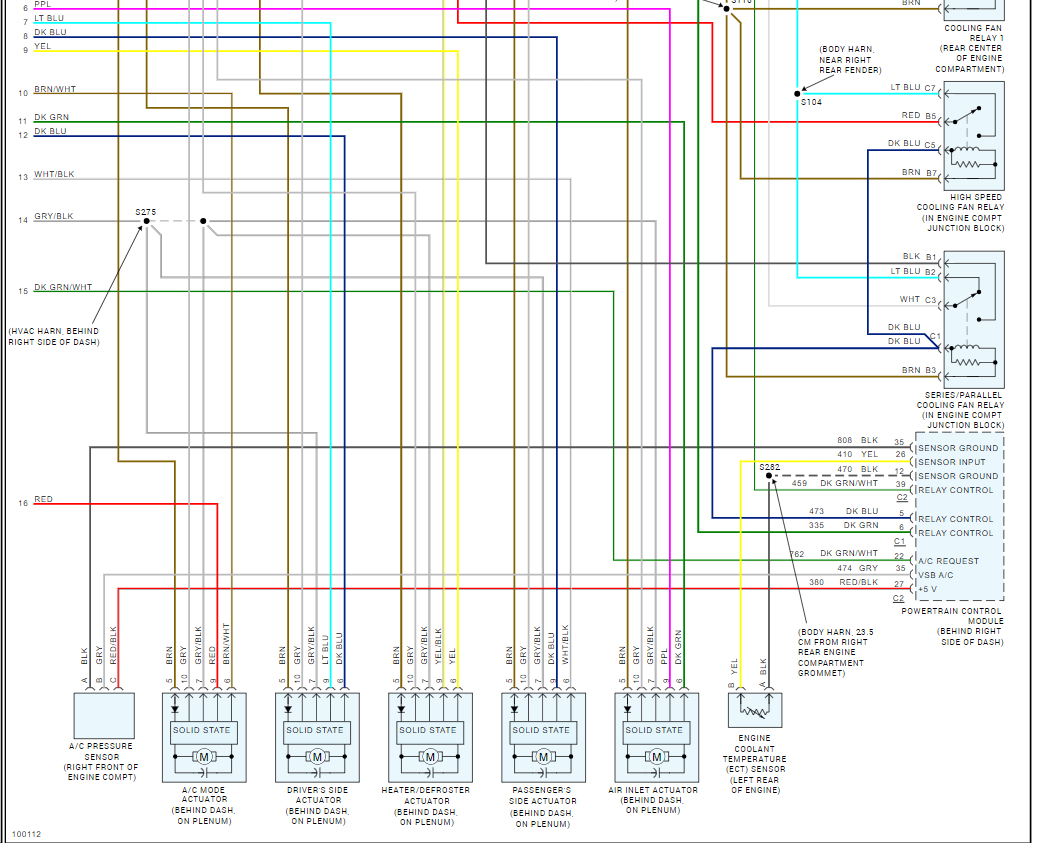

I would also check the HVAC blower motor fuse and the IP 1 fuse in the right rear fuse panel. I have also included the other five fuses that run the system in the images below that need to be checked as well and their locations.

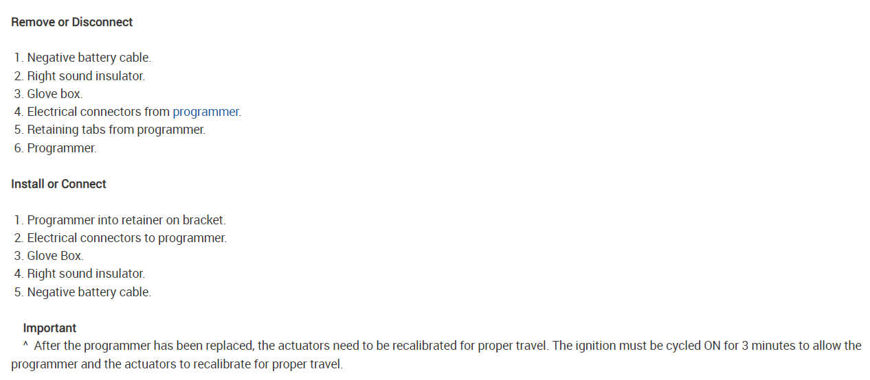

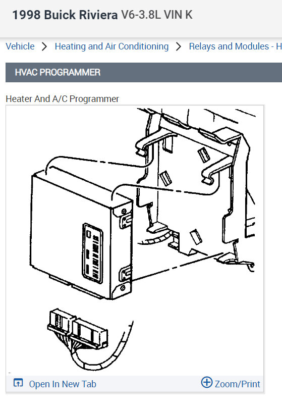

If all fuses are good and the ground is good, I would replace the Heater and AC programmer behind the right side of the dash. I also included the complete HVAC wiring diagrams. Check out the images (below). Please let us know what happens.

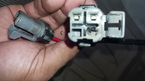

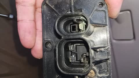

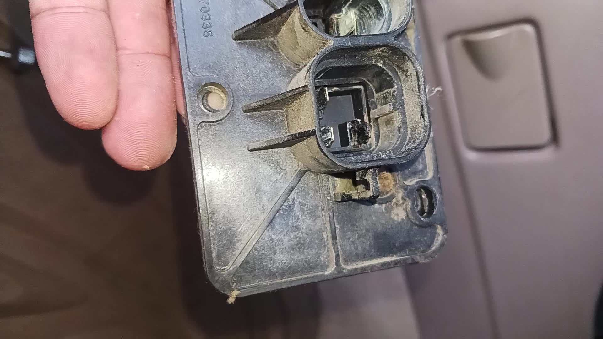

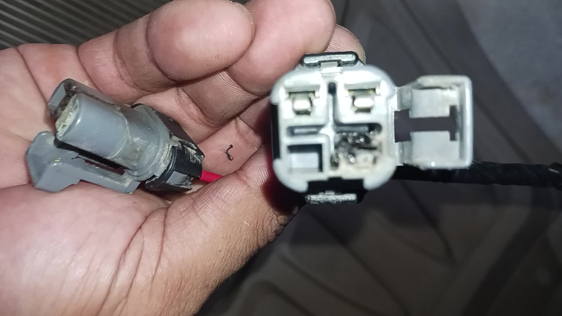

However, when I disconnected the blower motor resistor, I found that one of the wires is burned. And the corresponding terminal on the resistor itself looks black as well. On the backside of the resistor, there's some green powder, similar to the buildup on battery terminals. There's some videos below. I am going to replace one of the connectors on the resistors, but just visually would you recommend putting a new resistor as well?
Aug 26, 2024 at 10:10 AM
  • 55,433 POSTS
Yep, you found the problem. Thanks for the videos, this will need to be repaired before the blower motor will work again, replace both the connector and the resistor.
