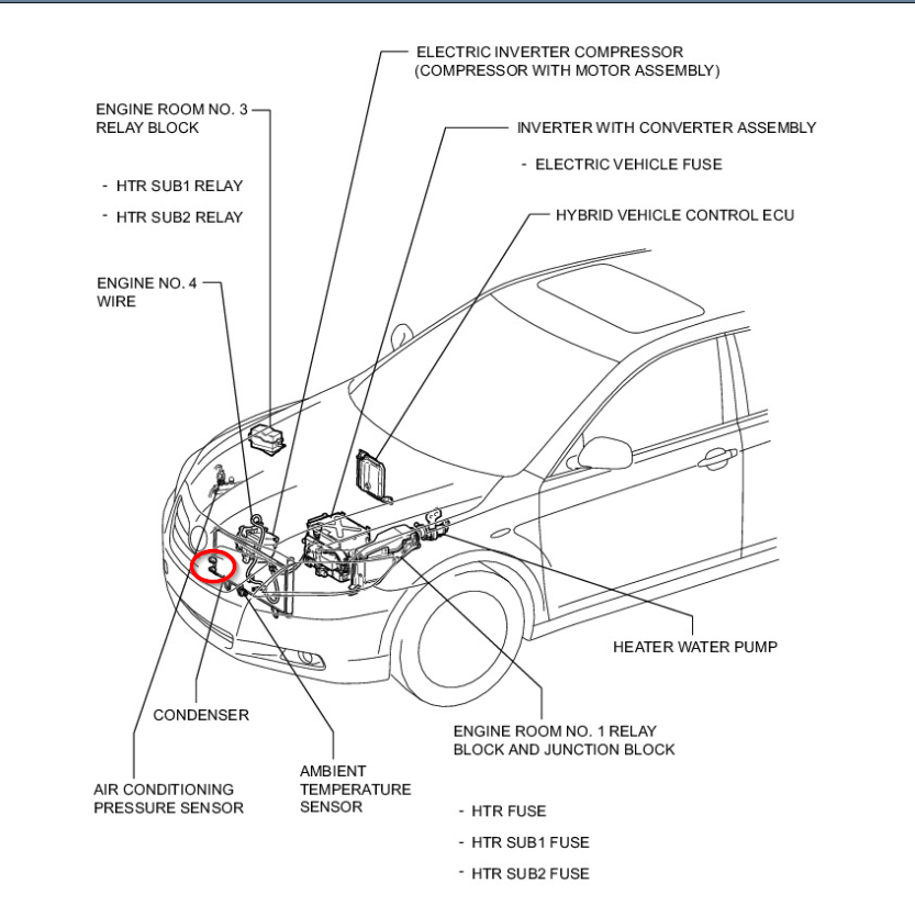

Yes. If there is a code for the high pressure sensor then that means the pressure is too high or the PCM is being told that it is and it will cut the compressor on. This means if the compressor is off then the fans do not need to run.
So this sensor code can cause all of these issues. Let's start with what that code is and we can go from there.
However, we also need to know what the pressure is when the A/C is on and off. The fact that it does work at times shows that the system is capable but we need to find out what the actual pressure is. I am concerned when people say that the level of the freon is fine because that normally means that they tried to top it off with one of those cans and either that gauge was in the green or it would not take any more. Unfortunately this is not going to tell us what we need so just let me know if you can get the pressures of the low and high side.

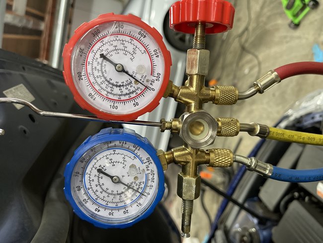

Car off, gauges connected and opened, both at zero.. more to follow.

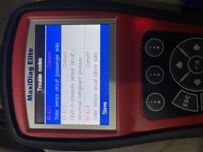

Bare in mind that i have replaced the high pressure sensor and i may or may not have deleted the code for it. But before i did there was only one code, which was the B1423. Not sure where the other came from. I deleted the code while ignition is on and started the car all still there. More to follow.

Only added few seconds of Freon and fans came on and i think the compressor did as i can hear it (can see the clutches of course as these compressors look different) still not cold but am sure as soon as i add more it will be.
Aug 20, 2021 at 1:46 AM
DIVIDES
  • 903 POSTS

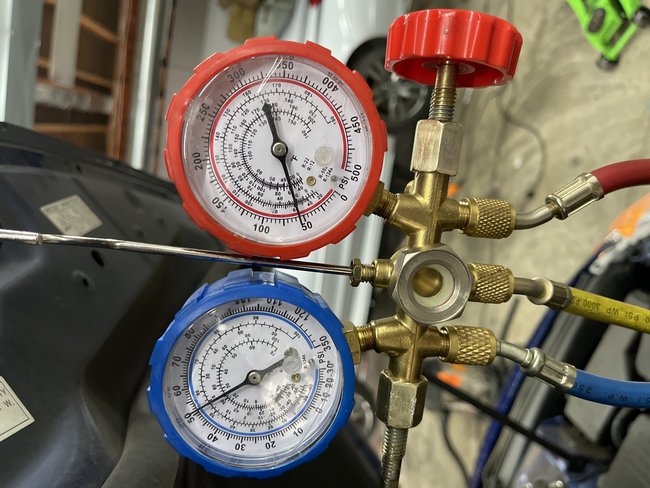

Added more and it's very cold, pressure in low side around 33.
Aug 20, 2021 at 2:04 AM

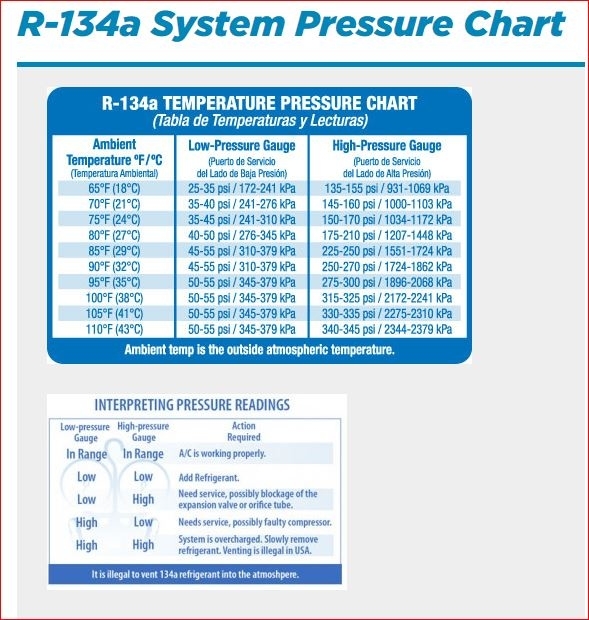

Okay. That is great. The low side sounds like it is right in line. I attached a chart below that will show proper pressures. However, if it starts to blow warm again then it is leaking. So just keep in mind if it does that we will need to confirm that by pulling it into a vacuum.
Great work and thanks for posting pictures. That really helps.
Aug 20, 2021 at 10:53 AM

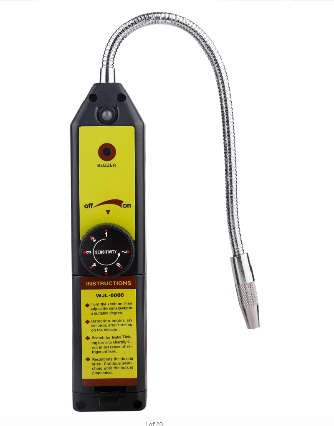

Sorry, yes you are correct with this being a hybrid you must use a gas leak detector. Basically they are called sniffers and they beep when they pick up Freon. However, that requires you to fill the system again and then start it and run it and see where it is picking up the Freon.
Otherwise, we would have to relay on feeling it or hearing it and that is near impossible.
They sell these things at most parts stores. You can get a cheap one for less then $50.00 if you care to do it. However, they are sensitive to storage so make sure it is in a cool dry place. Since you won't use it often, if not stored properly it will turn into a single use tool which is not desirable.
See below for a picture of the most common one. I would pick up a pair of insulated gloves as well just because you may poke around the high voltage system and just to be safe, you want to protect yourself.
