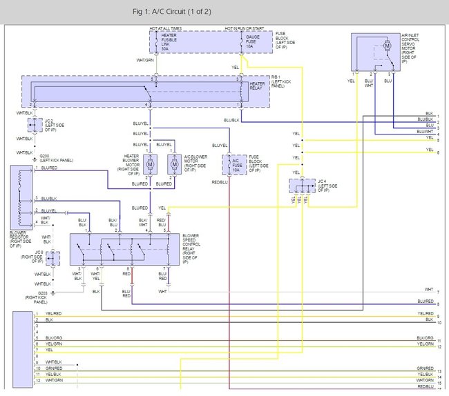

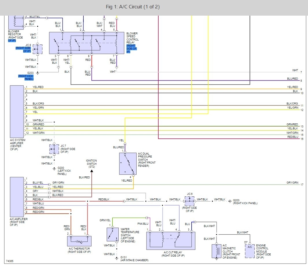

When car is cold, the airflow in the heating system is good, but sometimes with good and warm engine the air flow shuts down. the blower motor runs at full speed, but still no air coming out of the vents. Even if i change the temperature too cold the air flow is bad. I have changed three servo motors, resistance for the blower motor, both thermistors and head unit. when i run the check A/C for fault codes, it sometimes come up with code 21 and 24. sometimes it can work almost okay for days (still a little weak air flow i imagine) suddenly it turns bad again. when it is not working i have heard a strange sound from somewhere in the compartment area when the heater starts or when i turn off the ignition. (squeaking sound)
Hope you can give me some tips about what to do, because i am running out of good ideas regarding to how to find the fault.

Good afternoon,
This sounds like something in the housing, such as a door, is sticking not allowing the flow of air.
I would remove the blower motor, inspect the wheel on the blower for any damage and then look or feel up in the duct for any obstruction in the ducts.possibly paper of some kind that moves around and blocks sometimes but not others.
Read the guide below, it will help
https://www.2carpros.com/articles/low-or-no-air-flow-from-vents

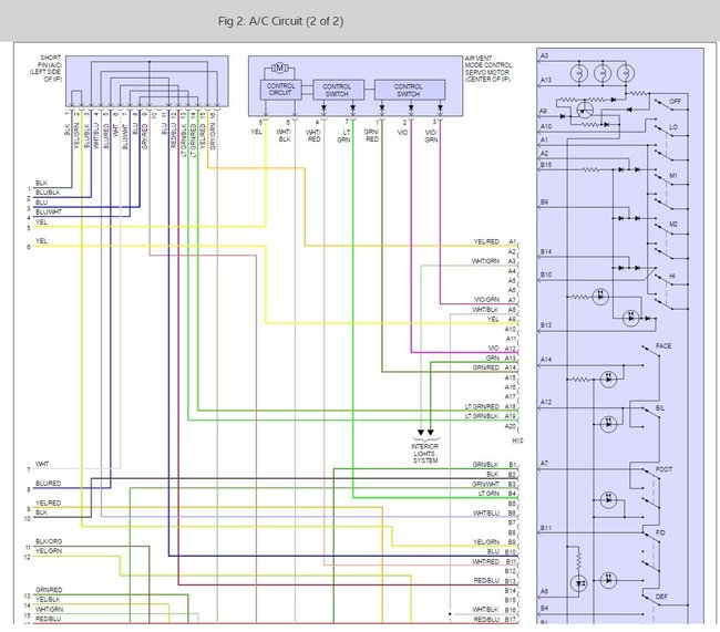

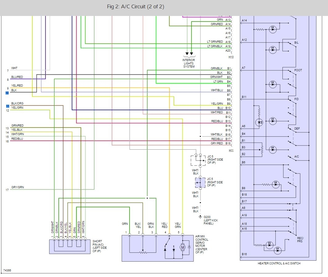

This sounds like you have an air blend door actuator that is not working. You have two blend door actuators that run the system, here is a guide and a wiring diagram to help you get the problem fixed. You will probably need to replace the actuator.
and
