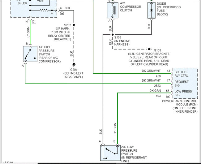

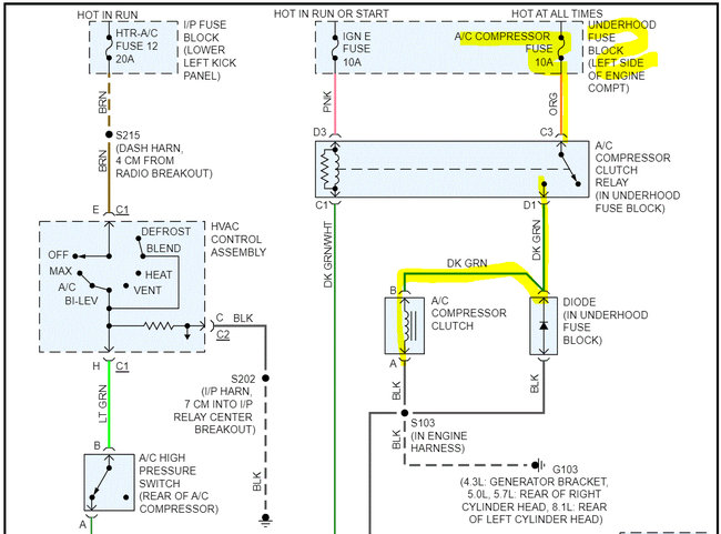

The compressor clutch shouldn't have ground at both connectors. One is a ground, but the other is for power. If you check the wiring to the clutch, do they both show ground?
There should be a dark green wire and a black wire to the compressor clutch. The dark green wire receives power from the compressor clutch relay which is an open circuit until AC is requested. Pull the compressor relay and see if the fuse still fails.
I attached the wiring schematic for the circuit below, so you have a reference.
Try this and let me know what happens. Also, it does have both a high and low-pressure switch.
Take care and I'll watch for your reply.

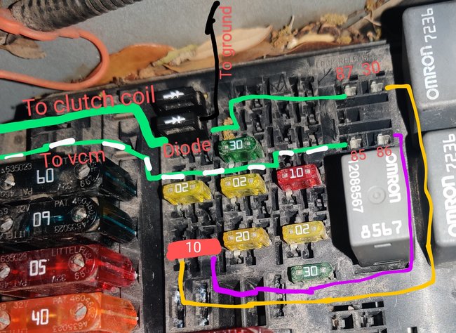

I've removed the relay and tested the clutch coil harness. still grounded on both pins.
I've also just discovered something. The fuse is actually piping as soon as the van starts. Not when starting the ac as I thought.
I've done the following tests:
Removed diode and started: fuse pops.
Removed relay and started: does not pop.
Removed fuse and relay: does not pop.
During all of these tests - the clutch coil harness is always grounded on both pins.
To help me visualize the diagram you sent, this is a crappy diagram I drew up. The numbers on the relay socket correspond to the relay orientation (that I have it) and numbered pins.
What should I test next?

The fused power goes through the relay. If it doesn't fail with the relay out, then the problem is either the relay, the connector pins the relay connects to, or the wire between the relay and the compressor is shorted to ground. One of the two wires should provide power and not ground.
Trace that wire and see if you can find anything damaged. Also, if nothing is found, disconnect the battery and inspect the fuse/relay box.
