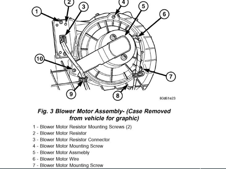

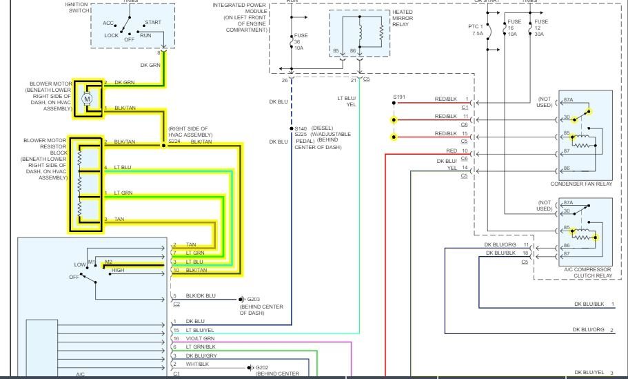

You need to test for voltage at the blower motor when the motor stops working.
You will need a test light to check and see if there is the voltage on both wires at the blower motor.
If you have the power there, you need to test for power to the blower resistor as well. It could be either one causing the issue.
The blower motor is located on the passenger side of the vehicle under the dash
1. Disconnect and isolate the battery negative cable.
