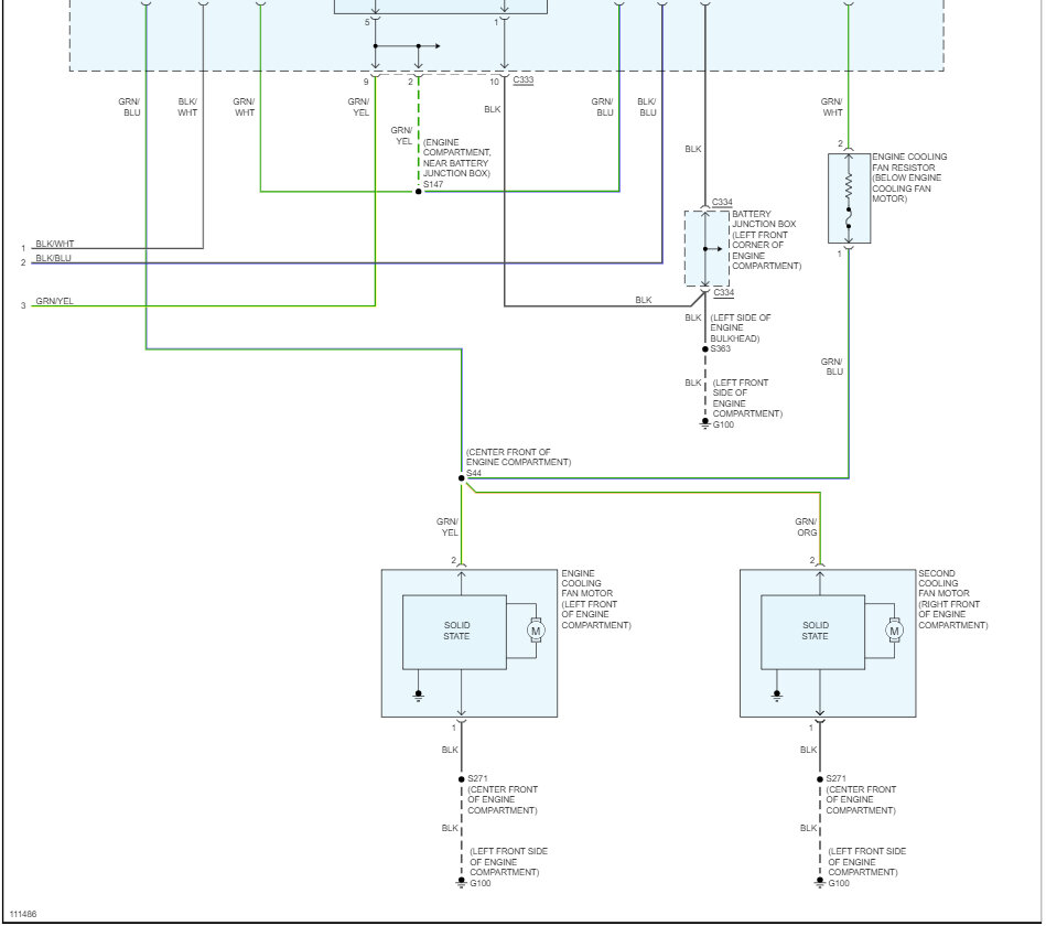

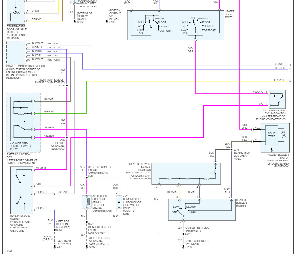

Dears, due to my lot of A/C problems (occasionally short cycling) I would like to test the temperature sensor of the evaporator. As I can read on lot of Google results it is usually on most vehicles on the right (passenger) side and is reachable after removing glove box. But after done that today, I found only a plastic square device connected with multiwire connector and after removing it I saw that it has only a small plastic axle that gave me a conclusion it is some step motor or similar like that. Do you have some diagram or knowledge of where is the location of that sensor?
Oct 15, 2023 at 8:29 PM
  • 55,224 POSTS

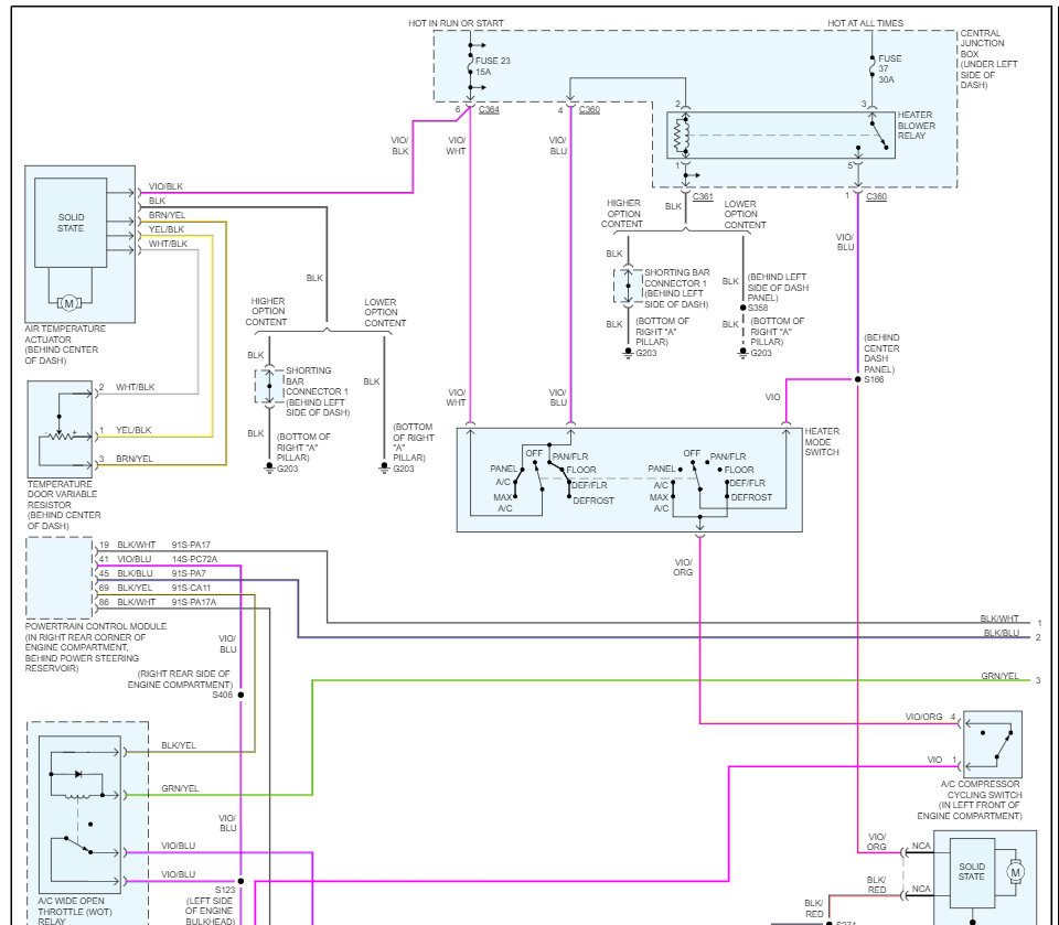

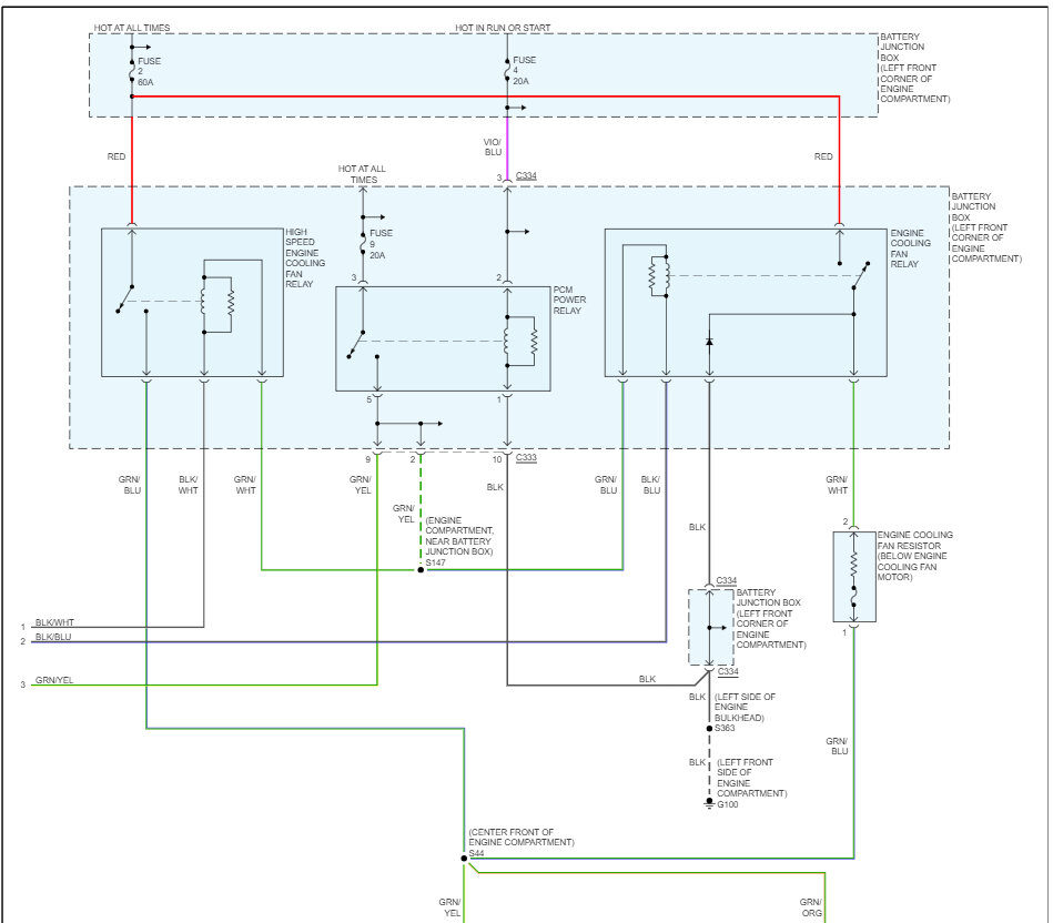

This car does not have an evaporator temperature sensor. Here are the A/C wiring diagrams so you can see for yourself. Check out the images (below). Please let us know what happens.
Oct 16, 2023 at 3:47 AM
WISH30
  • 124 POSTS
What prevents the evaporator core of freezing?
Oct 16, 2023 at 3:49 AM
  • 55,224 POSTS
They just use the high and low side pressures to regulate the temperature.
