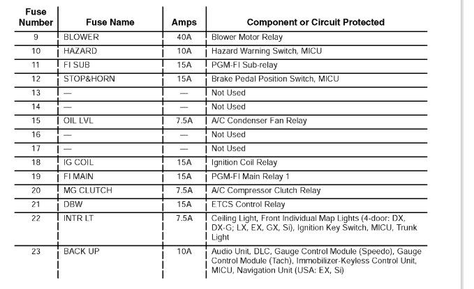

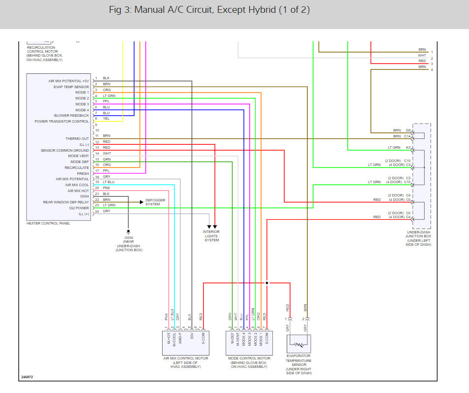

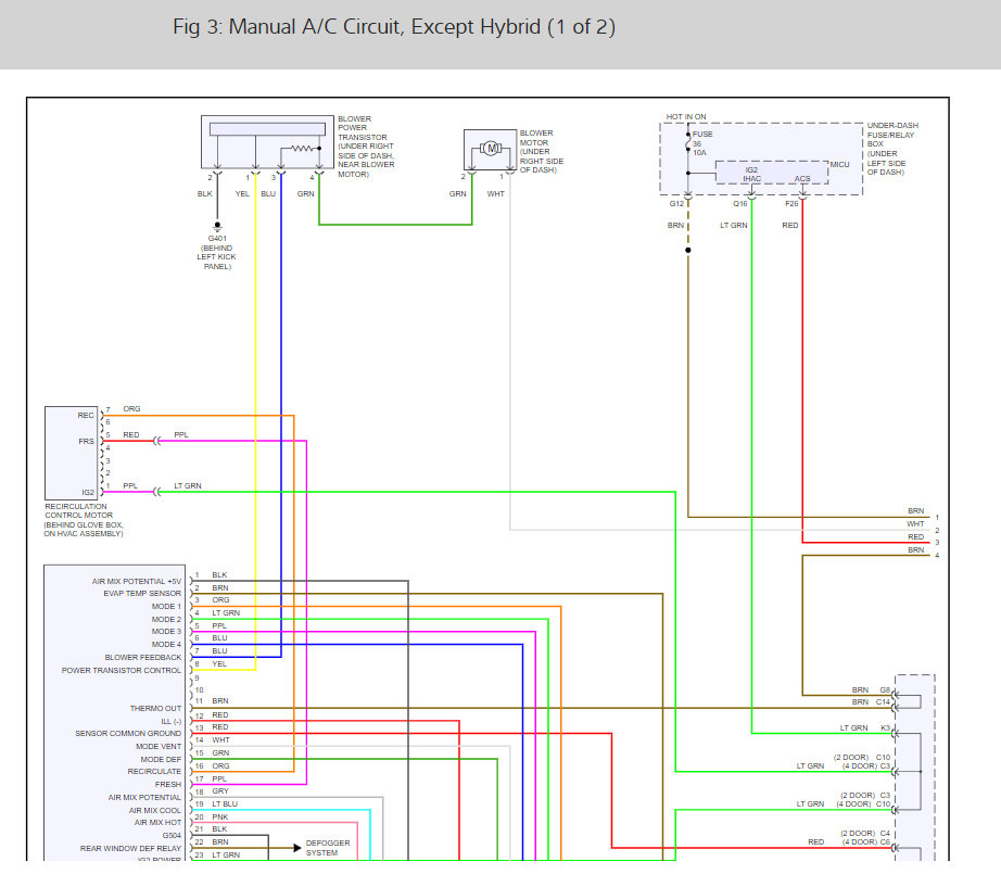

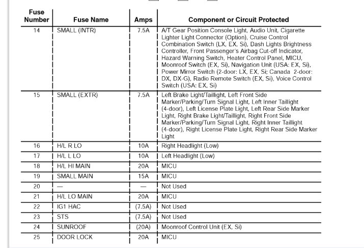

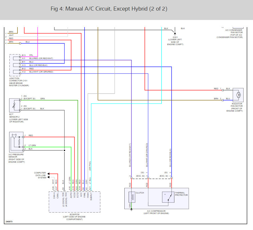

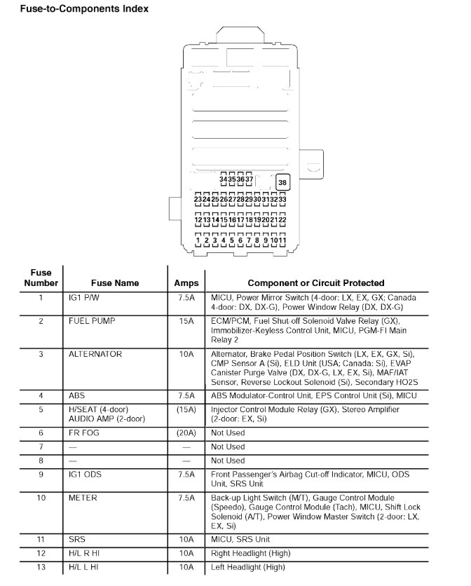

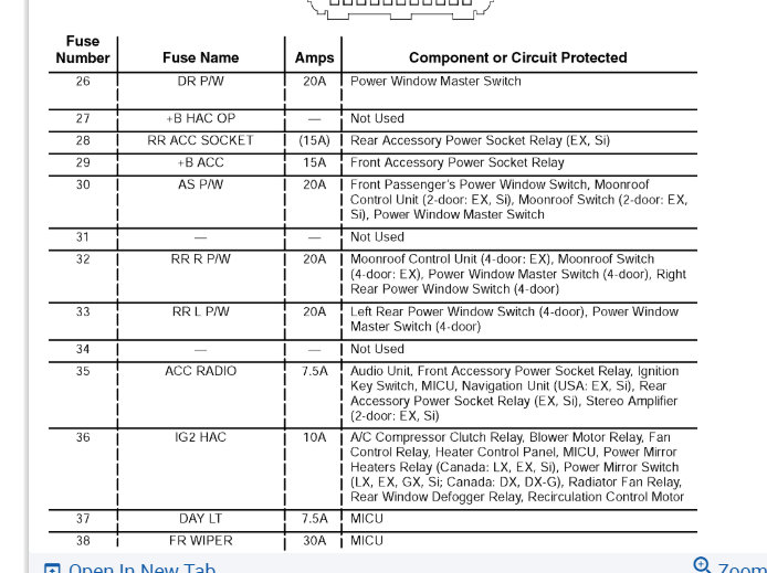

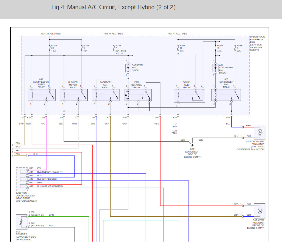

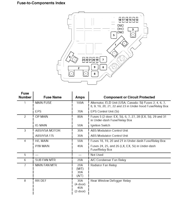

A/C was working but it was freezing up the A/C lines. so i took all the Freon out and vacuumed the system out, then i refilled the A/C with the amount that it is suppose to have and the A/C worked fine. but then when i turned the A/C off the compressor would stay on the whole time. so i removed the A/C compressor relay and turned the compressor off that way but when i put the relay back in my radiator fans and my compressor don't kick on anymore? and i have tried new relays. i can also jump the compressor relay port and make the compressor kick on by crossing the plugs as well as i can do that with the radiator fans too, but i cant get them to stay on without crossing them.
Aug 8, 2019 at 11:22 AM
  • 55,398 POSTS
Lets first check for power at the 7 fuses that run the system. here is a guide to help you check for power and the fuse locations below with the air conditioner wiring diagrams so you can see how the system works and which fuses to check:
