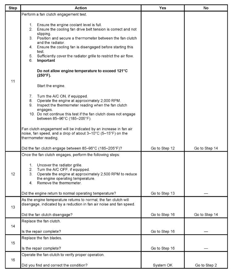

My truck doesn't blow cold when i first crank it, it has to reach operating temperature first (205°f) after that, it's ice cold. the compressor runs the whole time but it isn't blowing cold until it reaches temperature, any ideas?
New high and low pressure switch, new climate control switch, the condenser is clear of debris. Truck is equipped with electric fans that turn on at 185 degrees.

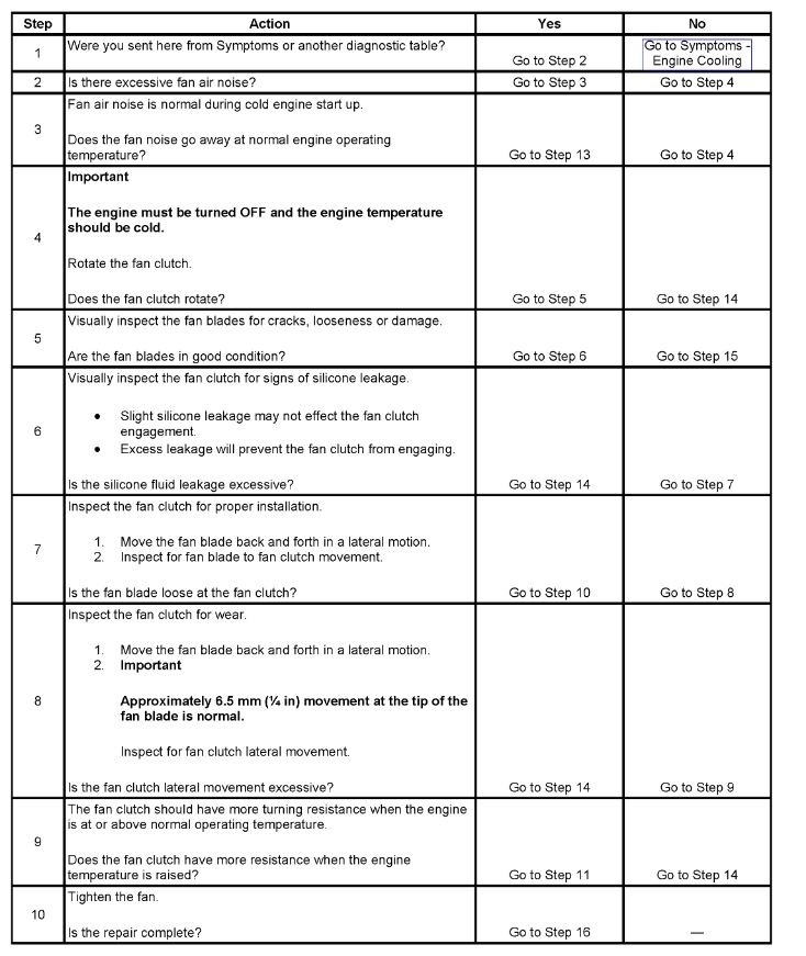

Hi, I'm Dan. If the compressor is running, then we want to feel the lines going into the evaporator core at the firewall to see if they are cold. Any chance of getting pressure readings on the system?
Also, when the truck is first started, does the mechanical fan make noise like it's working? Does it flow a lot of air when it's idling with the A/C on? There is a possibility that the mechanical clutch is not working.
I've attached a pinpoint test for checking the fan.
There is also the chance that the A/C system is low on refrigerant.

A/C lines are cold, just had system vacuumed and charged as well, i don't have a mechanical fan, i have electric fans that kick on at 185 and 195.
