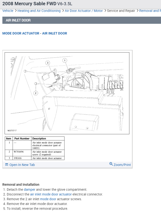

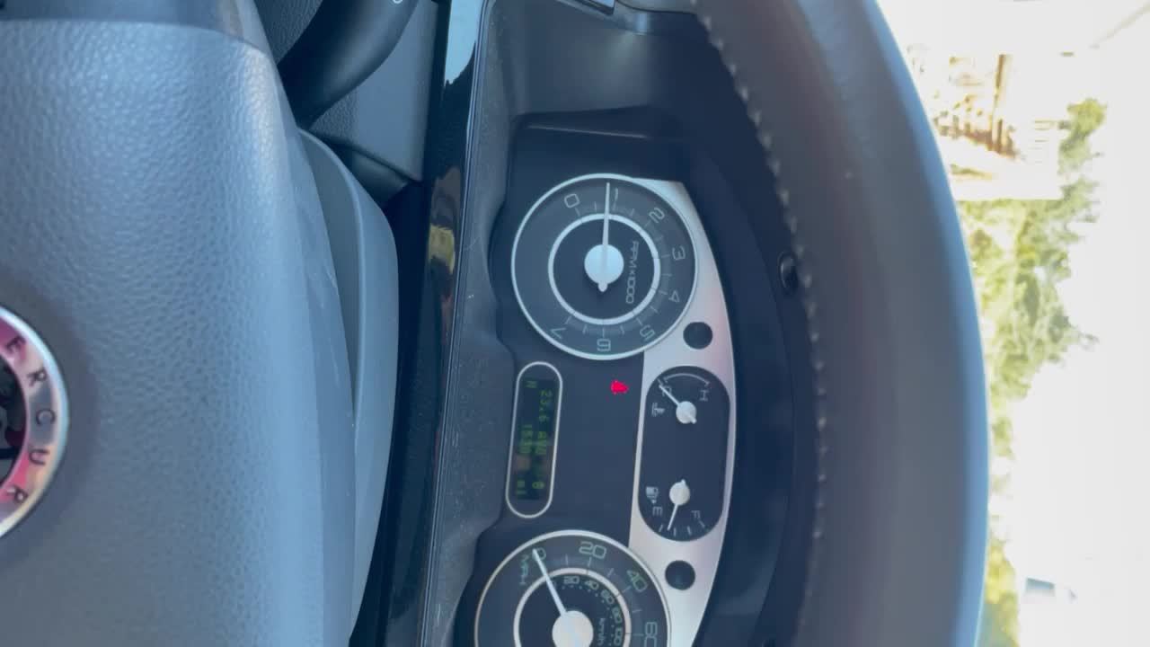

When I turn my car to defrost of floor vents there is no air that comes out. The air will come out of the dash vents. The system will make a clicking noise when the A/C is turned on. It has since I got the car in 2008. But just recently have I lost all of the defrost functions. Not sure where I would start to see where to find the problem and don’t want to take to a mechanic if it is something I could fix on my own. Also, when this happened, I lost the light behind my temperature and fuel level on my dash. Not sure if they are connected or not.

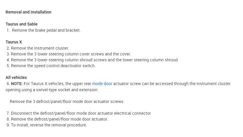

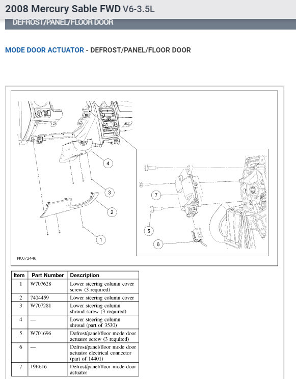

The air flow issue is likely due to a stuck mode door actuator. That actuator controls where the air will flow (floor, defrost, dash etc.).
As you can hear the clicking, it is likely the actuator making that noise as it's trying to switch positions but unable to.

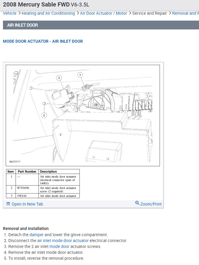

There are two actuator one for the air inlet door (behind the glove box), other is the mode door (under the driver side dash).
Where do you hear the clicking noise coming from?
I have attached the replacement instructions for both.

The clicking noise is in the drivers dash.

So it is the mode actuator that is located under the driver side dash.

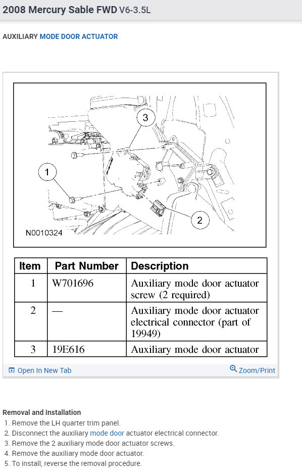

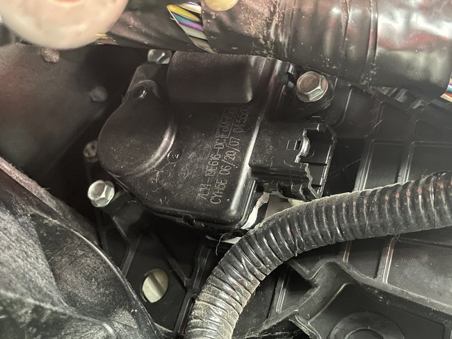

I found the clicking is coming from the actuator farther up. What part is that?
Oct 16, 2021 at 8:14 AM
SQM
  • 6,383 POSTS
There is an auxiliary mode door actuator for this vehicle.
Oct 16, 2021 at 9:15 AM
SNSHN1981
  • 6 POSTS
I got it fixed. Thank you so much!!!
