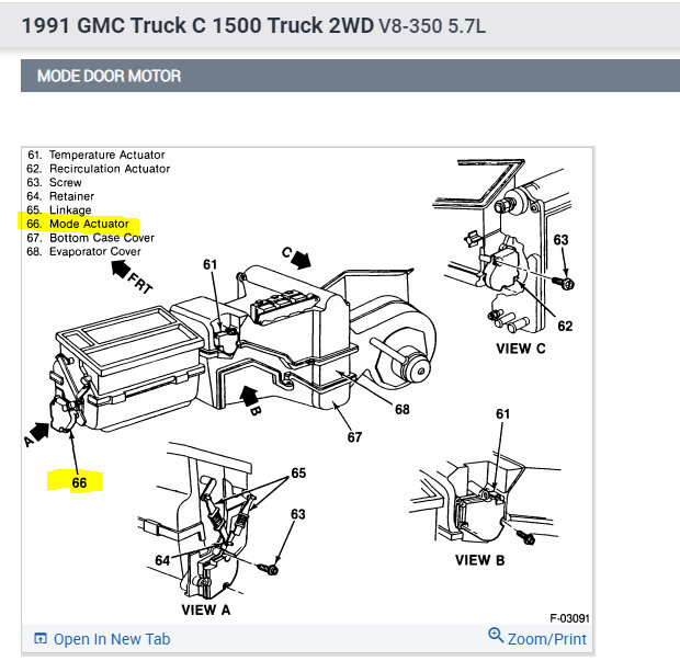

The air conditioner is stuck in defrost mode, how to repair this?
1991 GMC C1500
307,000 MILES • 5.0L • V8 • 2WD • AUTOMATIC
PCAMPBELL50
The air blows out of the defrost in the dash. A/C control module? How do I fix this? Thank you for any help.

It sounds like an issue with the mode door actuator. That is what is responsible for airflow direction.
To get you started, take a look through this link. It explains in detail what is the most likely cause of this condition.
https://www.2carpros.com/articles/air-vents-stay-in-the-defrost-position
If you look below, I included the directions for replacing the actuator. What I would recommend is to first remove it and while it is still connected, see if it responds when you change the airflow direction. On the other hand, if you hear a clicking sound when trying to change the direction, chances are there is a plastic gear in the actuator that has been stripped.
