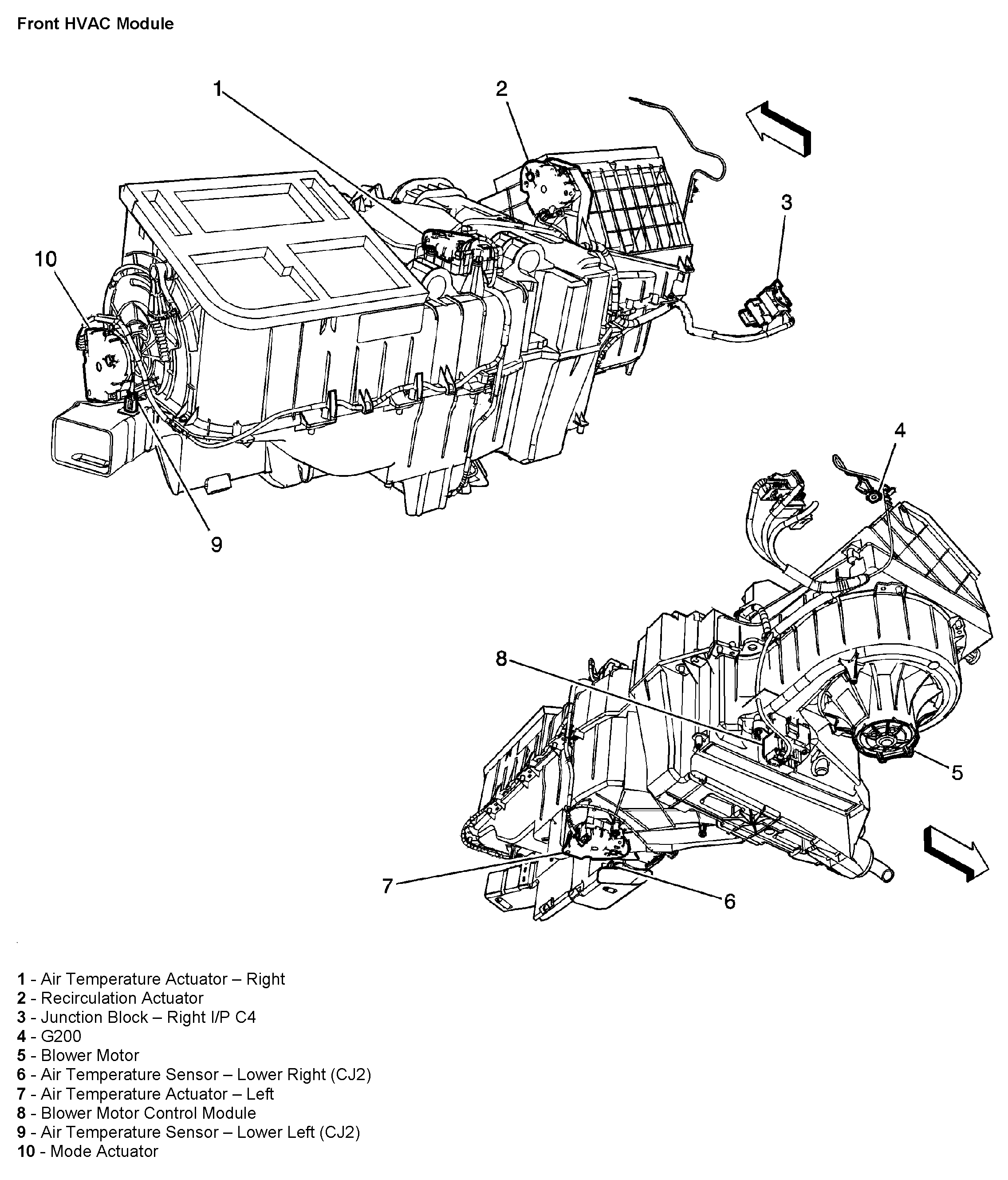

Replaced A/C compressor and still not engaging. Took to the shop said it was the EVAP temperature sensor, but I cannot seem to find the location.
Aug 1, 2018 at 1:33 PM
  • 110,194 POSTS
Something tells me you are not going to like this, but here it is. Most EVAP sensors are screwed into the AC condenser or the HVAC box which means most of the dash has to come out to access the condenser.

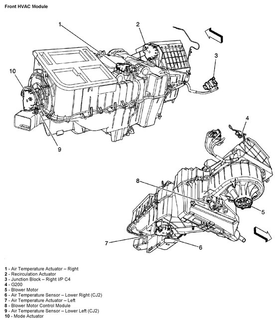

I have searched high and low for a picture from my manuals, but cannot seem to find one. I did attach a picture of the HVAC box which I hope can help.
