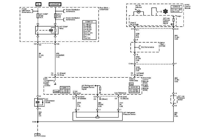

Hi, I have been having trouble trying to find out what is going on with my A/C. I just recently changed the quick connect on the anti freeze line for the heater. And doing so when I took off from my house my A/C worked fine. But I got a burnt wire smell in my A/C and when I stopped to take a look I saw nothing. When I started my truck up again I was not getting as cold of A/C that I usually get. So I took the truck back home and I saw my compressor was powering on and off still and it was cooling my Freon line. But the next day on my way to work I got that wire smell again. I am not sure if it was a wire or a relay but something burned out because now my compressor does not engage and I was told that I have no power to the compressor either anymore.

Well I bypassed the A/C to see if the compressor started up and nothing. So I checked the wiring and the green wire that goes to the compressor does not have any power to it.

Okay, the first thing you need to check is for power to the compressor relay. It is in the fuse box under the hood. Remove the relay and test for two powers with the key on.

If you look at the diagram, there are two fuses that need to be checked for power on both sides.

Okay the IGN-E fuse is good and so is the A/C COMP fuse, but on the compressor relay 87 and 85 are not lighting up.

Need power to 30.
Did you verify power across the fuses? Use a test light or voltmeter.

Check both sides of the fuse. Need to verify power through the fuse.
If there is power on both sides, then you have a wiring issue between the fuse block and the relay. The powers for the relay come from the fuse box.

On those two fuses I tested both sides turned on.
Thursday, May 24th, 2018 AT 4:08 PM
  • 52,797 POSTS
Okay, if you have no powers to the relay, then the wiring is open between the fuse box and the relay.
You will need to inspect the harness for any damage or burning.

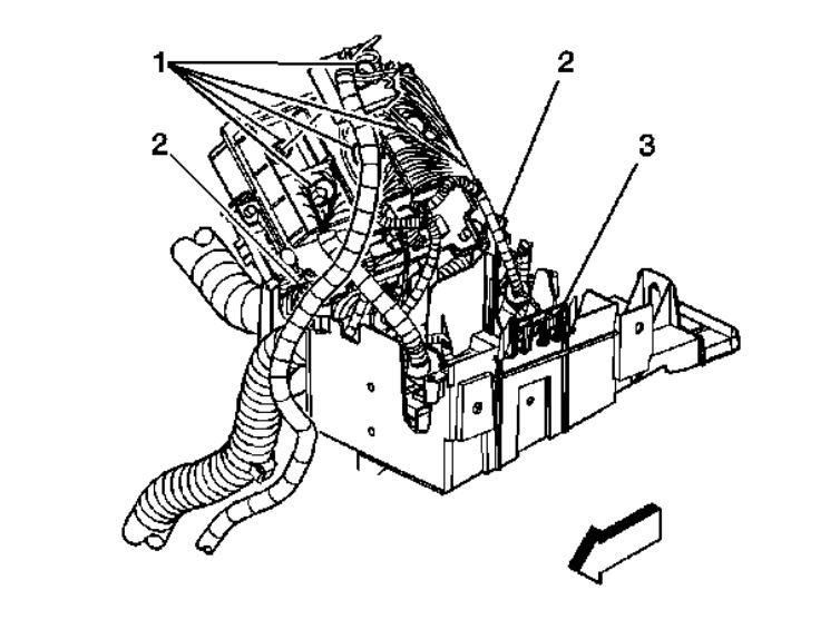

How do you take off the fuse box?

Procedure below and picture attached.
REMOVAL PROCEDURE
1. Disconnect the negative battery cable.
ImageZoom/Print
2. Remove the left fender upper brace.
ImageZoom/Print
3. Remove the electrical center brace cover assemble by lifting the cover (3) outwards to clear the tabs.
4. Remove all fuses and relays.
ImageZoom/Print
5. Push on the tab (3) so that the electrical center can be rotated on the studs located at (2).
6. Remove all connectors by removing the bolt (1) for each connector.
7. Disconnect all connectors from the electrical center block.
ImageZoom/Print
8. Push on the tabs (2) in order to lift the electrical center (1) out of the housing.
ImageZoom/Print
9. To replace the engine electrical center bracket remove the 4 retaining bolts (1).
10. Remove the engine electrical center bracket assembly from the fender.
