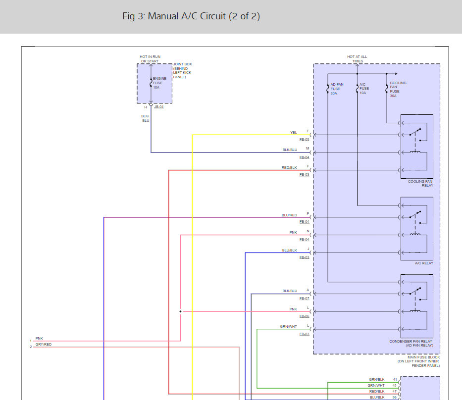

The AC clutch will engage if I run twelve volts directly from battery to clutch wire. Also, when this is done the condenser fan is not running. Fan can be made to work if twelve volt power is applied to connector.

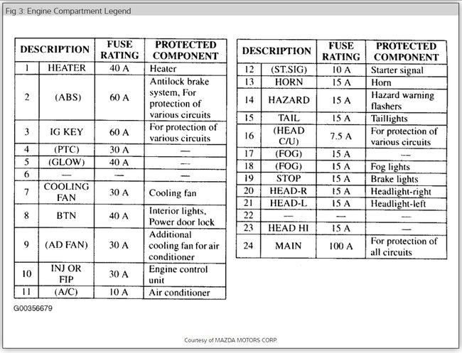

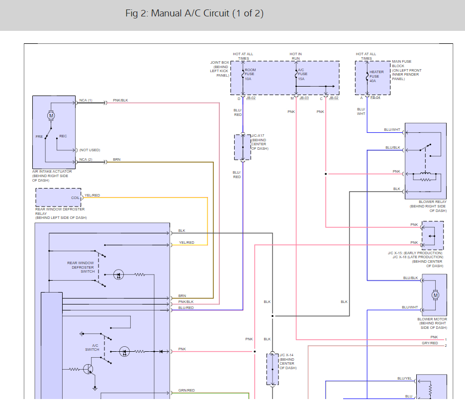

If the switch has continuity then the system has sufficient pressure to turn on. we must be losing power somewhere.

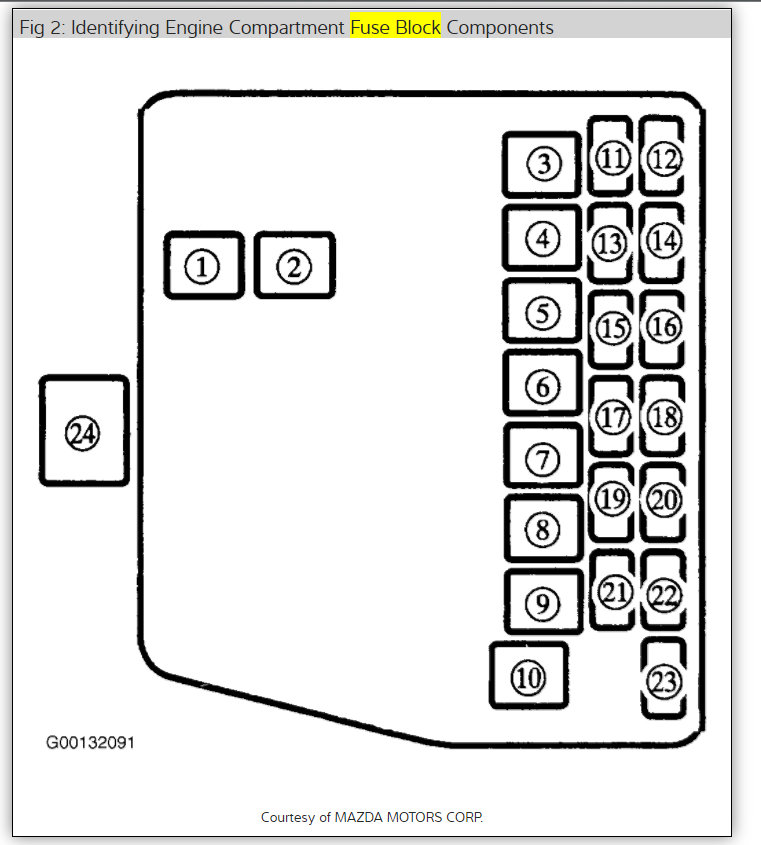

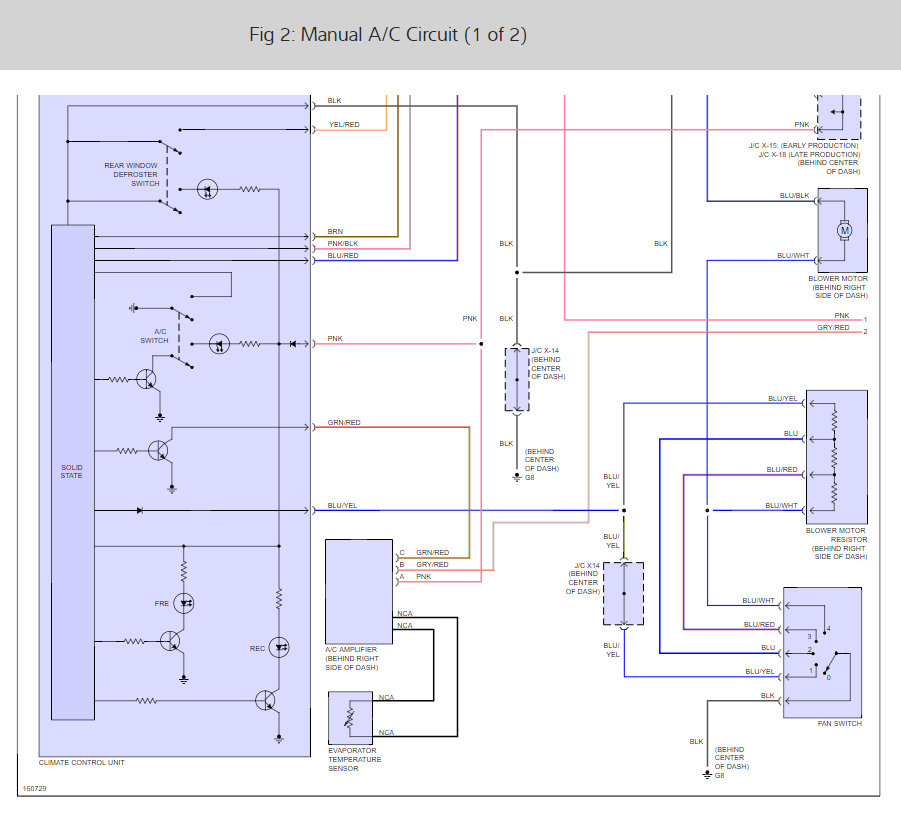

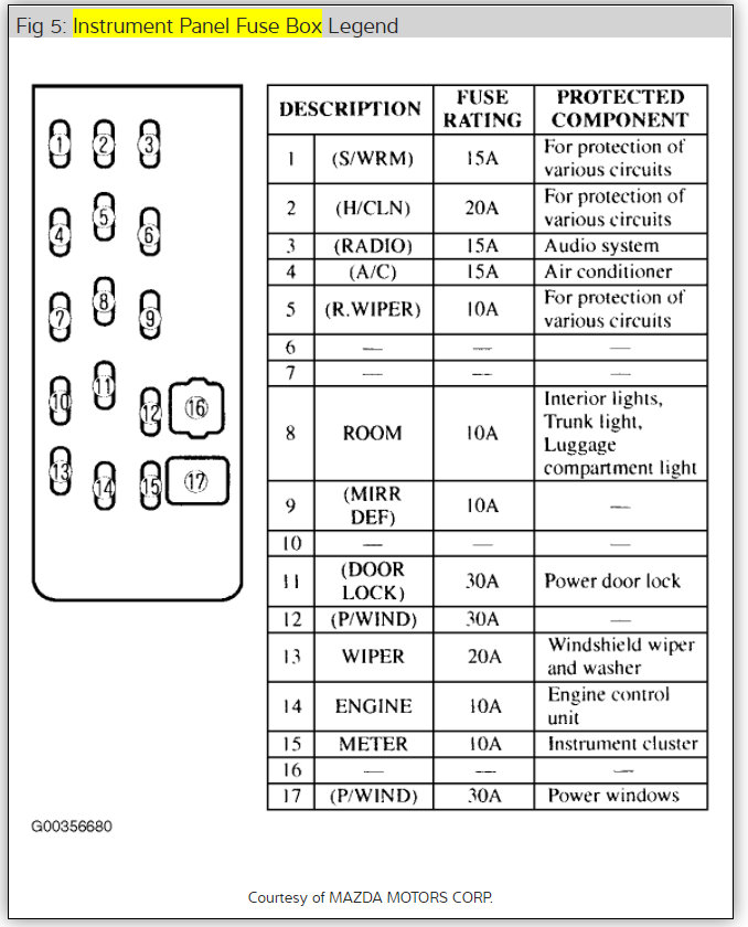

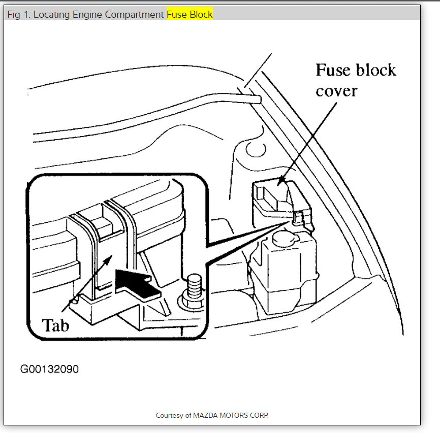

Here is a guide and a wiring diagram of the air conditioner system and the locations of the fuses and relays:
Monday, January 29th, 2018 AT 11:39 AM
57 HANDYMAN
  • 8 POSTS
Hello Ken,

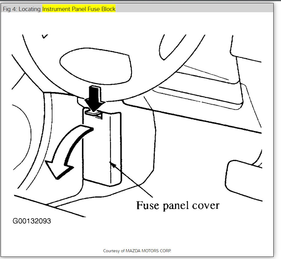

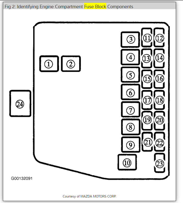

Thank you for responding and providing diagrams along with your guidance on what/how to address them. I appreciate the information. I must say that I have been doing a lot of online research to resolve this matter. Initially, I found guidance to examine all fuses and relays but was not able to find a blown fuse nor relay; I will redo with your diagrams. I did find a reference to relays in the engine compartment fuse box. I did swap the AC relay with headlight and horn but there was no change AC clutch nor condenser fan engaged.

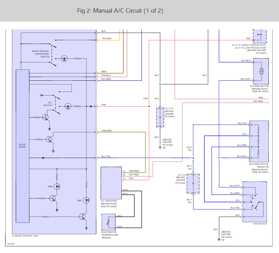

On a Protege site, I also found a reference to a switch on the dash that plays a role in controlling the cabin fan as well as the compressor clutch. They pointed to a sensor wire in that circuit and their recommendation is to install resistors which shifts fan and clutch control voltages from position #1 to #3.
I will do your recommendations and get back to you shortly. Again, thank you for your assistance.

Follow-up/update: I used the diagrams and listings to check the fuses and relays; all were good. In order to make sure the pressures were up to speed, I redid vacuum of the AC system and drew a vacuum of 22 pounds which held.

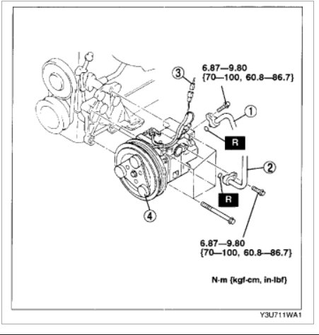

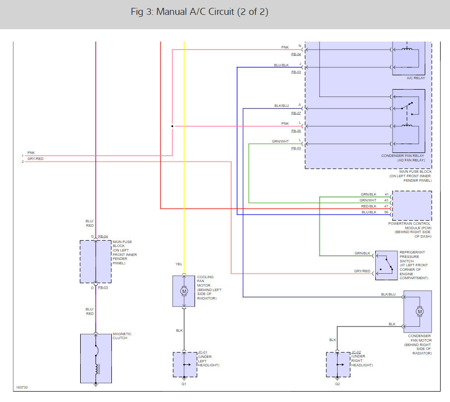

It sounds like you have a compressor with seals that are bad not pumping pressure. 100 pounds for the low side is too high but it is to be expected with a bad compressor. Also the condenser fan is controlled by high side pressure which never gets high enough to turn the fan on.
Here are two guides to help us get the problem fixed.
https://www.2carpros.com/articles/replace-air-conditioner-compressor

Just an update: I did install the sensing wire circuit (which consisted of two resistors) in the dash center console but it didn't make any difference. The initial conditions still remain: neither AC clutch nor condenser fan will run. As a result, I am not able to recharge the R134a to an acceptable. Do both the AC clutch and fan have to be running at the same time? Also, where in the refrigerant lines would a blockage most likely exist? I am thinking that would like be at the expansion valve or orifice.

FYI, I just happen to have two compressors and have swapped them out. The reason for swapping them was I suspected the clutch was bad. I should have jumped the clutch PRIOR to doing the swap. The initial compressor is back in place now. One observation that I have made is with the AC compressor clutch "jumped" and running, the high side connector and aluminum hose get very hot. Isn't that heat a result of the compressor doing its job?
Yesterday, I did do some spark tracing with a test light and was able to detect current at the 30A and 10A fuses, associated with the AC condenser fan. Also, while checking the Refrigerant Pressure Switch, for some reason, the radiator cooling fan would start up whenever I probed one side of the connector (red/gray wire). The test light was connected to ground. I was not able to check the two 30A relay plugs since in order to detect current, I believe there needs to be power to one of the two sets of terminals which closes the relay. According to a schematic I have, both the AC clutch and the fan condenser are connected to the PCM which controls energizing the two relays for these components.
This whole no AC situation started when I did some work on the radio for my son. Prior to removing the radio, the AC worked fine; unfortunately, after fiddling with the radio, now the AC doesn't work. As a result, I have focused on the electrical circuits in the cabin because I did remove the center dash face plate where the AC controls are.
Thanks for you assistance, Ken.
Tuesday, February 6th, 2018 AT 2:05 PM
KEN L
  • MASTER CERTIFIED MECHANIC
  • 54,280 POSTS
Hmm, good info to have, I would remove the radio and recheck your work. The heat of the AC lines means the system is working.
Use the wiring diagram I gave you above to see where you are losing connection.
