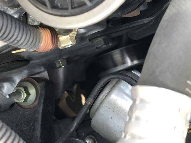

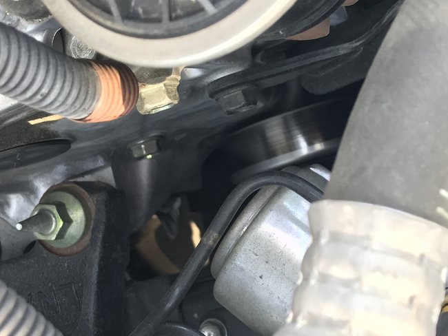

Here's a video of the car when the air is running
May 12, 2017 at 5:13 PM
SEAN WILLIAMS
  • 11 POSTS
Ok sorry I couldn't upload the video they were pictures.
May 12, 2017 at 5:17 PM
SEAN WILLIAMS
  • 11 POSTS
If I took pictures of the right thing, it was spinning
May 12, 2017 at 5:44 PM
SATURNTECH9
  • 30,869 POSTS
I can't figure out your supposed to be taking a picture of?I don't see the a.c. clutch in the picture.Id it's stalling with the a.c. compressor on the a.c. clutch is failing compressor is failing or the a.c. system pressure is getting way too high
