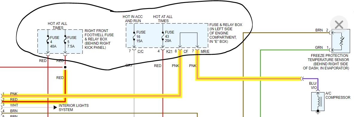

My A/C was working fine, and then one night my dash lights went out. I found out that fuse 44 had blown (it's also connected to the aux recirculating fan, which I found had a leak, I've ordered another one). However the A/C is not blowing cold, and from what I have read, the aux pump, has nothing to do with A/C. Any suggestions?

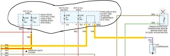

Have you checked fuses related to the AC? Have you checked for power at the compressor? I attached a portion of the wiring schematic. I need you to check the fuses I circled, especially fuses 4 and 5. They direct power to the instrument cluster and the module control behind the dash.
Check those and let me know. Also, if you can check for power to the compressor, it would be helpful.
