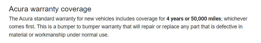

Since the vehicle has such low mileage, have you contacted a dealer to see if they can repair it under warranty? See pic below.
Let me know what you find or if I can help.
See pic below.

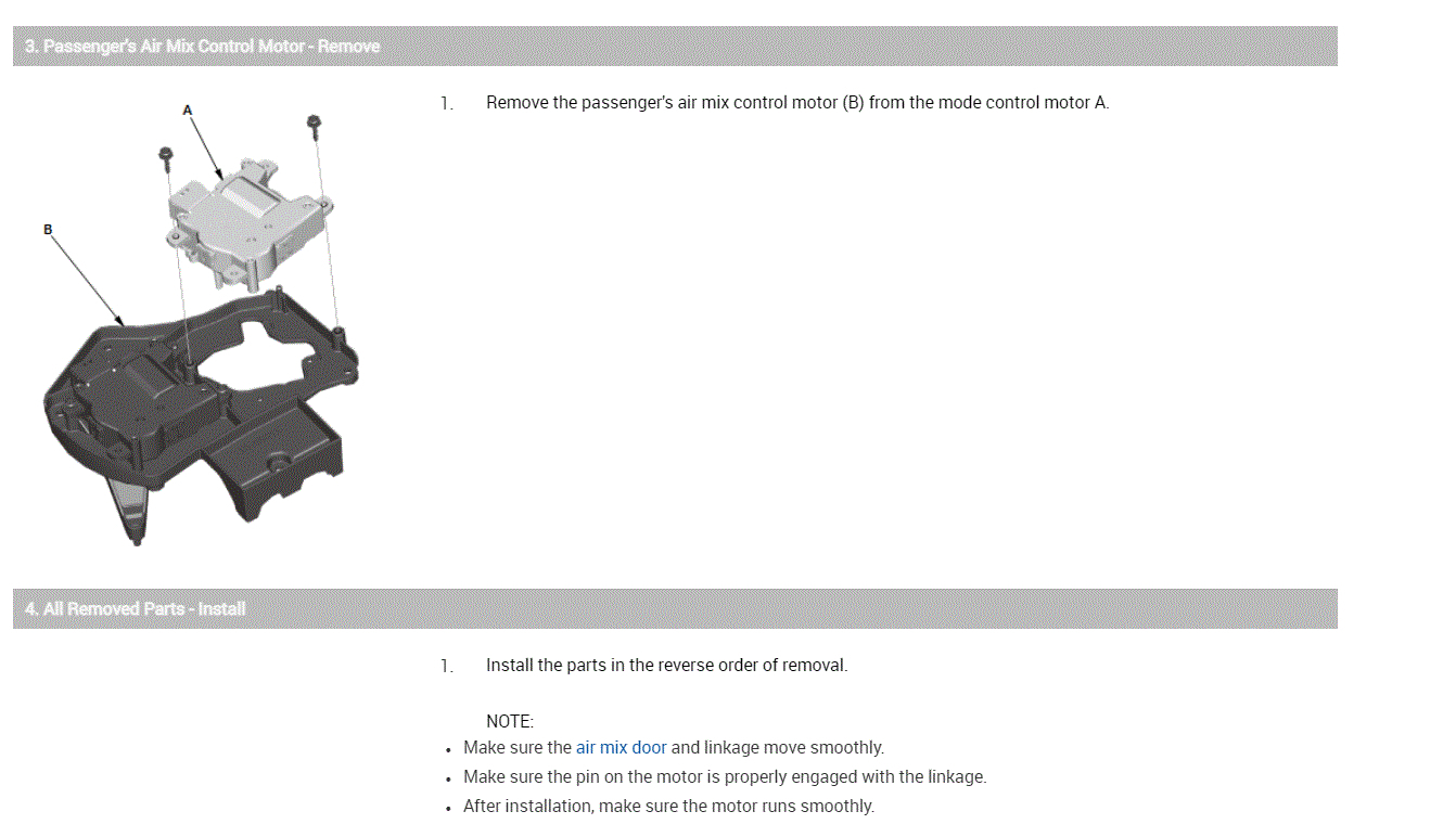

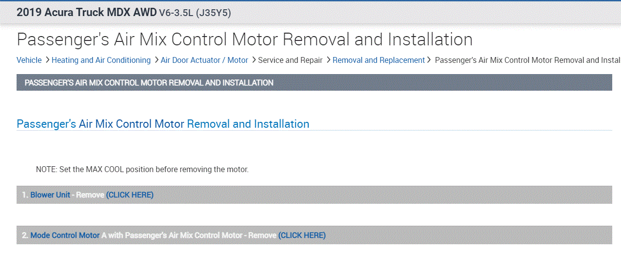

Do you have any control over the temperature entering the vehicle? For example, does the heater work?
If not, I would remove the air mix door actuator motor and confirm it is operating and the linkage to it is properly attached and not binding.
I attached the directions for the passenger side mix air door motor removal. Consider removing it and checking to see if it is operating properly when you change temperatures. When it is removed, it should be in the max cool position. Make sure the system is also in the max cool position when reinstalling it.
See pics below. Note: I am basing this on the AC compressor turning on. Also, this should be under the manufacturer's warranty. You may want a dealer to check what is happening. It isn't making sense to me. It would be odd for both actuators to fail at the same time and the compressor is working.
