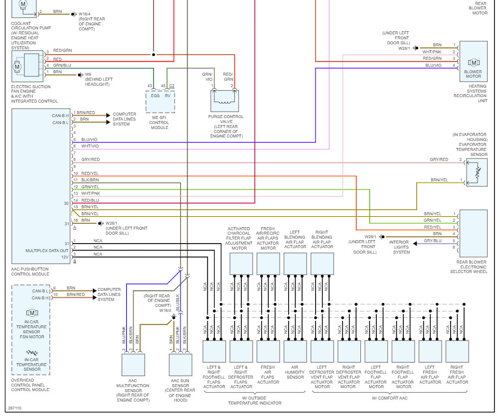

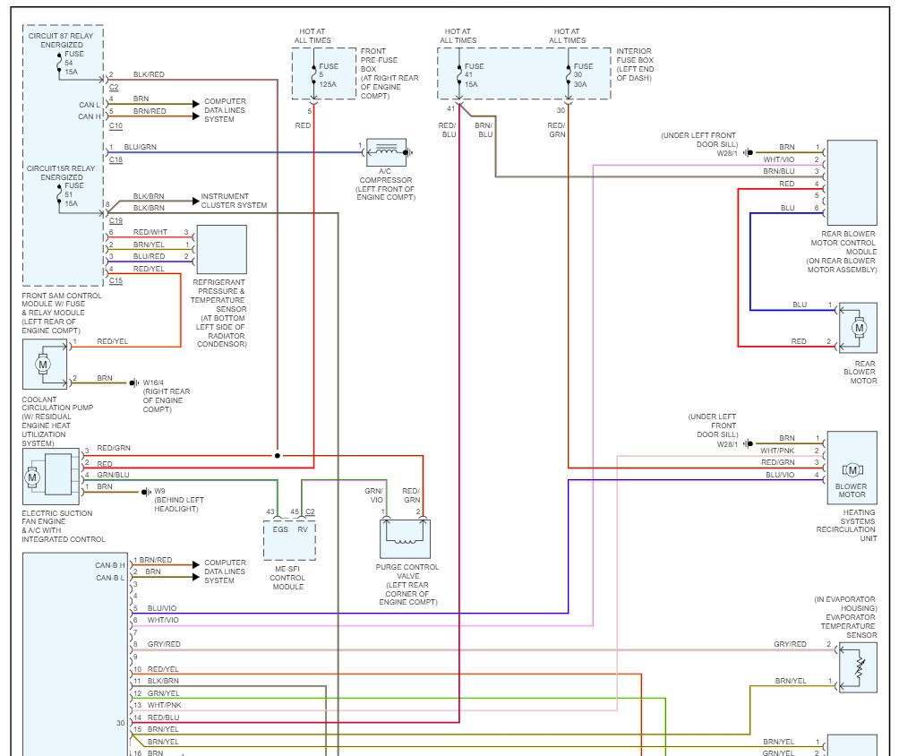

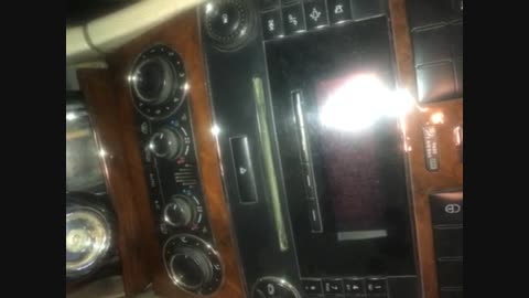

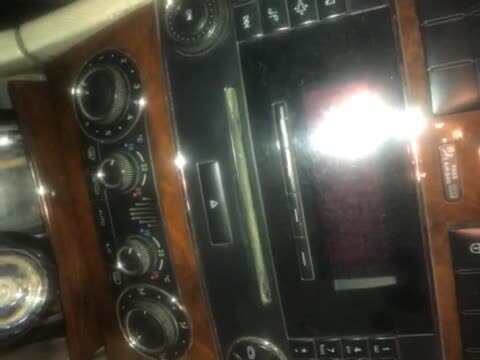

Hi dear,
As I have two identical Mercedes Benz, I took the van and tried it in the other car, and it was working so I took the climate control switch, and it was working too. All fuses look okay but they’re still not blowing air. waiting for a solution.
Thank you
Sep 22, 2023 at 9:04 PM
  • 55,694 POSTS
Yep, the main power wire and connector can burn in these cars so I would look at that first. Here are the blower motor wiring diagrams so you can see how the system works and this guide can help you test for power and ground at the blower motor to help confirm the failure:
https://www.2carpros.com/articles/blower-fan-motor-works-on-high-speed-only
Please check fuse #30 in the fuse panel at the left side of the dash.

You answered my question thank you very much and it was a power fuse problem. The one on the left-hand side of the dashboard and it is now working but another problem appeared.
