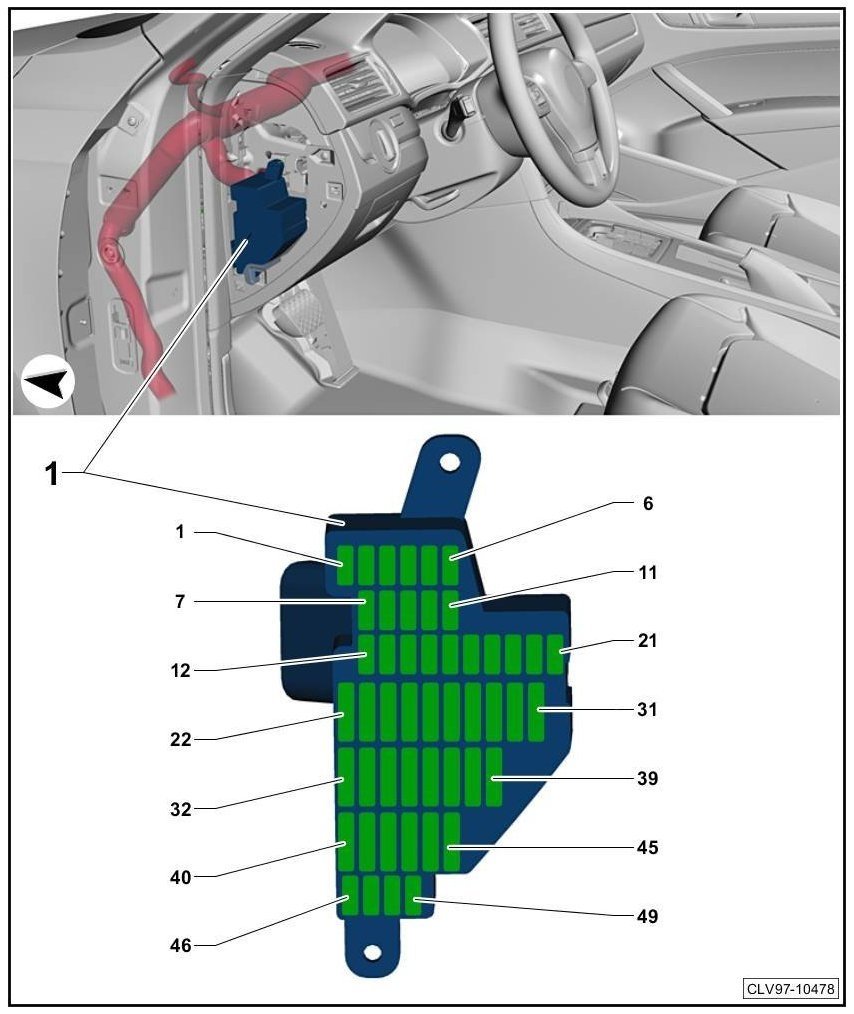

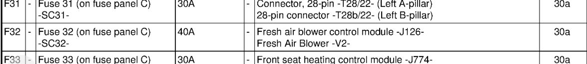

Also, confirm that fuse 32 is good under the dash in the fuse panel. See pics for details.
