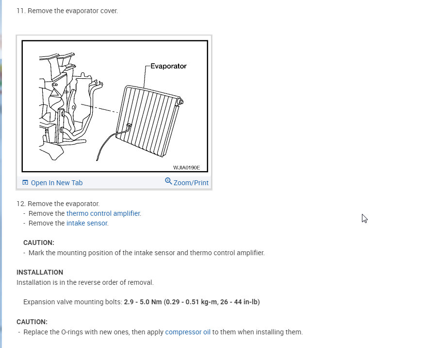

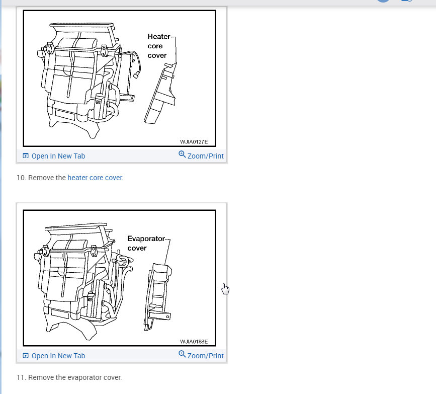

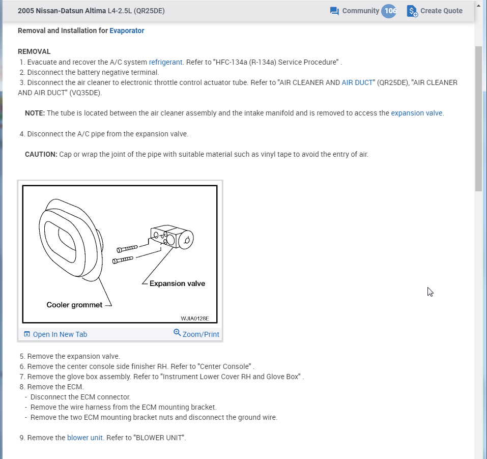

my A/C it leaks inside on the passenger side I need to replace the evaporator.
Jun 7, 2020 at 3:06 PM
Clearly I am not looking at the vehicle but this is almost guaranteed to be the evaporator core is leaking. This is the component that is inside the HVAC housing that actually cools the air before it enters the passenger compartment.
Take a look the repair documents and if you have questions. I would at least gain access to it and look for it to be leaking but I am sure this is the issue.
Let us know what you find. Thanks
