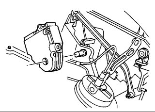

Left van setting two minutes battery off, now A/C warm compressor turns, pressure okay. bit warm air only. fuses okay, low pressure, switch okay.
Oct 6, 2017 at 4:02 AM
STEVE W.
  • 15,349 POSTS

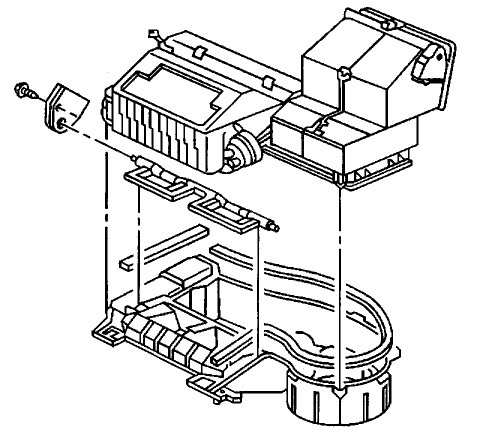

Sounds like either the blend door stuck or the actuator for it failed.
Remove the insulator panel above the drivers foot well. You will be able to see the blend actuator on the side of the HVAC case. Try adjusting the temp from hot-cold-hot and see if the stem moves. It probably isn't moving which means the actuator or the temp control is bad. The actuator comes off easily, Try moving the control stem by hand. Do you get hot/cold now? If yes the core and door are OK.
The actuator is the likely problem.
Oct 8, 2017 at 11:03 PM
PAP TCAR
Removed actuator it works any other ideas I haven't checked high pressure side low beside OK high side hard to get to but I'll check it maybe a blockage in expansion Valve. Thanks
