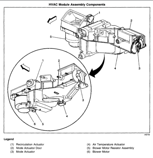

The A/C from the dash is blowing just air and the vents in the back second and third rows blow cold.
Mar 13, 2019 at 1:25 PM
DANNY L
  • 5,648 POSTS
Hello, I'm Danny.
It sounds like you are having a problem with the mode actuator.It is located on the HVAC unit under the dash on the right side. It's a small electrical motor that opens/closes a door to move air through specific air ducts. Here is a tutorial showing what is involved in its replacement:
These guides can help as well
https://youtu.be/uZrQCGwXfek
and
Please run down these guides and report back. I've attached a picture below showing what it looks like.Hope this helps and thanks for using 2CarPros.

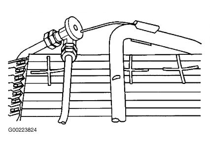

We changed a compressor now front AC is working but rear is not working. what are the steps we should follow. Please help
Jul 16, 2020 at 5:10 AM (Merged)
DOCFIXIT
  • 18,828 POSTS
HI Old compressor may have put debris in system and rear uses expansion valve which is pluged up not allowing freon to enter evaporator. see diagram
https://images.2carpros.com/forum/automotive_pictures/198357_Graphic_523.jpg
If valve blocked tube will ice up before valve. Hope this helps Thanks for donate

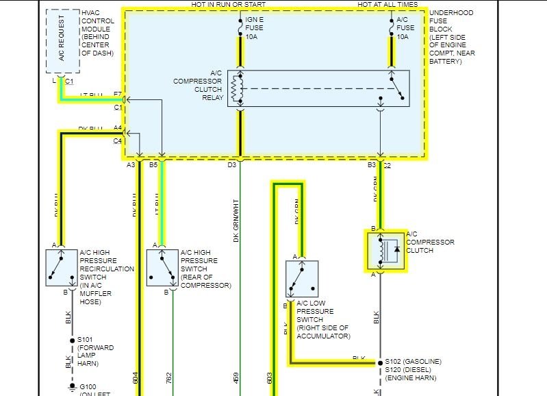

ESTEVAN52
Replaced A/C compressor, all fluid levels on point. It was working only for a day.
Low pressure switch has ground but no power, I tried jumping it with a paperclip but still did not engage.
Sensor connector behind compressor has no power nor ground.
Connector in front of A/C compressor has ground but no power.
Jumped 30 and 87 on relay post and still nothing .
Pin 87 has no ground and all ac fuses are good.
A/C controller in front replaced still no engaging.
Please help ! Thank you .
Jul 16, 2020 at 5:11 AM (Merged)

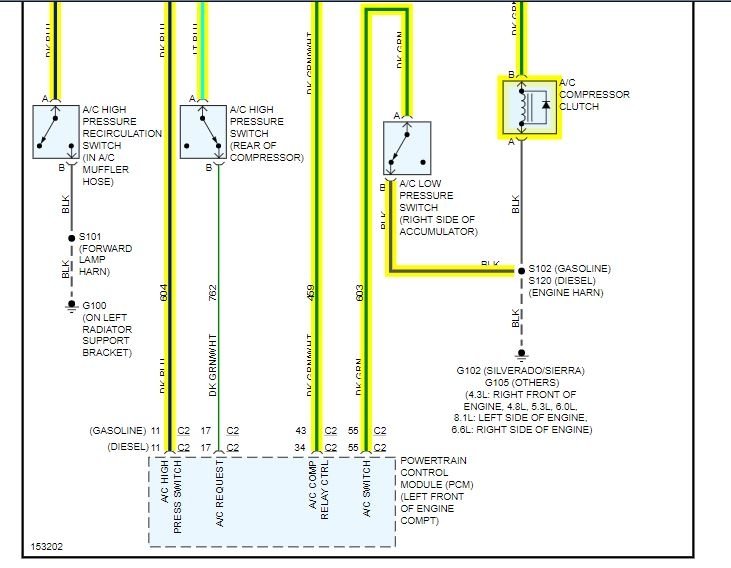

Good evening,
The low pressure switch and high pressure switches should have power with the key on.
The high pressure switch is a normally closed switch and the low side is a normally open switch unless there is greater than 20 pounds in the system.
I attached a wiring diagram for you to view.
Let us start with verifying power to the clutch relay. With the key on, there should be terminals with power. Pin 30 and 85.

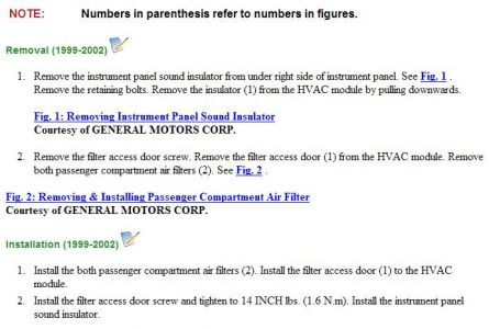

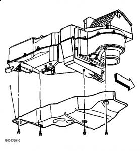

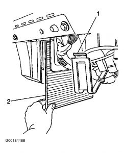

AC is blowing out pieces of filter. Where is the filter located?
Jul 16, 2020 at 5:14 AM (Merged)
BLUELIGHTNIN6
  • 16,542 POSTS
https://images.2carpros.com/forum/automotive_pictures/261618_Noname_730.jpg
https://images.2carpros.com/forum/automotive_pictures/261618_Graphic_93.jpg
https://images.2carpros.com/forum/automotive_pictures/261618_Graphic2_10.jpg
