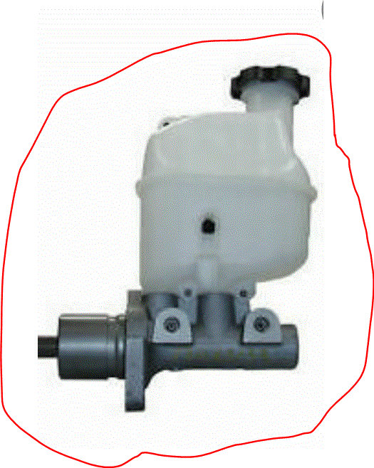

First, confirm the brake fluid is full in the brake fluid reservoir. See pic 1 below.
If it is full, chances are there is an issue with the wheel speed sensor. You can test this one of two ways.

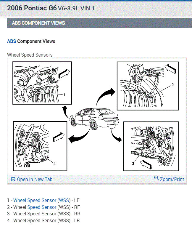

If you look at pic 2, it shows the locations.
Try this and let me know the results or if you have other questions.
