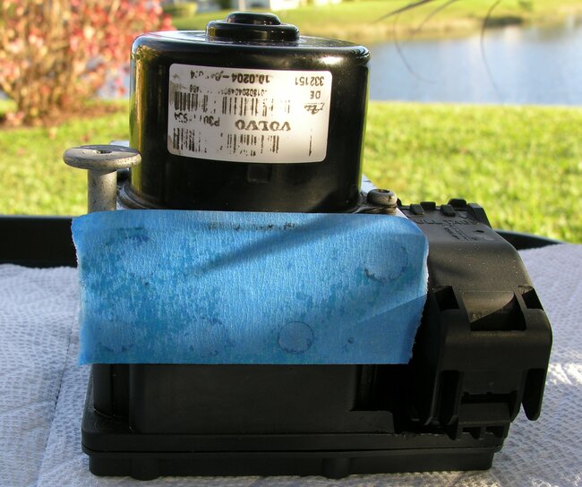

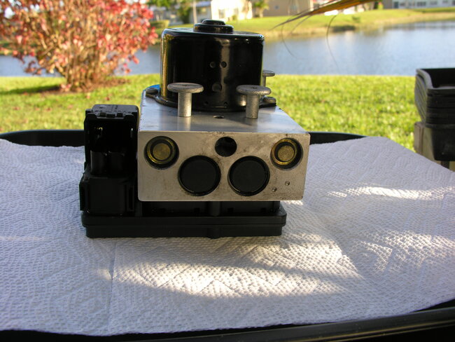

Here is a picture of the control module from the s60 that has all the same info save for a few numbers from the 05W number on it.

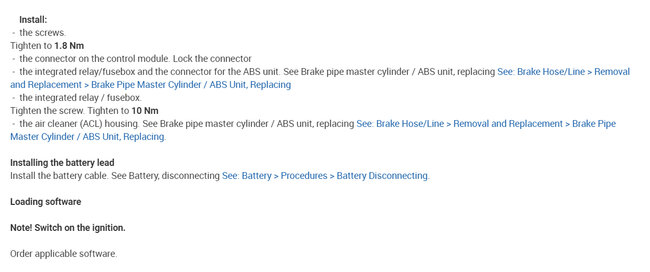

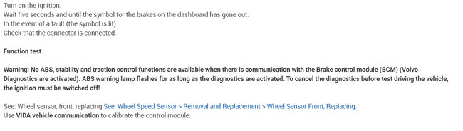

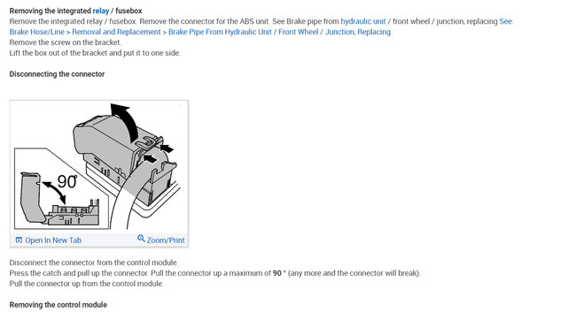

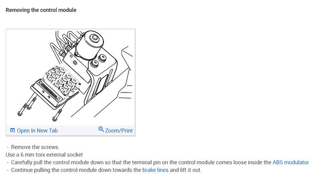

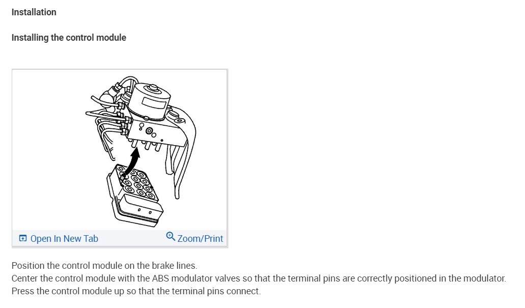

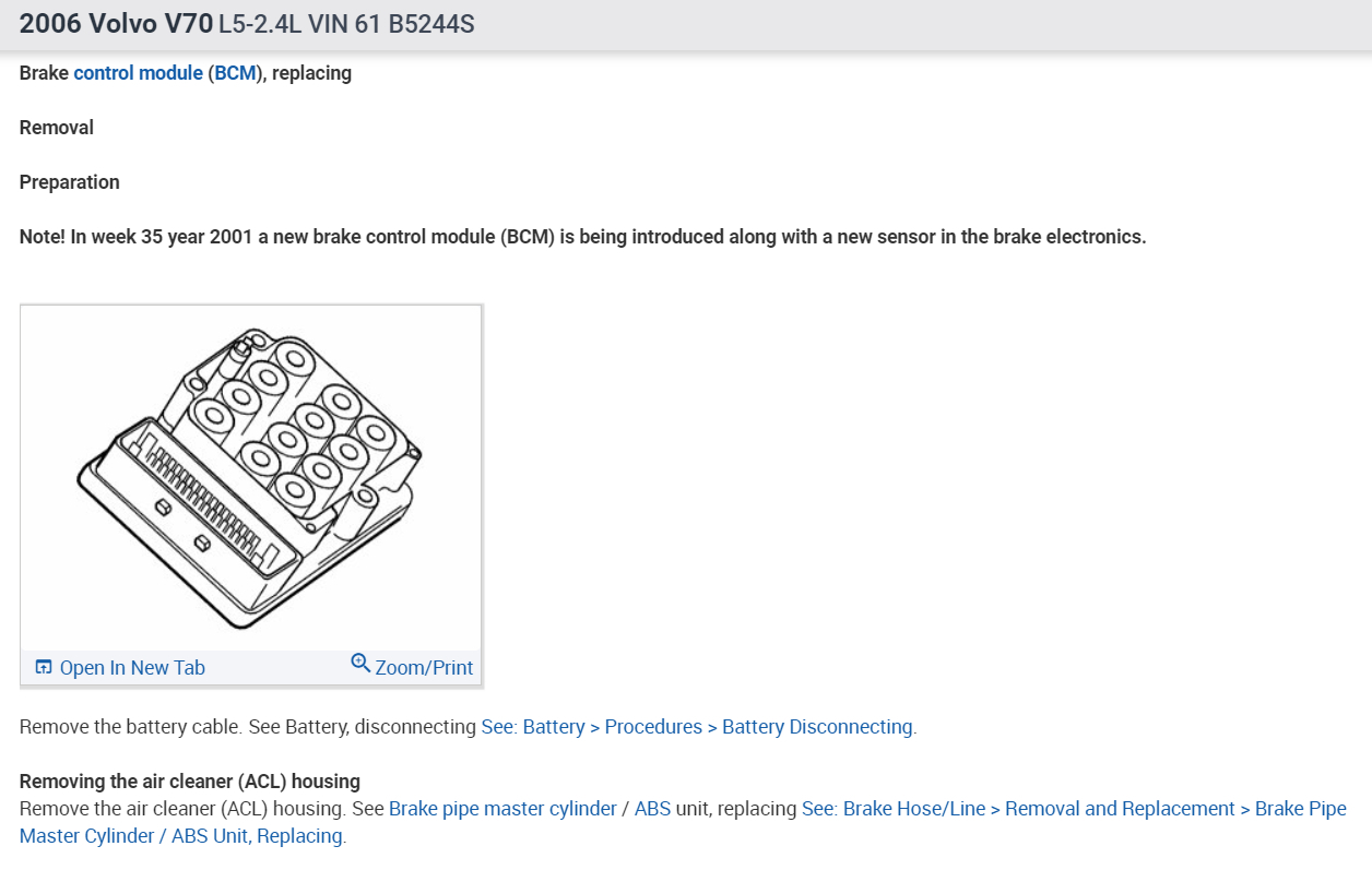

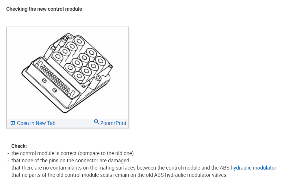

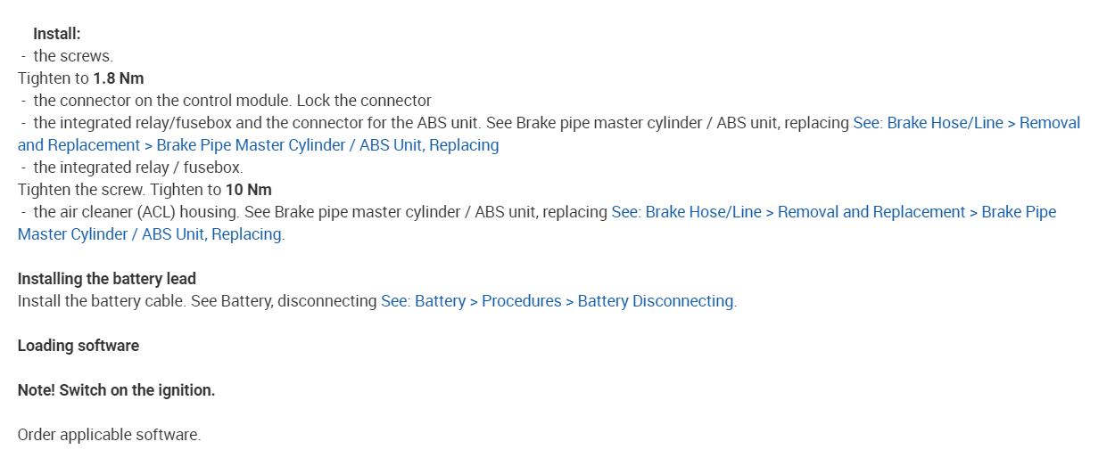

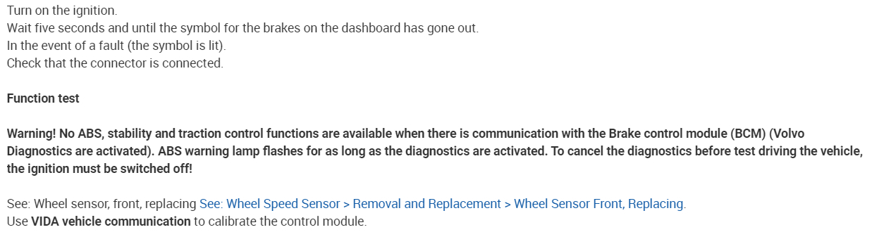

I do not see the images. Can you please reload them? If the system has fluid coming from the ABS unit, then I am thinking it is the rear brake flex hose that has collapsed internally. Can you undo the line at the front part of the hose to see if you have the same problem? Also, if the ABS valve unit looks the same from both units you can swap the existing module onto the new valve and motor unit, and you should be okay. Here are the ABS module replacement instructions in the images below for reference. Please let me know.

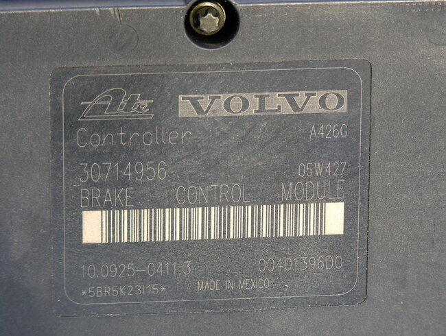

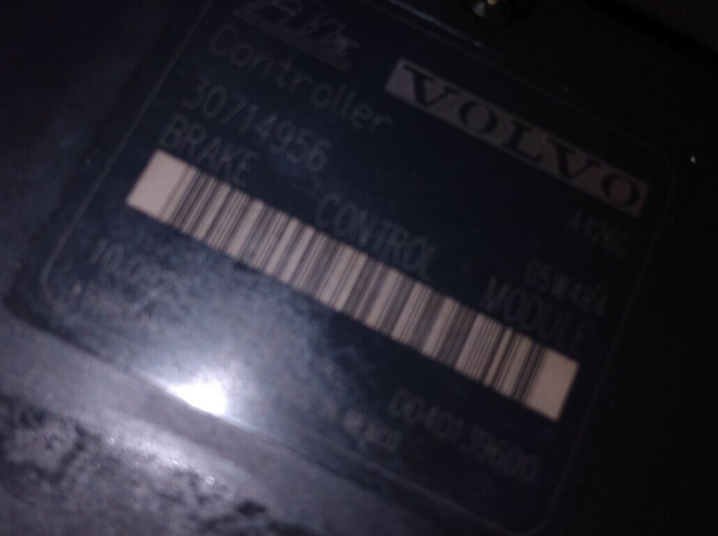

Here are the pictures of the s60 unit we took off the junk yard car

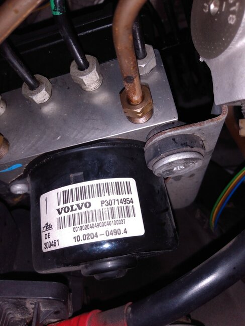

And the last picture was taken of our brake control module, which is not clear, as it is on the car and in very low light.
Otherwise our ABS unit looks the same as the s60 one does, including its condition.
Thank you so much for your help, i am so grateful!
Blessings and be well ~
Pictures 1, 2 and 4 are the S60 ABS unit,
Pictures 3 and 5 are OUR v70 ABS unit

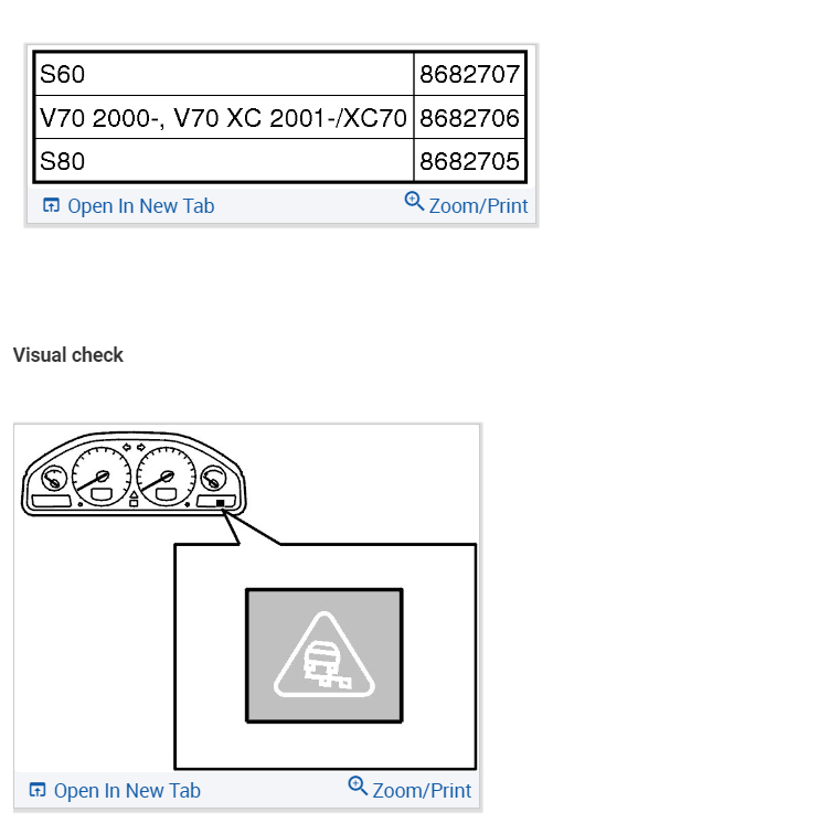

If the last to images are the tags for each ABS unit you might be okay because they are the same part number but a different version number, as far as doing permanent damage I don't think will happen, but if you are afraid of installing it don't do it and wait to get the OEM replacement part. There is no comprehensive part exchange protocol that will give us a definite yes or no answer on this type of problem. Do the electrical connections look the same? Usually when the plugs are different, they changed something in the system, FYI.
