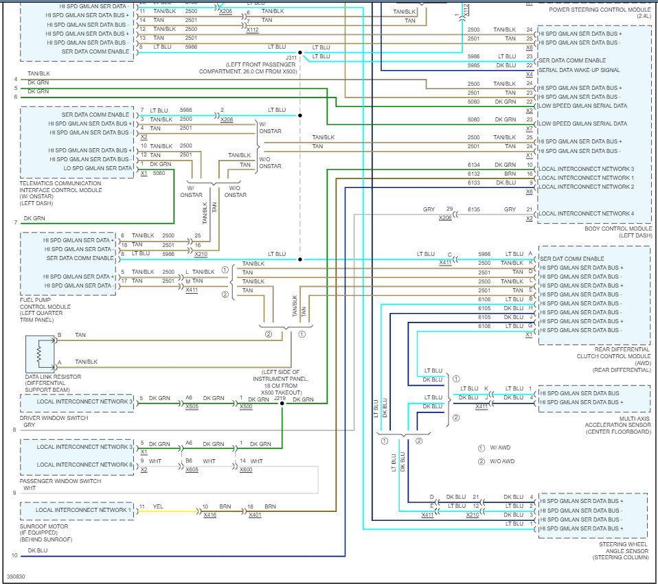

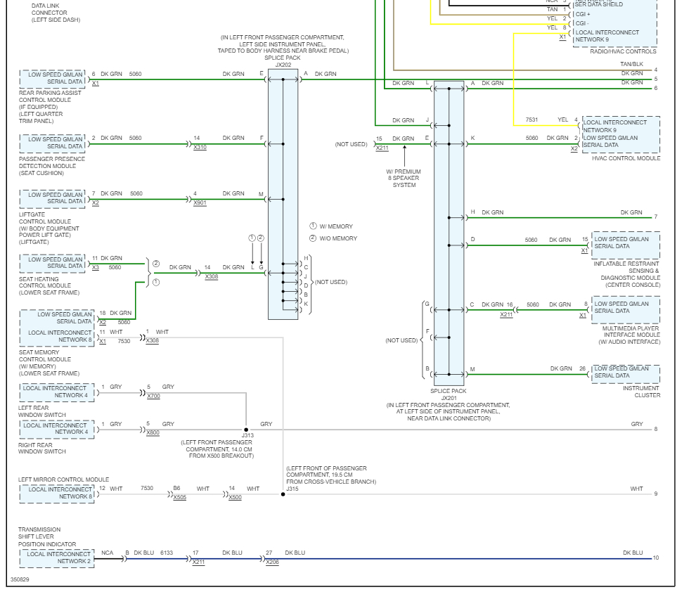

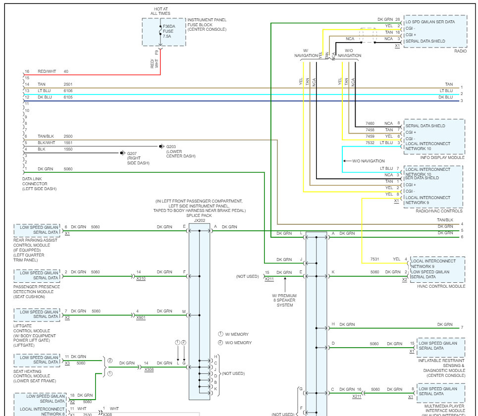

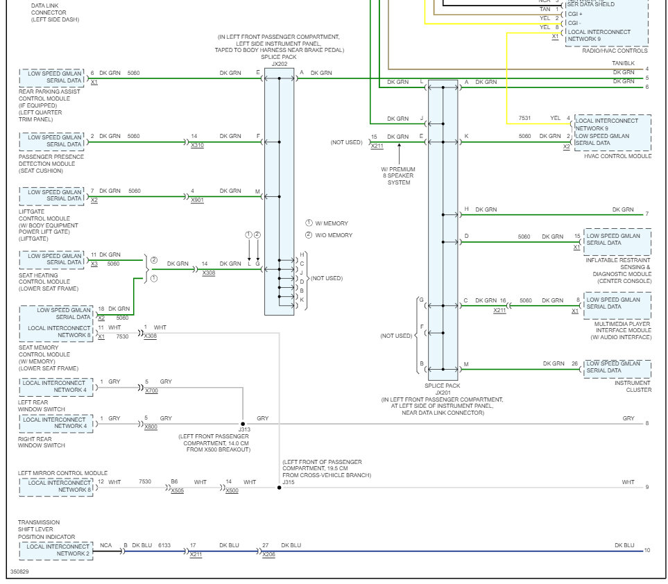

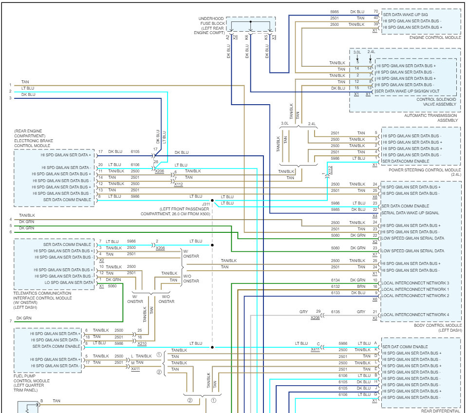

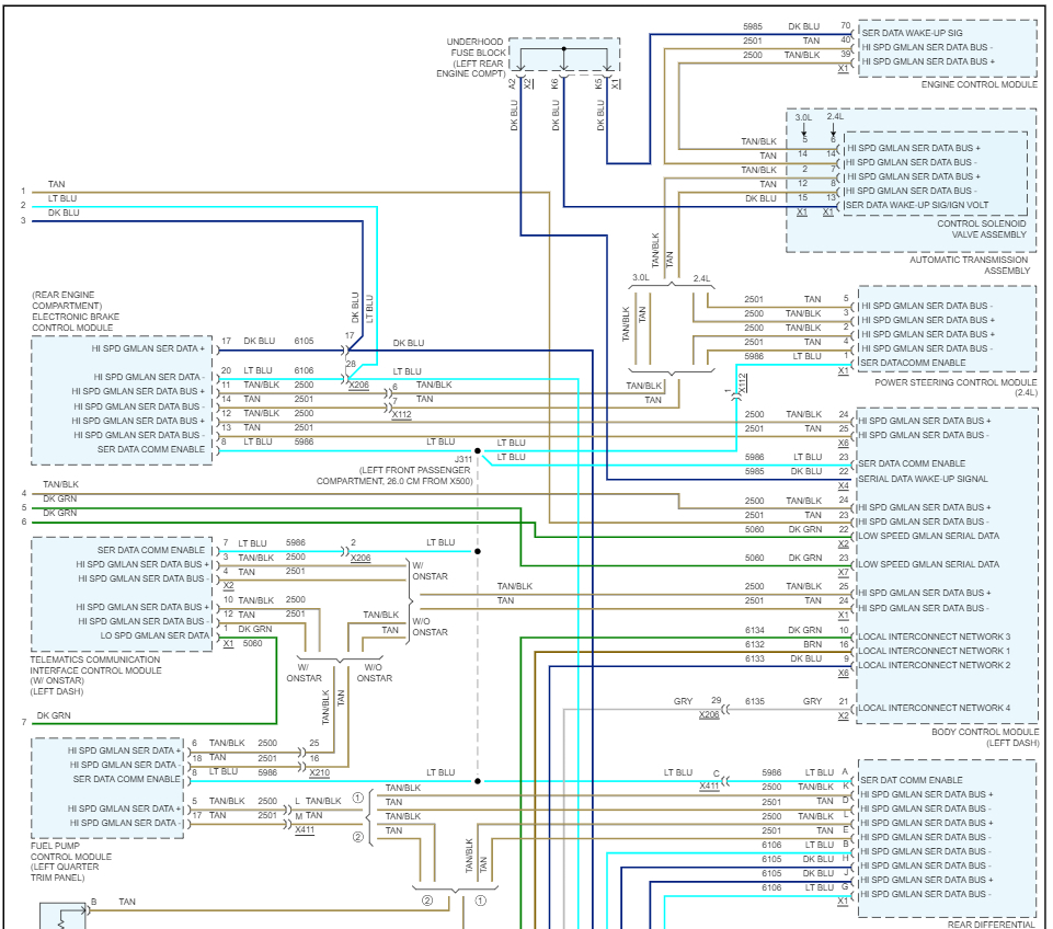

I would start by checking all fuses with the system on. I see there is a fuse F36DA 7.5 amp that helps run the CAN which is located on the interior fuse panel (center console). Here are the wiring diagrams for the CAN so you can see how the system works:

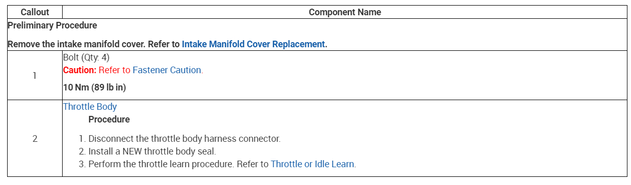

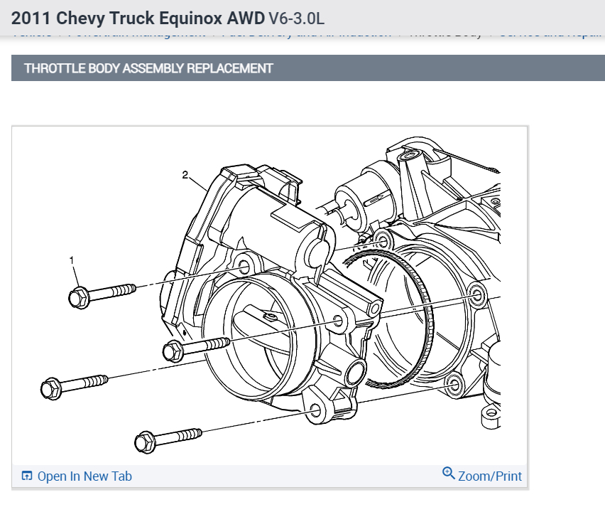

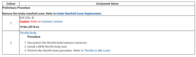

If the fuse is good, it could be either one, the PCM or EBCM. I would remove them both and have them tested. But I have seen a bad throttle body actuator cause the limp mode issue and it may affect the other modules as well. Though it does leave a code any glitch in the throttle system will cause limp mode.
P2138: This code points to a problem with the throttle/pedal position sensor/switch D/E voltage correlation.
C056D: This code indicates a problem with the electronic brake control module (EBCM) or the brake pressure sensor.
U010: This code refers to a communication problem with the transmission control module (TCM).

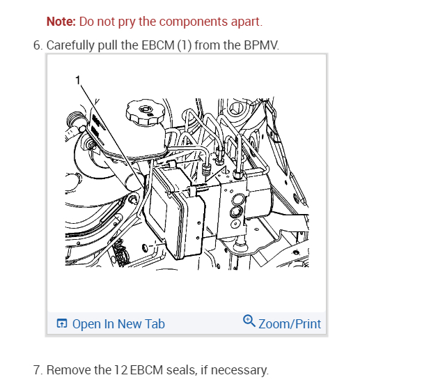

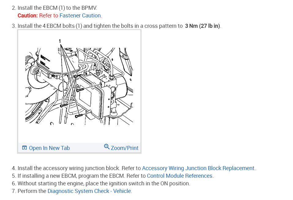

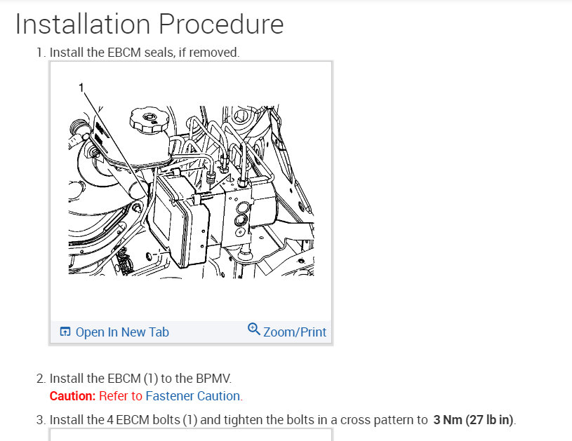

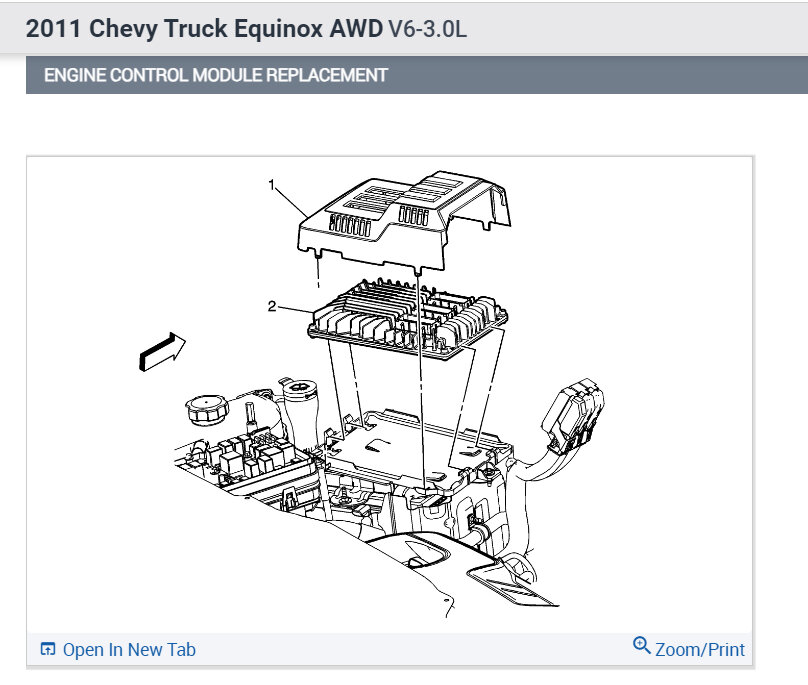

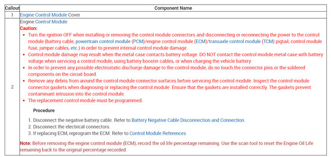

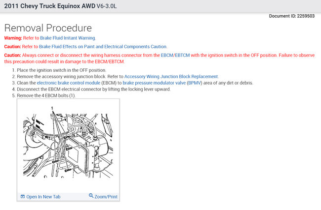

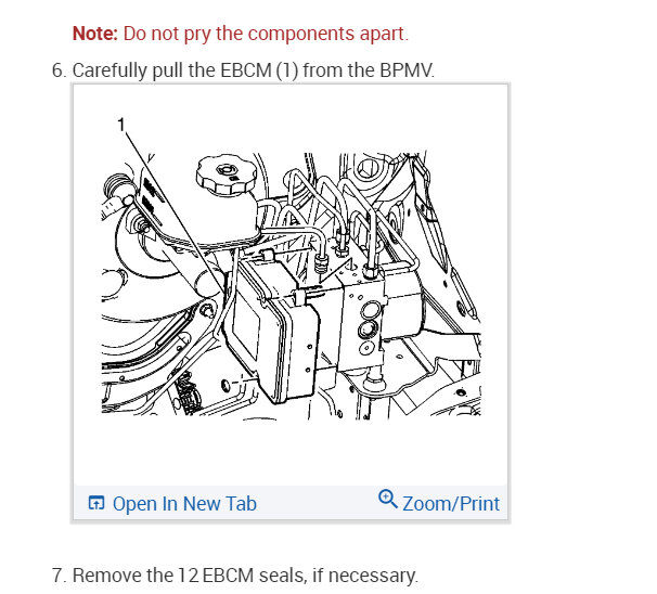

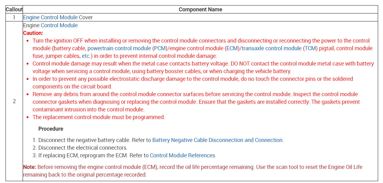

Here is how to change out the actuator and remove the PCM and EBCM. Check out the images (below). Please let us know how it goes
Jul 17, 2023 at 4:52 AM
AKRAFT22
Thank you for all your suggestions for resolving the issue. From the last posting, we did end up replacing the ECM. This resolved all the performance issues it was having are, poor idle, reduced power, etc. The only issue currently is that the Abs, Stability Trak, and brake lights are on the dash. The car has been driven and seems to run great and has not had any braking issues yet. The check engine light is not on, and we are not able to pull any default codes with a basic OBD scanner tool. We are assuming it now comes down to replacing the EBCM. Your thoughts and knowledge are greatly appreciated.
Aug 21, 2023 at 6:41 AM
  • 55,399 POSTS

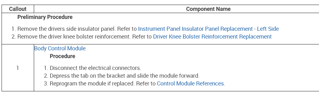

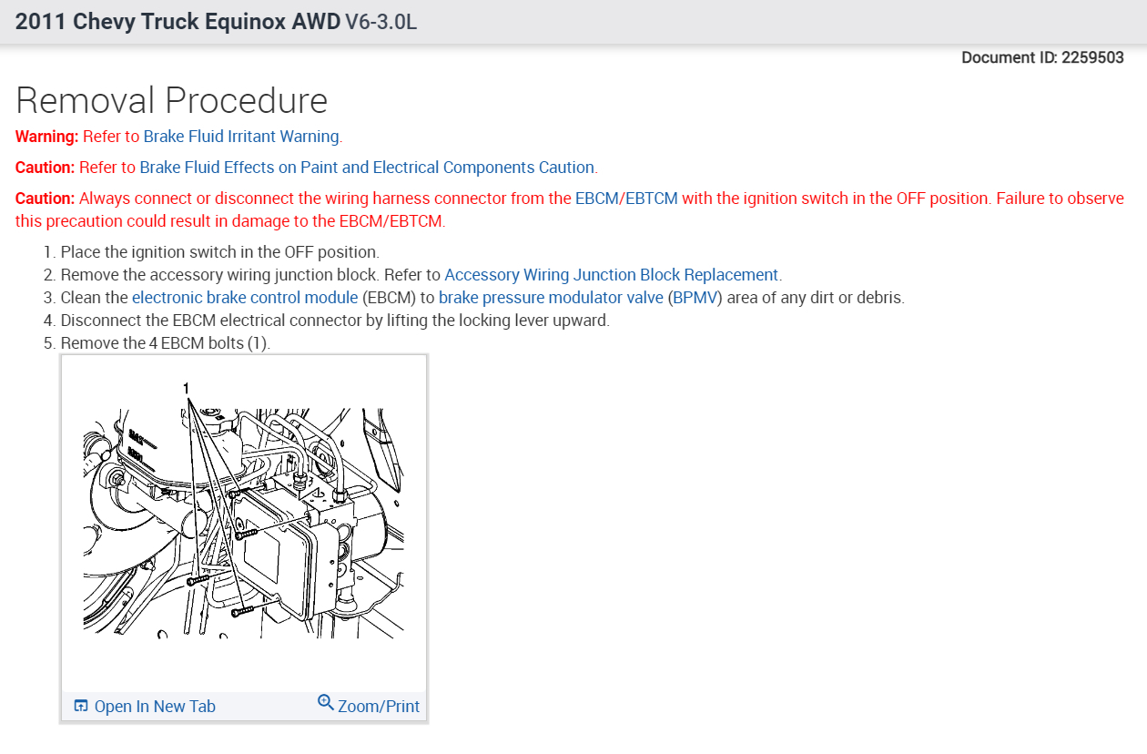

I would do a CAN scan to help confirm the issue. You can get a CAN scanner (Controller Area Network) which will work on most cars from Amazon.
https://youtu.be/u-4syLc-ifQ

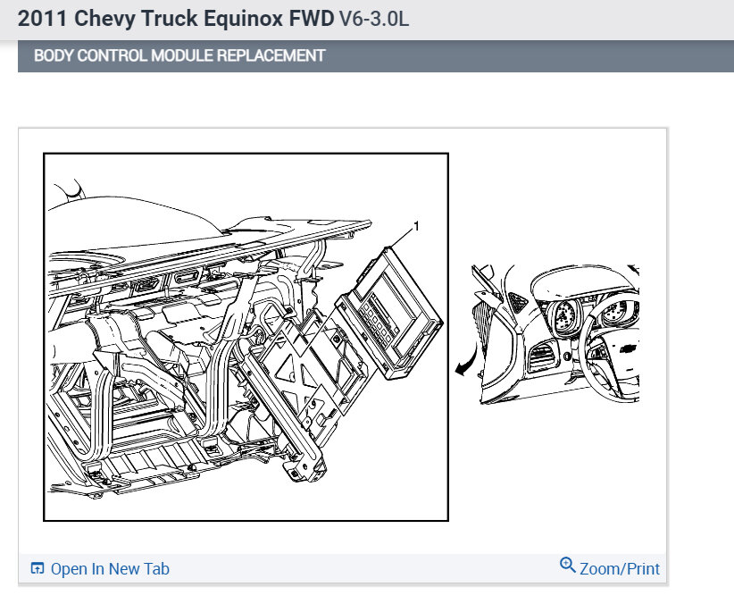

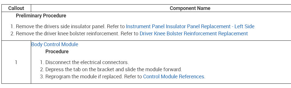

Here is how to change the BCM out, you can get a preprogrammed unit by searching Google or Ebay. Check out the images (below). Please let us know what happens.
