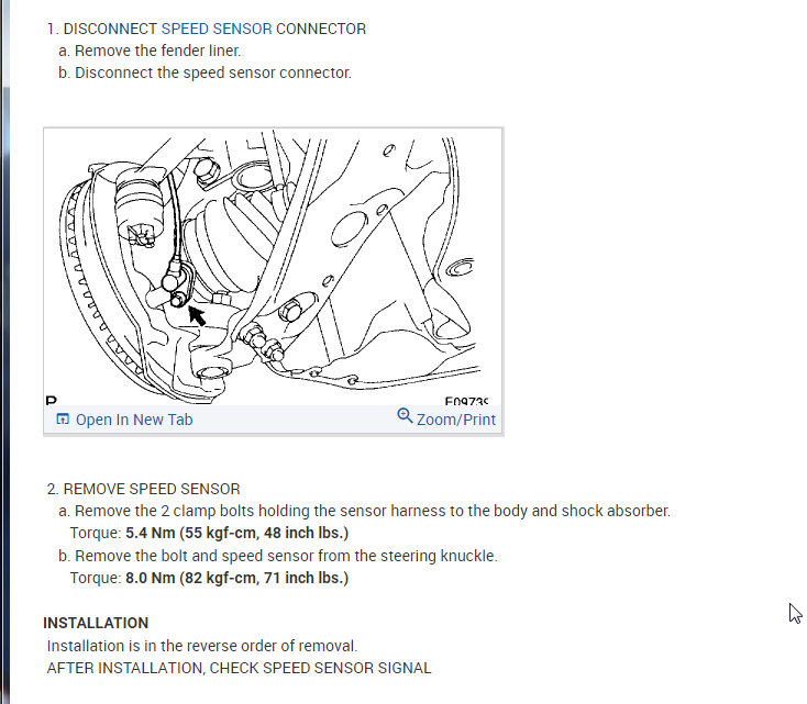

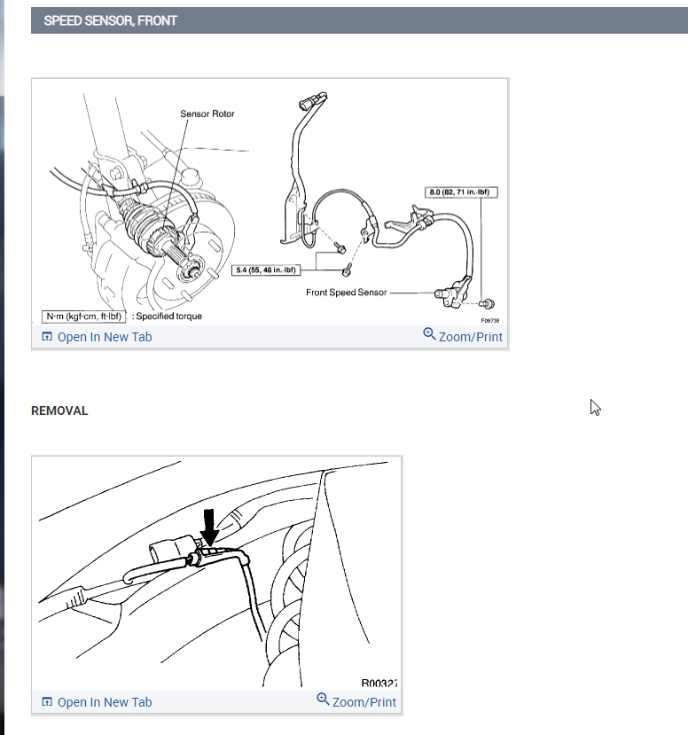

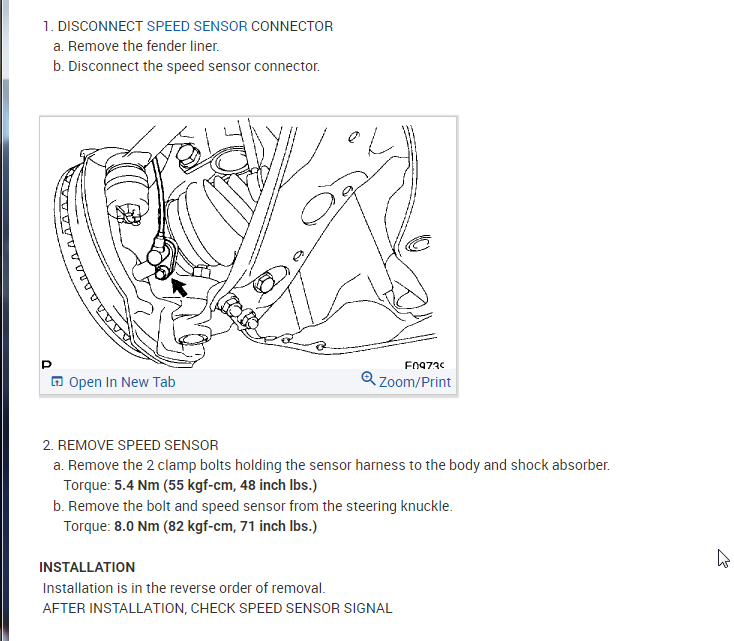

I had a tire burst sometime last week and it damaged to the right front wheel speed sensor cable. What was left was just a piece of cable hanging from the wheel sensor side and I cannot really locate where the cable came from or where the connector of the cable is. If I could find the cable route I could connect it back again since I am an electrical technician.

Here are a few guides that will help with this:
https://www.2carpros.com/articles/abs-wheel-speed-sensor-test
https://www.2carpros.com/articles/how-to-replace-an-abs-wheel-speed-sensor
Plus below is the process from the manual. Please run through this material and let me know if you have questions. Thanks

Hi. Thanks for the information. I did manage to locate the connections.
