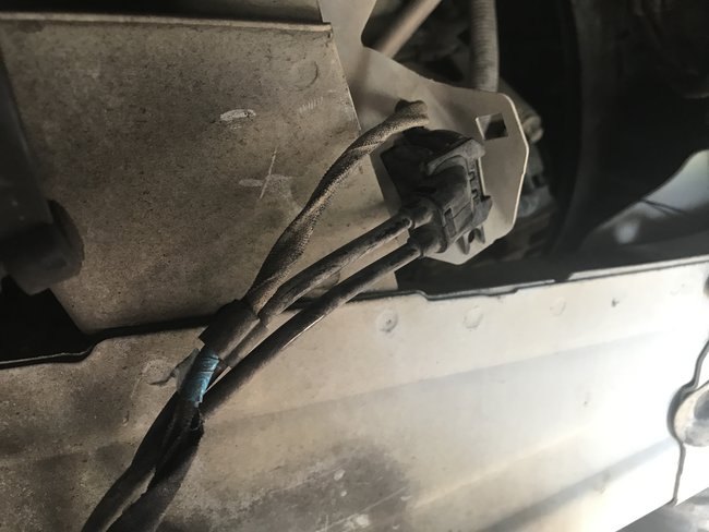

I have replaces 3 speed sensors when I got to the front passenger side the connector plug as 2 wires one is speed sensor the other is brake pad wear sensor. problem is, I can’t find the wire harness that has both wires connected to the same plug. Am I missing something?

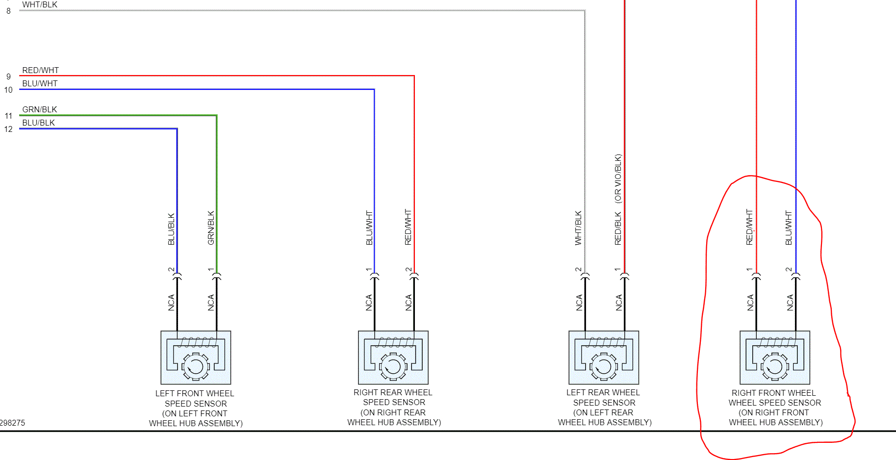

There isn't one plug for each. To the best of my knowledge, they are separate and the speed sensor connects at a small black box usually behind the strut assembly. I looked up the sensor wiring, and it shows it going to the control module.
Is that what you're asking?

KATHY CLARY-YANCEY
I took a photo, one wire coming out of the black plug is the speed sensor wire the other is the brake pad wear wire, but I can’t find anything on the internet that looks like this.

What is on the opposite side of that plug? Is it the sensor?

KATHY CLARY-YANCEY
One wire end hooks to the speed sensor the other wire end hooks to the brake ad wear sensor.

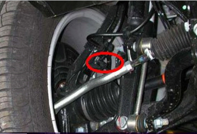

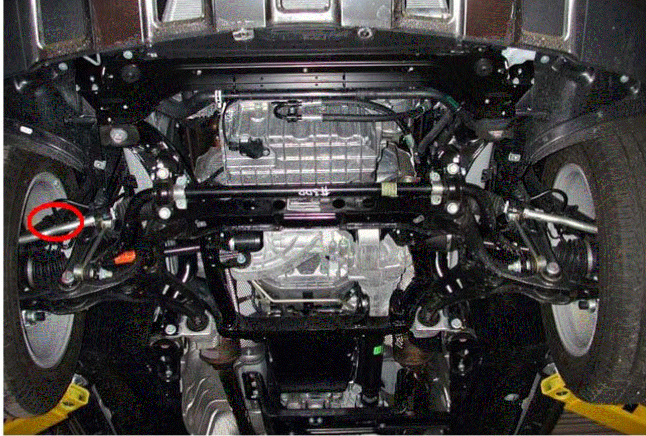

  • 110,194 POSTS
When you disconnected the original one, was it attached to the control arm assembly? Normally, they are attached and connected there. See the two pics I attached.
