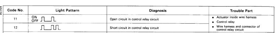

Wires going to and from relay are all good, the connectors are good. do i just replace the relay?
Dec 20, 2018 at 11:22 AM
  • 110,194 POSTS
If everything with the wiring and power supplies are good, the suspect the relay itself. I attached a picture of the code with possible causes. The 11 indicates an open in the circuit, so that means the power supply is broken at some point. With that, if there is power to the relay, then chances are the relay is bad.
