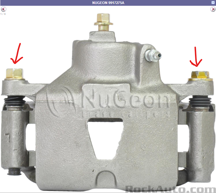

Check the slide pins on the caliper. This is where it may be sticking.
You can remove them and clean them as well as the hole they go into.

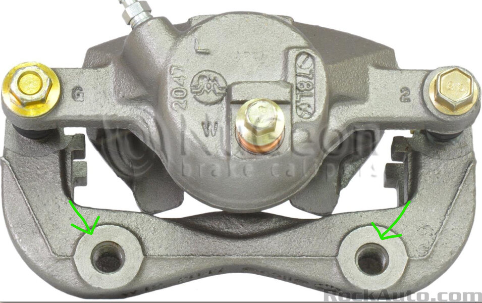

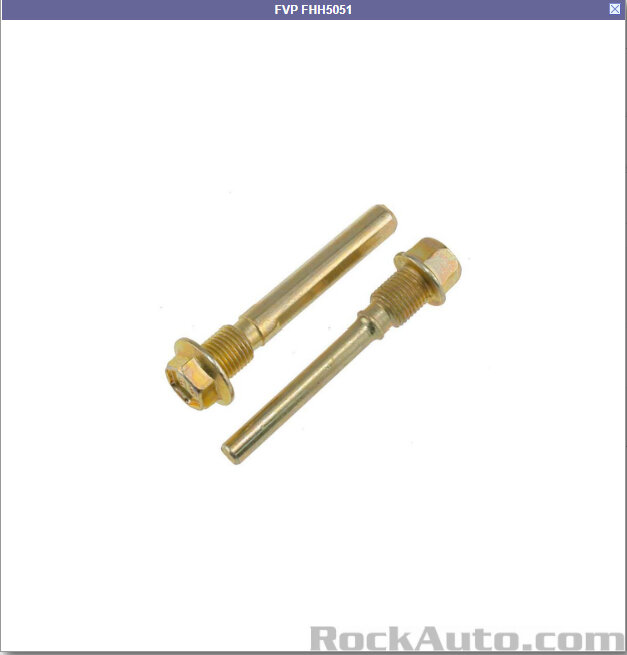

Remove the caliper from the bracket. (See image RED arrows). Those bolts are the slide pins. (See image). These pins look like they are different so take note of the position they come out of.
A lot of the times the grease that was once in there has long disappeared. So, the metal surfaces start to corrode, which makes them swell.
This keeps the caliper from being able to "float" back out of the way.
Hang the caliper up with a bungee cord to keep it from hanging from the brake hose and causing damage to the hose.
Remove the bracket from the steering knuckle (see image green arrows)

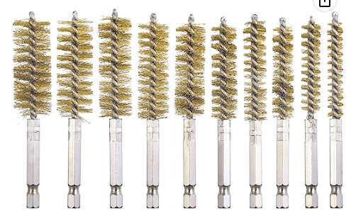

You will need Bore Brush and a drill. (See image)
Use this to clean the holes in the caliper bracket that the slides go into. Clean them well. Then spray some brake cleaner in there and clean it out.

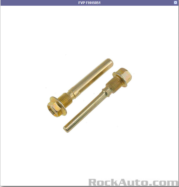

If the pins are too rusted, then you will have to get new ones. Your local auto parts store should be able to get them for you. They are fairly cheap.
Found these on RockAuto if you need them.:
https://www.rockauto.com/en/catalog/saturn,1995,sl+sedan,1.9l+l4+sohc,1266948,brake+&+wheel+hub,caliper+slide+pin,10281
