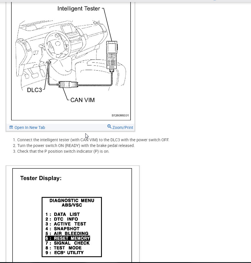

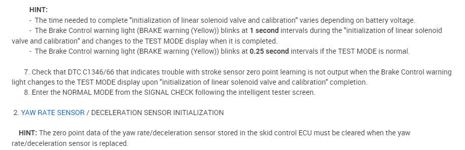

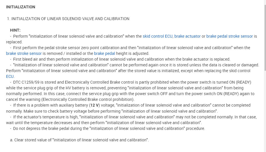

I replaced the ABS Module with a used one, however when I attempt to bleed the brakes I get air bleed fail. I am using Techstream software. This is the first time I have used the software, wanting to make sure I am not missing anything procedure wise. I feel as though the new used ABS pump is bad also. I do have ABS related codes.

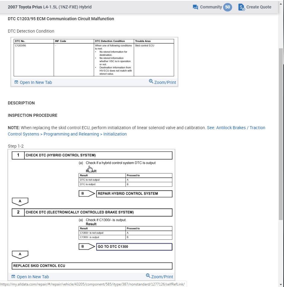

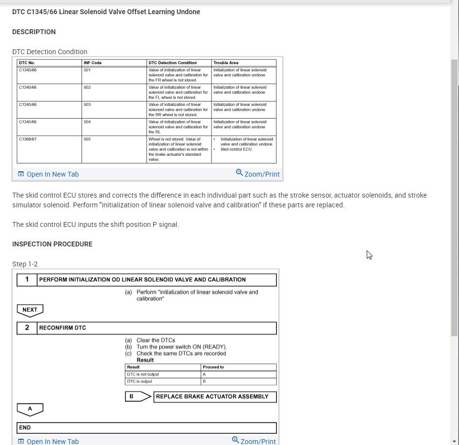

Codes are C1203, C1316, C1345, C1352, C1358, and C1359.
Jan 27, 2020 at 12:32 PM

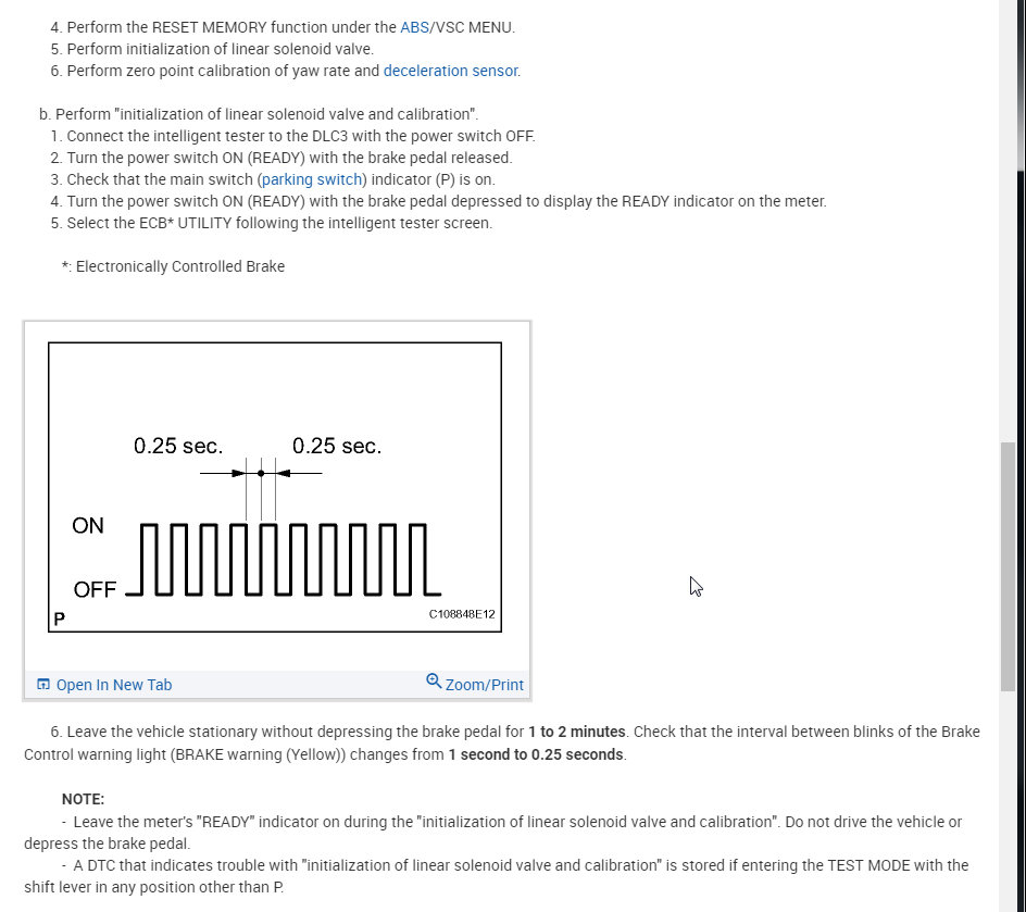

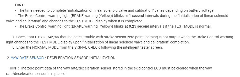

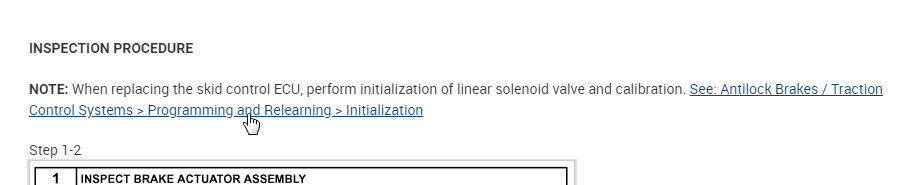

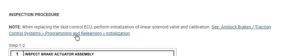

So I suspect I was correct with them being related to it not being initialized. I attached the detail to the first few codes and the C1203 is the only one that gives me pause. You may actually have an issue with the module not being initialized to this vehicle and it having an issue. I would run through the attached initialization process and then clear the codes and see if the C1203 returns.
Let me know if you have questions. Thanks
