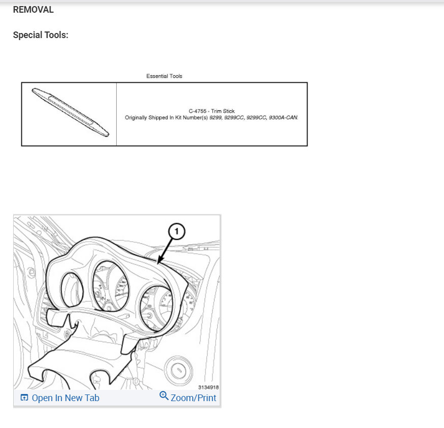

Yep, this happens when the instrument cluster goes out, but to be sure we should do a CAN scan, you can get a CAN scanner (Controller Area Network) which will work on most cars from Amazon.
https://youtu.be/u-4syLc-ifQ
and
Here is one for about $99.00 if you need it:
https://amzn.to/3ZixY4v

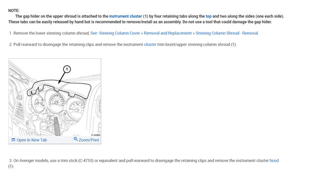

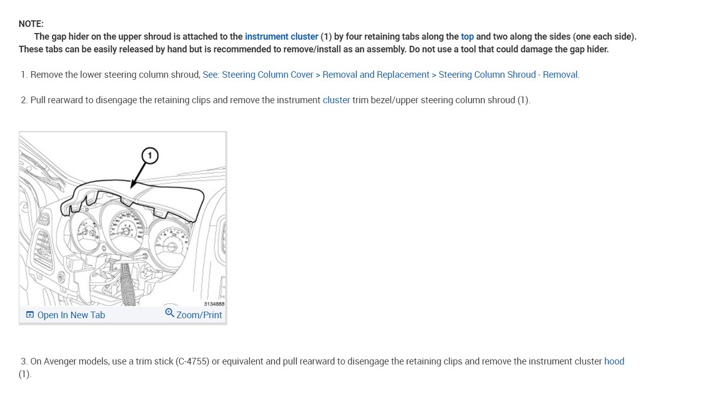

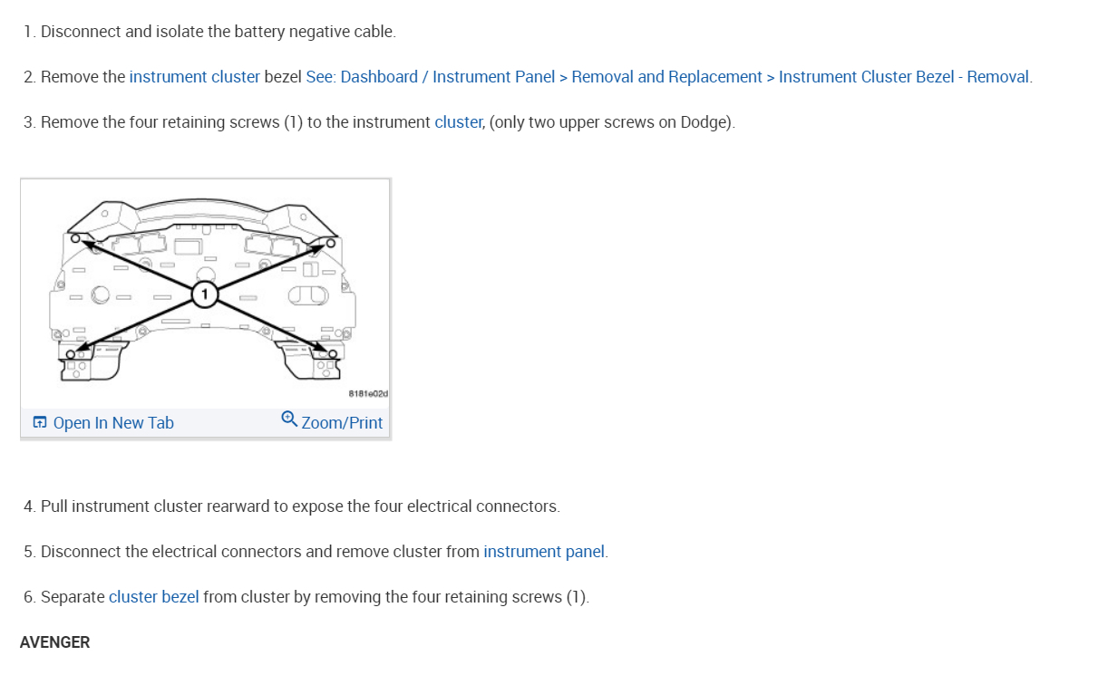

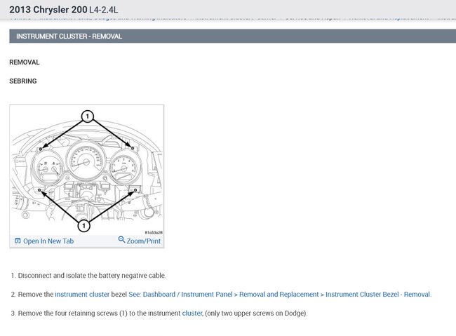

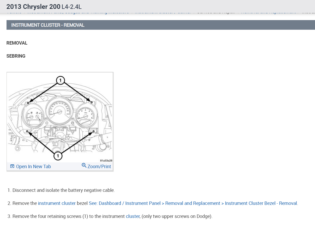

Here is how to replace the clusters in case you need it, and you can get a rebuilt cluster by searching google or eBay. Check out the images (below). Please let us know what happens.
