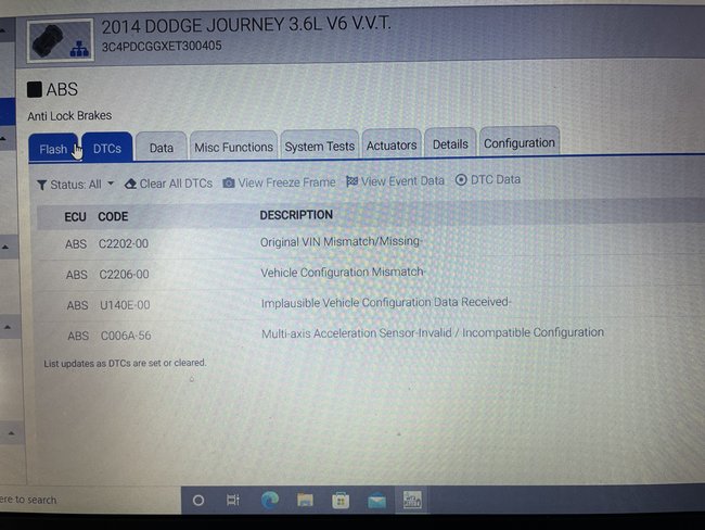

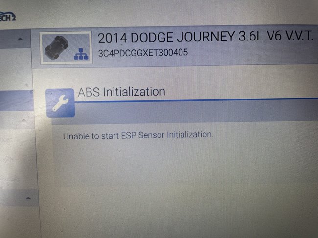

Hi, I recently replaced the ABS module on the vehicle listed above with OEM factory part from dealership. I have access to wiTech and am trying to initialize the module, but it will not start. I will attach two photos of the fault and trouble codes present due to the module not being initialized.

Good evening,
The codes are there because the VIN number is not entered into the module.
You need to install the VIN number before the initialization will start.

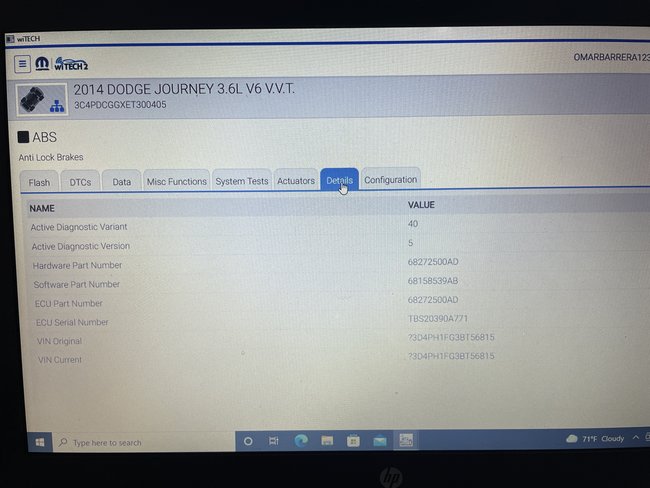

Here is the VIN in the ABS module in detail. It is not the correct VIN.
Dec 16, 2021 at 6:40 PM

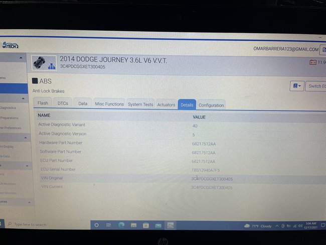

So that picture with the? Infront is the VIN with the new module installed which is incorrect. The picture below is the old module installed with the correct VIN number.
Dec 16, 2021 at 7:26 PM

And the old ABS module initializes perfectly. It just has an internal fault code present - reason for replacement.
Dec 16, 2021 at 7:29 PM
You are correct, it is a used module.
You need the factory scan tool to change the VIN number to your exact number. Once that is done, you will be able to set it up. There are some cases where you cannot change the VIN which means you need another module.
I would tell the dealer that they gave you a module with a number already in it. It should be blank and ready to add the VIN number.
