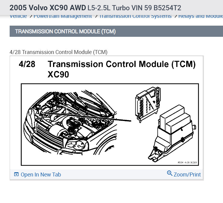

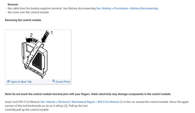

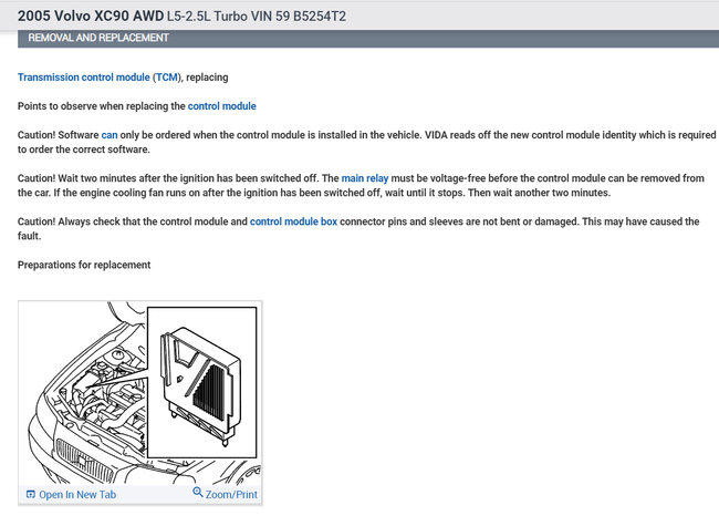

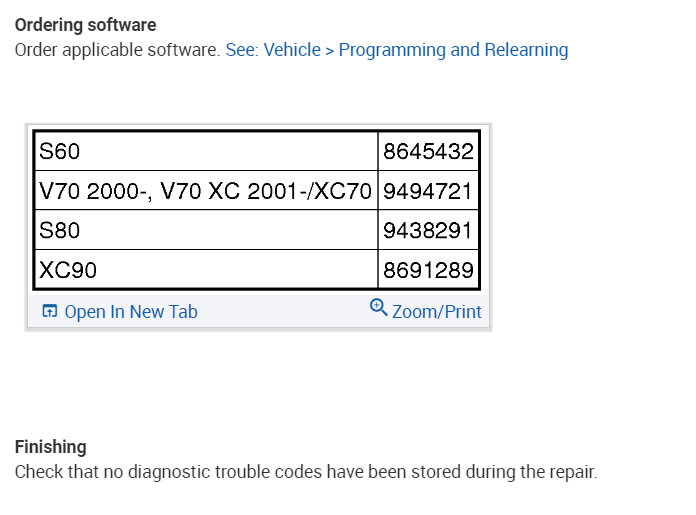

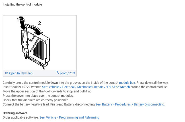

I would start with the p1799 code CAN TCM/ABS circuit malfunction which tells us the TCM is not working. please check all fuses and if okay, here is how to replace the TCM and its location in the images below. You can get a rebuilt unit by searching Google or Ebay. Also check the TCM wiring connector for corrosion. Check out the images (below). Please let us know what happens.
